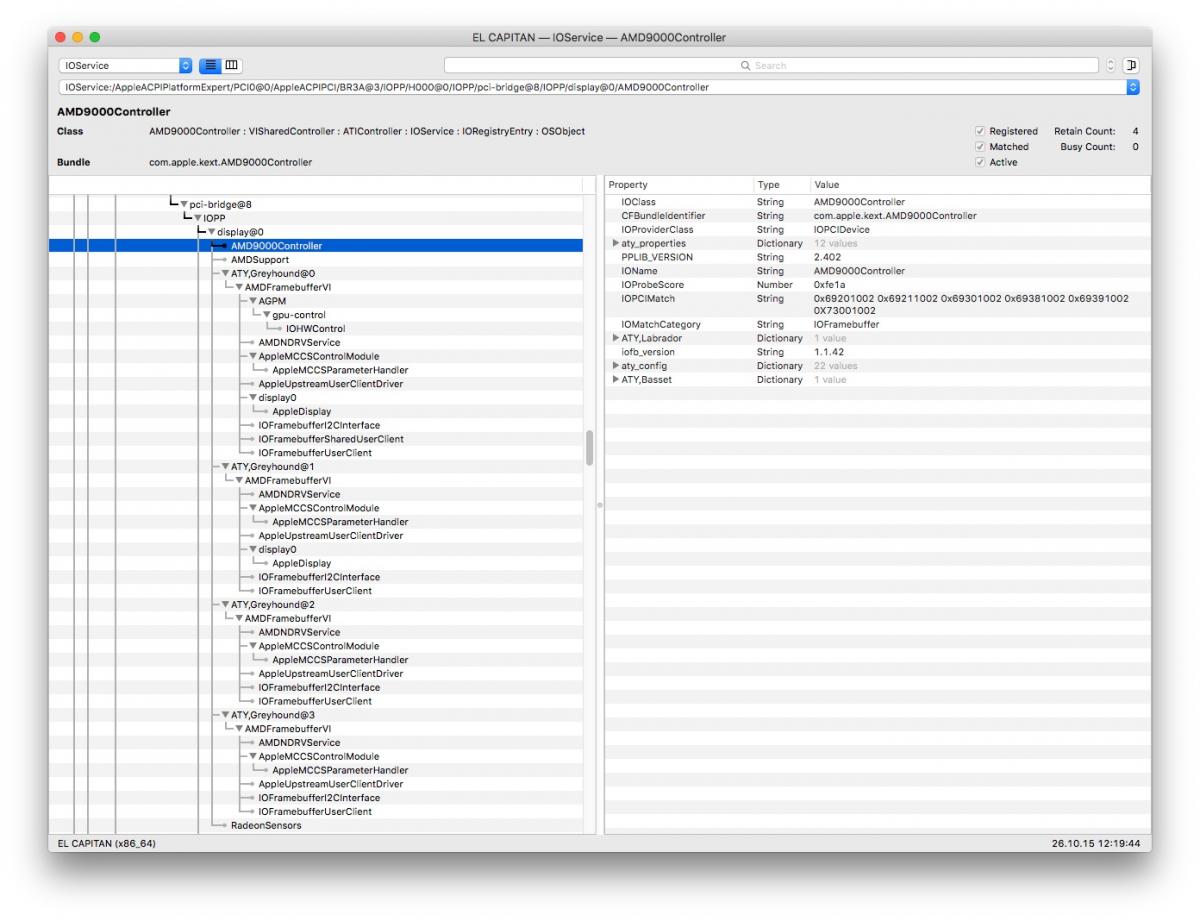

Vlada. Posted October 30, 2015 Author Share Posted October 30, 2015 Did anyone figure out blackout issue after wake from sleep under El Capitan? That’s the problem that troubling me lately. The anomaly is typical for AMD graphics which considers display blackout and there is no operational USB. And, hm... that USB anomaly is interesting. It’s pointing that the problem might be related to something else too, but not with graphics only. As far as I can see FB code is the same, so there are no changes in that part, but I was notice that sensor-properties line is removed by Apple in info.plist file inside the AMDRadeonX4000.kext under Capitan, so that could be something… However, I’m not sure about that, because some people reporting that they don’t have any problem!? Anyway, I didn’t manage to find proper solution for now, so any help or suggestion will be more than welcome! 1 Link to comment https://www.insanelymac.com/forum/topic/303186-how-to-modification-of-amd-fb-clover-injection/page/8/#findComment-2183608 Share on other sites More sharing options...

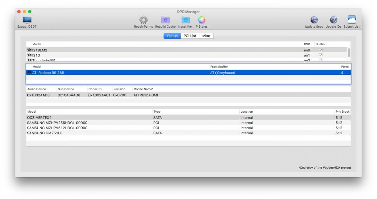

Ciro82 Posted November 4, 2015 Share Posted November 4, 2015 @Vlada I write here my experience with the HD 7970 (Reference). I had problems with this card, as in OSX 10.10 and 10.11 the FB was not loaded, "AMD Radeon FrameBuffer" loaded, instead of "Aji" (DSDT inject). Following a tip from @Pjalm (Thanks PJ) , i've modified the GFX card's firmware by adding "GOP" in it. After the FW flashing (with modified FW) and enabling "Super Fast Boot" on mobo's FW, the FB "Aji" is loaded correctly (I inject "Aji" through DSDT) in both 10.10 and 10.11. I hope that will be a solution for someone. 1 Link to comment https://www.insanelymac.com/forum/topic/303186-how-to-modification-of-amd-fb-clover-injection/page/8/#findComment-2185215 Share on other sites More sharing options...

giacomoleopardo Posted November 8, 2015 Share Posted November 8, 2015 @Vlada I write here my experience with the HD 7970 (Reference). I had problems with this card, as in OSX 10.10 and 10.11 the FB was not loaded, "AMD Radeon FrameBuffer" loaded, instead of "Aji" (DSDT inject). Following a tip from @Pjalm (Thanks PJ) , i've modified the GFX card's firmware by adding "GOP" in it. After the FW flashing (with modified FW) and enabling "Super Fast Boot" on mobo's FW, the FB "Aji" is loaded correctly (I inject "Aji" through DSDT) in both 10.10 and 10.11. I hope that will be a solution for someone. Would you mind to be more specific about the patching job? that's quite interesting. Thanks Link to comment https://www.insanelymac.com/forum/topic/303186-how-to-modification-of-amd-fb-clover-injection/page/8/#findComment-2186555 Share on other sites More sharing options...
Ciro82 Posted November 8, 2015 Share Posted November 8, 2015 Would you mind to be more specific about the patching job? that's quite interesting. Thanks Download this: https://www.dropbox.com/s/5bphx05ma8z9n13/AMD-UEFI-GOP-MAKER.zip ; Extract AMD card's Vbios with DPCImanager, rename it to "original.rom"; Put the .rom file into AMD-UEFI-GOP-MAKER folder; Run "UEFI_ROM.command" and after that you will find a new .rom file named "uefi.rom"; Run ATIWinFlash on Windows OS, following this guide: http://www.overclock.net/t/1353325/tutorial-atiwinflash-how-to-flash-the-bios-of-your-ati-cards. Credits to: @STLVNUB 1 Link to comment https://www.insanelymac.com/forum/topic/303186-how-to-modification-of-amd-fb-clover-injection/page/8/#findComment-2186570 Share on other sites More sharing options...
