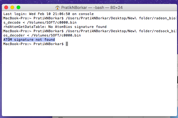

Dec_Bra1n Posted February 10, 2016 Share Posted February 10, 2016 Hello everyone since 3 days i am trying to get the connector information, I have Intel +AMD switchable Laptop intel hd 3000 + AMD 6770M well i have successfully extracted the rom using this article http://www.hackintoshmumbai.com/extract-gpu-rom-from-windows-amd-only/ i use this method because i am not able to get info when i dump the rom using Clover+F6 i have try decode the rom using that decoder which Vlada provides but i got this but nothing anything Help me get ConnectorInfo guys ..... c0000.bin.zip 1002_6740.rom.zip Link to comment https://www.insanelymac.com/forum/topic/303186-how-to-modification-of-amd-fb-clover-injection/page/10/#findComment-2214695 Share on other sites More sharing options...
