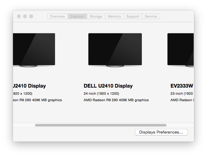

jura_11 Posted August 22, 2015 Share Posted August 22, 2015 Hi guys Finally I can enjoy multi monitor support on my R9 290 TRI-X,one monitor is connected through HDMI and second through the Displayport,DVI not working,but strange is when I plug to top DVI port,PC will lock up,in bottom will work without the issue(no lock up,but black screen) My connection looks like this: Dell U2410 is connected through the HDMI(HDMI port on R9) and DVI(bottom port on R9),Eizo EV2333W is connected through the Displayport,tried to run only HDMI and Displayport and on Eizo I've got black screen,nothing more,is strange,but at least is working for me Hope this helps Thanks,Jura Link to comment https://www.insanelymac.com/forum/topic/303186-how-to-modification-of-amd-fb-clover-injection/page/6/#findComment-2162472 Share on other sites More sharing options...

jura_11 Posted August 23, 2015 Share Posted August 23, 2015 Ok I've found how to connect second monitor,tried to connect on boot up,black screen on all ports,then in OSX tried same,black screen on all ports,then I've tried with Screensaver turned(plugged DP and DVI when Screensaver run) on and HDMI and DP is working as multi monitor My GPU is Sapphire R9 290 TRI-X OC,fake ID: 0x67B11002,FB: Baladi and Connector patches are from here,which are works pretty much great ATI Connectors Data: 000400000403000000010300120403030004000004030000000101001102010100040000040300000001020021030202000400000403000000010400220504040004000004030000000105001000050500040000040300000001060020010606 ATI Connectors Patch: 000800000402000000010200220502030004000004030000000101011204010100040000040300000001020021030202040000001402000000010300110203040004000004030000000105001000050500020000040200000001040110000406 Here is the picture of the setup Hope this helps someone too have multi monitor setup on their R9 290 Thanks,Jura 1 Link to comment https://www.insanelymac.com/forum/topic/303186-how-to-modification-of-amd-fb-clover-injection/page/6/#findComment-2162833 Share on other sites More sharing options...
