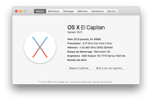

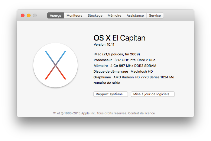

polyzargone Posted September 14, 2015 Share Posted September 14, 2015 Can someone post FB list for 10.11 GM (15A282a) please ? ati-personality.pl.0.15 doesn't work with the last OS X and my previous FB patch for my Sapphire AMD Radeon HD 7770 1 Gb doesn't work anymore . Video outputs for Sapphire AMD Radeon HD 7770 1 Gb DVI-I/HDMI/DP/DP 0000000 00 04 00 00 04 03 00 00 00 01 00 00 12 04 01 02 0000010 00 04 00 00 04 02 00 00 00 01 00 00 22 05 02 05 0000020 00 08 00 00 00 02 00 00 00 01 00 00 11 02 03 01 0000030 04 00 00 00 14 02 00 00 00 01 00 00 10 00 04 04 Personality: Futomaki ConnectorInfo count in decimal: 4 Disk offset in decimal 1690320 0000000 00 04 00 00 04 03 00 00 00 01 01 01 12 04 04 01 0000010 00 04 00 00 04 03 00 00 00 01 02 01 22 05 05 02 0000020 04 00 00 00 14 02 00 00 00 01 03 00 00 00 06 06 0000030 00 08 00 00 04 02 00 00 00 01 04 00 11 02 01 03 0000040 original 00040000040300000001010112040401000400000403000000010201220505020400000014020000000103000000060600080000040200000001040011020103 patch 00040000040300000001000012040102000400000402000000010000220502050008000000020000000100001102030104000000140200000001000010000404 Link to comment https://www.insanelymac.com/forum/topic/303186-how-to-modification-of-amd-fb-clover-injection/page/7/#findComment-2167997 Share on other sites More sharing options...
Pavo Posted September 15, 2015 Share Posted September 15, 2015 Here you go, also I have attached a php script that does the same thing that ati-personality.pl.0.15 does, just open terminal and type php and then drag and drop the php script in and hit enter: -------------------------AMD2400Controller.kext------------------------- Iago (2) @ 0xa0b60 LVDS, ???? 02000000400000000900000000010012 0010000016000000c400000010000111 -------------------------AMD2600Controller.kext------------------------- Hypoprion (2) @ 0xa0b40 LVDS, ???? 02000000400000000900000000010012 0010000016000000c400000010000111 Lamna (2) @ 0xa0b60 SDVI, DDVI 00020000140000008000000000010211 04000000160000008000000000100112 -------------------------AMD3800Controller.kext------------------------- Megalodon (3) @ 0xa1b30 SDVI, DDVI, SVIDEO 00020000140000000000000000010211 04000000160000000000000000100112 80000000020000000400000000100000 Triakis (2) @ 0xa1b60 SDVI, DDVI 00020000140000000000000000010211 04000000160000000000000000100112 -------------------------AMD4600Controller.kext------------------------- Flicker (3) @ 0x9eaf0 DP, DP, SDVI 00040000000400000001000002010305 00040000000400000001000001000202 00020000140200000001000000100104 Gliff (3) @ 0x9eb20 LVDS, LVDS, DP 02000000400000000901000002010003 02000000000100000901000020010202 00040000040600000001000010000101 Shrike (3) @ 0x9eb50 LVDS, LVDS, DP 02000000400000000901000002010003 02000000000100000901000020010202 00040000040300000001000010000101 -------------------------AMD4800Controller.kext------------------------- Cardinal (2) @ 0x9db00 SDVI, DDVI 00020000140200000001000001010104 04000000140200000001000000100203 MotMot (2) @ 0x9db20 DP, DDVI 00040000040100000001000010000203 04000000140200000001000001110104 Quail (3) @ 0x9db40 LVDS, LVDS, DP 02000000400000000901000022010007 02000000000100000901000020010304 00040000040300000001000010000203 -------------------------AMD5000Controller.kext------------------------- Douc (2) @ 0x1bf8d0 LVDS, DP 02000000000500000903000021030202 00040000040200000003000011020101 Langur (3) @ 0x1bf8f0 DP, DP, DDVI 00040000040600000001000021030402 00040000040600000001000011020101 04000000140200000001000002040503 Uakari (4) @ 0x1bf920 DP, DDVI, SDVI, HDMI 00040000000400000071000012040401 04000000140000000071000001120103 00020000140000000071000000000605 00080000000200000071000022050504 Zonalis (6) @ 0x1bf960 DP, DP, DP, DP, DP, DP 00040000040600000071000020010606 00040000040600000071000010000505 00040000040600000071000021030204 00040000040600000071000011020103 00040000040600000071000022050402 00040000040600000071000012040301 Alouatta (4) @ 0x1bf9c0 LVDS, DP, DP, DP 02000000000100000901000012040303 00040000040600000071000011020101 00040000040600000071000021030202 00040000040600000071000022050404 Hoolock (3) @ 0x1bfa00 DP, DP, DDVI 00040000040600000001000021030501 00040000040600000001000011020402 04000000140200000001000002040103 Vervet (4) @ 0x1bfa30 DP, DDVI, SDVI, HDMI 00040000000400000071000012040402 04000000140000000071000001120104 00020000140000000071000000000603 00080000000200000071000022050501 Baboon (3) @ 0x1bfa70 DDVI, HDMI, VGA 04000000140000000001000001020103 00080000000200000071000022050201 10000000100000000001000000100002 Eulemur (3) @ 0x1bfaa0 DDVI, HDMI, VGA 04000000140000000001000001020104 00080000000200000071000012040402 10000000100000000000000000100001 Galago (2) @ 0x1bfae0 LVDS, DP 02000000000100000903000021030202 00040000040600000073000011020101 Colobus (2) @ 0x1bfb10 LVDS, DP 02000000000100000903000021030202 00040000040600000073000011020101 Mangabey (2) @ 0x1bfb40 LVDS, DP 02000000400000000901000000000003 00040000040600000073000011020101 Nomascus (4) @ 0x1bfb70 LVDS, LVDS, DP, DP 02000000400000000901000000000005 02000000000100000903000012040303 00040000040600000073000011020101 00040000040700000073000021030202 Orangutan (2) @ 0x1bfbc0 LVDS, DP 02000000400000000901000000000005 00040000040600000073000011020101 -------------------------AMD6000Controller.kext------------------------- Pithecia (2) @ 0x1c4de0 DP, DDVI 00040000040300000001000021030204 04000000140200000001000000000403 Bulrushes (6) @ 0x1c4e00 DP, DP, DP, DP, DP, DP 00040000040300000001000011020101 00040000040300000001000021030202 00040000040300000001000012040303 00040000040300000001000022050404 00040000040300000001000010000505 00040000040300000001000020010606 Cattail (4) @ 0x1c4e60 LVDS, DP, DP, DP 02000000400000002905000000000005 00040000040300000001000011020101 00040000000100000009100021030202 00040000000100000009100012040303 Hydrilla (5) @ 0x1c4ea0 LVDS, DP, DP, DP, DP 02000000000100000901000012040303 00040000040300000001000011020101 00040000000100000009100021030202 00040000000100000009100022050504 00040000040300000001000010000405 Duckweed (4) @ 0x1c4ef0 DP, DP, HDMI, SDVI 00040000040300000001000012040401 00040000040300000001000022050502 00080000040200000001000011020304 00020000140200000001000000000605 Fanwort (4) @ 0x1c4f30 LVDS, DP, DP, DP 02000000400000002905000000000004 00040000040300000001000011020101 00040000000100000009100021030202 00040000000100000009100012040303 Elodea (5) @ 0x1c4f70 LVDS, DP, DP, DP, DP 02000000000100000901000012040303 00040000040300000001000010000505 00040000040300000001000011020101 00040000000100000009100021030202 00040000000100000009100022050404 Kudzu (2) @ 0x1c4fc0 DP, HDMI 00040000040300000001000012040303 00080000040200000001000011020101 Gibba (5) @ 0x1c4fe0 DP, DP, HDMI, SDVI, DDVI 00040000040300000001000012040501 00040000040300000001000022050402 00080000040200000001000011020604 00020000140200000001000000000305 04000000040200000001000011020103 Lotus (3) @ 0x1c5030 DP, HDMI, DP 00040000040300000001000011020101 00080000040200000001000022050404 00040000000100000001000021030202 Ipomoea (3) @ 0x1c5060 DP, HDMI, VGA 00040000040300000001000012040105 00080000040200000001000011020403 10000000100000000001000000000002 Muskgrass (4) @ 0x1c5090 DP, DP, DP, HDMI 00040000040300000001010011020101 00040000000100000009120021030202 00040000000100000009130022050404 00080000040200000001040012040303 Juncus (4) @ 0x1c50d0 DP, DP, DP, DP 00040000040300000001000012040303 00040000040300000001000010000405 00040000040300000001000011020101 00040000040300000001000021030202 Osmunda (4) @ 0x1c5110 LVDS, DP, DP, HDMI 02000000000100002905010010000505 00040000040300000009020011020101 00040000040300000009030021030202 00080000040200000001040012040303 Pondweed (3) @ 0x1c5150 LVDS, DP, DP 02000000000100000901010010000505 00040000040300000001020011020101 00040000040300000001030021030202 Spikerush (4) @ 0x1c5180 LVDS, DP, DP, DP 02000000400000002905010000000005 00040000040300000001020011020101 00040000000100000009020021030202 00040000000100000009030012040303 Typha (5) @ 0x1c51c0 DP, DP, DP, DP, DDVI 00040000040300000001010011020401 00040000040300000001020021030502 00040000000100000009030010000205 00040000000100000009040020010306 04000000140200000001050002040103 -------------------------AMD7000Controller.kext------------------------- Ramen (6) @ 0x1cc220 LVDS, HDMI, DP, DP, DP, DP 02000000000100002905011020010506 00080000040200000001020010000305 00040000040300000001030711020101 00040000000100000001040321030403 00040000040300000001050712040202 00040000000100000001060322050403 Tako (6) @ 0x1cc2f0 LVDS, LVDS, DP, DP, DP, DP 02000000000100000001010322050204 02000000000100000001020312040103 00040000040300000001030711020301 00040000000100000001040321030505 00040000040300000001050710000402 00040000000100000001060320010505 Namako (4) @ 0x1cc350 LVDS, LVDS, DP, DP 02000000000100000001010322050202 02000000000100000001020312040101 00040000040300000001030711020303 00040000040300000001040721030404 Aji (4) @ 0x1cc3f0 DP, DP, DDVI, HDMI 00040000040300000001010112040501 00040000040300000001020122050402 04000000140200000001030000000306 00080000040200000001040011020104 Buri (4) @ 0x1cc430 LVDS, DP, DP, HDMI 02000000000100002905010010000505 00040000040300000009020011020101 00040000040300000009030021030202 00080000040200000001040012040303 Chutoro (5) @ 0x1cc470 LVDS, DP, DP, DP, DP 02000000000100000901010012040303 00040000040300000001020111020101 00040000000100000009030021030202 00040000000100000009040022050404 00040000040300000001050010000505 Dashimaki (4) @ 0x1cc4c0 DP, DP, DDVI, HDMI 00040000040300000001010112040202 00040000040300000001020022050305 04000000140200000001030100000404 00080000040200000001040011020101 Ebi (5) @ 0x1cc500 LVDS, DP, DP, DP, DP 02000000000100000901010012040303 00040000040300000001020111020101 00040000000100000009030121030202 00040000000100000009040122050404 00040000040300000001050110000505 Gari (5) @ 0x1cc550 LVDS, DP, DP, DP, DP 02000000000100000901010012040303 00040000040300000001020111020101 00040000000100000009030021030202 00040000000100000009040022050404 00040000040300000001050010000505 Futomaki (4) @ 0x1cc5d0 DP, DP, DDVI, HDMI 00040000040300000001010112040401 00040000040300000001020122050502 04000000140200000001030000000606 00080000040200000001040011020103 Hamachi (4) @ 0x1cc610 DP, DP, DDVI, HDMI 00040000040300000001010112040501 00040000040300000001020122050402 04000000140200000001030000000306 00080000040200000001040011020104 OPM (6) @ 0x1cc690 DP, DP, DP, DP, DP, DP 00040000040300000001000111020101 00040000040300000001000121030202 00040000040300000001000112040303 00040000040300000001000122050404 00040000040300000001000110000505 00040000140300000001000120010606 Ikura (1) @ 0x1cc6f0 HDMI 00080000040200000001010012040301 IkuraS (6) @ 0x1cc700 DP, DP, DP, DP, DP, DP 00040000040300000001010711020103 00040000040300000001020721030204 00040000040300000001030712040301 00040000040300000001040722050402 00040000040300000001050710000505 00040000040300000001060720010606 Junsai (6) @ 0x1cc760 DP, DP, DP, DP, DP, DP 00040000040300000001000112040301 00040000040300000001000122050402 00040000040300000001000111020103 00040000040300000001000121030204 00040000040300000001000110000505 00040000040300000001000120010606 Kani (1) @ 0x1cc7c0 HDMI 00080000040200000001010012040301 KaniS (6) @ 0x1cc7d0 DP, DP, DP, DP, DP, DP 00040000040300000001010711020103 00040000040300000001020721030204 00040000040300000001030712040301 00040000040300000001040722050402 00040000040300000001050710000505 00040000040300000001060720010606 DashimakiS (4) @ 0x1cc830 DP, DP, DDVI, HDMI 00040000040300000001010112040202 00040000040300000001020122050305 04000000140200000001030000000404 00080000040200000001040011020101 Maguro (1) @ 0x1cc870 HDMI 00080000040200000001010012040301 MaguroS (6) @ 0x1cc880 DP, DP, DP, DP, DP, DP 00040000040300000001010711020103 00040000040300000001020721030204 00040000040300000001030712040301 00040000040300000001040722050402 00040000040300000001050710000505 00040000040300000001060720010606 -------------------------AMD8000Controller.kext------------------------- Exmoor (6) @ 0x1c5f20 LVDS, LVDS, DP, DP, DP, DP 02000000000100000001010322050204 02000000000100000001020312040103 00040000040300000001030711020301 00040000000100000001040321030505 00040000040300000001050710000402 00040000000100000001060320010505 Baladi (6) @ 0x1c6080 DP, DP, DP, DP, DP, DP 00040000040300000001030012040303 00040000040300000001010011020101 00040000040300000001020021030202 00040000040300000001040022050404 00040000040300000001050010000505 00040000040300000001060020010606 -------------------------AMD9000Controller.kext------------------------- Exmoor (6) @ 0x1c3c50 LVDS, LVDS, DP, DP, DP, DP 02000000000100000001010322050204 02000000000100000001020312040103 00040000040300000001030711020301 00040000000100000001040321030505 00040000040300000001050710000402 00040000000100000001060320010505 OPM (6) @ 0x1c3cb0 DP, DP, DP, DP, DP, DP 00040000040300000000000110000101 00040000040300000000000120010202 00040000040300000000000111020303 00040000040300000000000121030404 00040000040300000000000112040505 00040000040300000000000122050606 GreyhoundS (1) @ 0x1c3d10 HDMI 00080000040200000001010012040301 Labrador (6) @ 0x1c3db0 LVDS, LVDS, DP, DP, DP, DP 02000000000100000001010321030204 02000000000100000001020311020103 00040000040300000001030710000301 00040000000100000001040320010505 00040000040300000001050712040402 00040000000100000001060322050505 Basset (4) @ 0x1c3e10 LVDS, LVDS, DP, DP 02000000000100000001010321030202 02000000000100000001020311020101 00040000040300000001030710000303 00040000040300000001040720010404 Greyhound (6) @ 0x1c3ed0 DP, DP, DP, DP, DP, DP 00040000040300000001010710000103 00040000040300000001020720010204 00040000040300000001030711020301 00040000040300000001040721030402 00040000040300000001050712040505 00040000040300000001060722050606 Baladi (6) @ 0x1c3f50 DP, DP, DP, DP, DP, DP 00040000040300000001030012040303 00040000040300000001010011020101 00040000040300000001020021030202 00040000040300000001040022050404 00040000040300000001050010000505 00040000040300000001060020010606 ATI_FrameBuffers.php.zip 2 Link to comment https://www.insanelymac.com/forum/topic/303186-how-to-modification-of-amd-fb-clover-injection/page/7/#findComment-2168001 Share on other sites More sharing options...

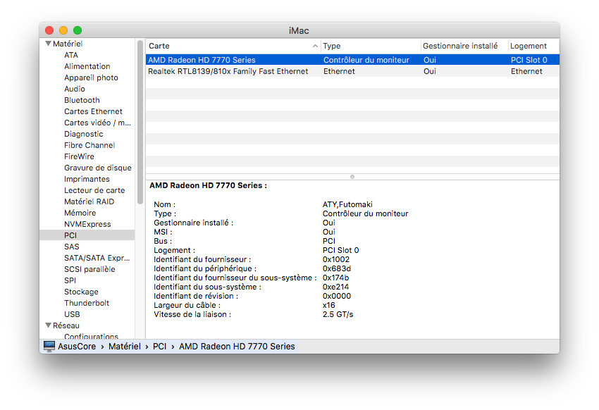

polyzargone Posted September 15, 2015 Share Posted September 15, 2015 Thanks ! Surprisingly, I just removed Futomaki FB Name in Clover's config.plist and it now works perfect ! Anyway, I guess this will be helpful for the others . Here you go, also I have attached a php script that does the same thing that ati-personality.pl.0.15 does, just open terminal and type php and then drag and drop the php script in and hit enter Thanks too for that ! I was looking for such a tool ! Link to comment https://www.insanelymac.com/forum/topic/303186-how-to-modification-of-amd-fb-clover-injection/page/7/#findComment-2168003 Share on other sites More sharing options...
polyzargone Posted September 15, 2015 Share Posted September 15, 2015 Surprisingly, I just removed Futomaki FB Name in Clover's config.plist and it now works perfect ! [EDIT] Forget it. The problem occurred only when updating via "OS X Install app" method. Once done, with FB name back in Clover, the patch works… randomly . Seems like I need to make another one based on new FB values. Damn. I just realized reading the new values that they are the same . So it's a problem with the new AMD kexts I guess… Let's wait the final release then. Link to comment https://www.insanelymac.com/forum/topic/303186-how-to-modification-of-amd-fb-clover-injection/page/7/#findComment-2168010 Share on other sites More sharing options...
