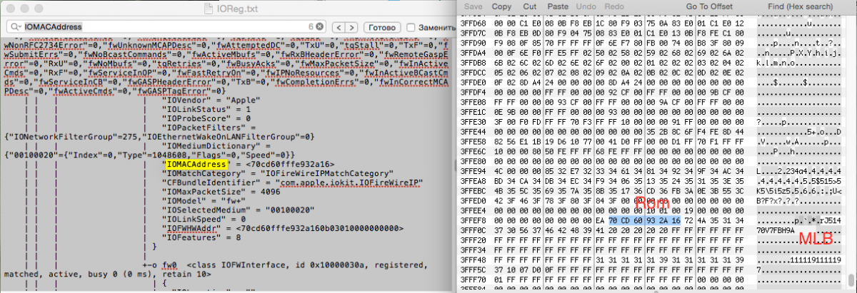

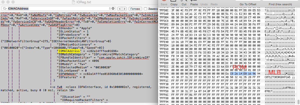

tyufhl Posted December 8, 2014 Share Posted December 8, 2014 Could you point me to Apple MAC database. I think I got MLB figured out with this post help. Edited: I think I found it. The 2nd half of the MAC address is random, even the 02? Can not accidentally? this is from MacMini5,1 . this is from MacPro5,1. 1 Link to comment https://www.insanelymac.com/forum/topic/303073-pattern-of-mlb-main-logic-board/page/4/#findComment-2093259 Share on other sites More sharing options...
johnap987 Posted December 8, 2014 Share Posted December 8, 2014 Can not accidentally? this is from MacMini5,1Снимок экрана 2014-12-08 в 9.40.16 PM.png . this is from MacPro5,1Снимок экрана 2014-12-08 в 9.29.39 PM.png. One quick question. Should I just check if ROM is register to Apple, or there´s a lot more behind the ROM value. My hack doesn´t show firewire in the hardware profile, I´ve been using ethernet mac address. Was planning to use one registered with apple (Clover RT values). Link to comment https://www.insanelymac.com/forum/topic/303073-pattern-of-mlb-main-logic-board/page/4/#findComment-2093291 Share on other sites More sharing options...
pkdesign Posted December 8, 2014 Share Posted December 8, 2014 Can not accidentally? this is from MacMini5,1Снимок экрана 2014-12-08 в 9.40.16 PM.png . this is from MacPro5,1Снимок экрана 2014-12-08 в 9.29.39 PM.png. What app are you using to read the ioreg file? Link to comment https://www.insanelymac.com/forum/topic/303073-pattern-of-mlb-main-logic-board/page/4/#findComment-2093296 Share on other sites More sharing options...

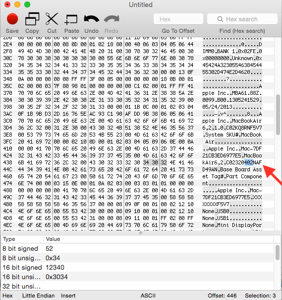

tyufhl Posted December 9, 2014 Share Posted December 9, 2014 LG is the second half of 2013 and week 40: Production week: 1 - 27 1 2 3 4 5 6 7 8 9 C D F G H J K L M N P Q R T V W X Y Production week: 28 - 52 1 2 3 4 5 6 7 8 9 C D F G H J K L M N P Q R T V W MLB=PPP Y WW TTT xx EEEE xx PPP=production plant (location) Y = Year WW = Week TTT = Board type (examples below) EEEE = EEE Code (examples below) EEE Code examples Mac mini (Mid 2011) 661-6032 Logic Board, 2.3GHz, Dual-Core - Mac mini Mid 2011, A1347, EEE Code: DKP2 661-6033 Logic Board, 2.5GHz, Dual-Core - Mac mini Mid 2011, A1347, EEE Code: DK22 661-6034 Logic Board, 2.0GHz, Quad-Core - Mac Mini Server Mid 2011, A1347, EEE Code: DHDN 661-6063 Logic Board, 2.7GHz, Dual-Core - Mac mini Mid 2011, A1347, EEE Code: DN77 Mac mini (Late 2012) 661-7017 Logic Board, Dual-Core, 2.5 GHz A1347, EEE Code: DVF8,F1HC 661-7018 Logic Board, Quad-Core, 2.3 GHz A1347, EEE Code: DVF9,F1H8 661-7019 Logic Board, Quad-Core, 2.6 GHz A1347, EEE Code: F1G2,F1H9 MacBook Air (Mid 2013) 661-7476 Logic Board, 1.3GHZ,HSW,TURBO,4GB,13 MBA A1466, EEE Code: FD47,FD49 661-7477 Logic Board, 1.3GHZ,HSW,TURBO,8GB,13 MBA A1466, EEE Code: FD48,FD4C 661-7478 Logic Board, 1.7GHZ,HSW,TURBO,4GB,13 MBA A1466, EEE Code: FHDQ,FHDV 661-7479 Logic Board, 1.7GHZ,HSW,TURBO,8GB,13 MBA A1466, EEE Code: FHDT,FHDW iMac (27-inch Late 2013) 661-7516 Logic Board, 3.2GHZ,I5 QC,GK107EGX,1GB,27" IMAC A1419, EEE Code: F8YL,FCTC 661-7517 Logic Board, 3.4GHZ,I5 QC,GK104GX,2GB,27" IMAC A1419, EEE Code: FC3F,FC3J 661-7518 Logic Board, 3.4GHZ,I5 QC,GK104GX,4GB,27" IMAC A1419, EEE Code: FN7H 661-8123 Logic Board, 3.5GHZ,I7 QC,GK104GX,2GB,27" IMAC A1419, EEE Code: FN71,FN72 661-8124 Logic Board, 3.5GHZ,I7 QC,GK104GX,4GB,27" IMAC A1419, EEE Code: FN3W iMac (27-inch Mid 2014) 661-00147 Logic Board, 1.4GHz, i5, 8GB, HDD A1418, EEE Code: G36D,G36G 661-00148 Logic Board, 1.4GHz, i5, 8GB, SSD A1418, EEE Code: FT57,FT5F Board type examples 604= iMac14,1 602 = iMac14,2 500 = MacPro6,1 600 = MacBookAir6,1 607 = MacBookAir6,2 700 = MacBookPro11,2 MacPro6,1 examples F5 K3 47 400 2X FNN2 1A = CPU (Riser card) F5K 3 48 200 01 FD6P 1D = IO F5K 3 48 200 3Q FNNC 13 = GFXA F5K 3 47 200 J5 FNNJ 18 = GFXB Pike R. Alpha, TTT MacBookAir6,2 607 . is there 402 ??? Link to comment https://www.insanelymac.com/forum/topic/303073-pattern-of-mlb-main-logic-board/page/4/#findComment-2093601 Share on other sites More sharing options...
Pike R. Alpha Posted December 9, 2014 Share Posted December 9, 2014 Pike R. Alpha, TTT MacBookAir6,2 607 . is there 402Снимок экрана 2014-12-09 в 10.04.26 PM.png ??? Obviously, yes, since you found one. Don't forget. My data are mere examples. This is what I collected in a short while, but I don't have everything sorted out and well documented. That is why we are all here for isn't it 1 Link to comment https://www.insanelymac.com/forum/topic/303073-pattern-of-mlb-main-logic-board/page/4/#findComment-2093608 Share on other sites More sharing options...
