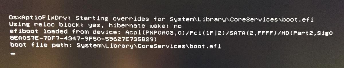

jackfoley Posted November 3, 2014 Share Posted November 3, 2014 Hi all, I'm having a different (and most likely noob-ish) problem on my side. I managed to get Yosemite installed on my 5960X, X99 Deluxe w/GTX 980 SLI. I used the USB Boot from the other guys, patched kernel, and Stinga11's Kext Pack (life-saver!) and installed on a separate SSD (I have one for OSX and one for Windows). I had a funny problem where I kept getting a black screen post-install until I plugged in an old DVI monitor (running a 4K Samsung off of DP). I also installed the NVIDIA Web Drivers for the GTX 980. I can boot into OS X from the USB, have WiFI internet, LAN seems to work but dies if I try speedtest.net to check (upload doesn't work, then the whole LAN adapter seems to not work), USB3, no sound. I can reboot (takes about 5 seconds to restart) and it wakes from sleep but my keyboard/mouse don't seem to respond (I was able to screenshare and use them via my MacBookPro). I have access to App Store and iCloud. I installed Clover and ran the configurator. Set up SMBIOS to MacPro 6,1, set up boot args (npci=0x2000 kext-dev-mode=1 nvda_drv=1). When I boot from Clover, it seems to get stuck after the Clover boot screen (when choosing Macintosh HD) on "efiboot loaded from device: apci(bunch of stuff) boot file path: System\Library\CoreServices\boot.efi" and sits there indefinitely. Thoughts? Thanks in advance.EDIT / UPDATE: Have been able to get sound / USB3 / LAN (mostly) working - was just a matter of clearing cache / repairing permissions before reboot. Sound required both the HDAEnabler.kext, AppleHDA.kext (both Stinga11) and Toleda's audio patch). Now just need to figure out how to get off of the USB key boot. 1 Link to comment https://www.insanelymac.com/forum/topic/301585-haswell-e-mach_kernel-patch-5960x-5830k-and-5820k-1010-10101-yosemite/page/11/#findComment-2080790 Share on other sites More sharing options...
jamiethemorris Posted November 4, 2014 Share Posted November 4, 2014 Hi all, I'm having a different (and most likely noob-ish) problem on my side. I managed to get Yosemite installed on my 5960X, X99 Deluxe w/GTX 980 SLI. I used the USB Boot from the other guys, patched kernel, and Stinga11's Kext Pack (life-saver!) and installed on a separate SSD (I have one for OSX and one for Windows). I had a funny problem where I kept getting a black screen post-install until I plugged in an old DVI monitor (running a 4K Samsung off of DP). I also installed the NVIDIA Web Drivers for the GTX 980. I can boot into OS X from the USB, have WiFI internet, LAN seems to work but dies if I try speedtest.net to check (upload doesn't work, then the whole LAN adapter seems to not work), USB3, no sound. I can reboot (takes about 5 seconds to restart) and it wakes from sleep but my keyboard/mouse don't seem to respond (I was able to screenshare and use them via my MacBookPro). I have access to App Store and iCloud. I installed Clover and ran the configurator. Set up SMBIOS to MacPro 6,1, set up boot args (npci=0x2000 kext-dev-mode=1 nvda_drv=1). When I boot from Clover, it seems to get stuck after the Clover boot screen (when choosing Macintosh HD) on "efiboot loaded from device: apci(bunch of stuff) boot file path: System\Library\CoreServices\boot.efi" and sits there indefinitely. Thoughts? Thanks in advance. EDIT / UPDATE: Have been able to get sound / USB3 / LAN (mostly) working - was just a matter of clearing cache / repairing permissions before reboot. Sound required both the HDAEnabler.kext, AppleHDA.kext (both Stinga11) and Toleda's audio patch). Now just need to figure out how to get off of the USB key boot. Have you updated your bios to the latest? AFAIK that's supposed to fix the issue with having to boot from USB. Link to comment https://www.insanelymac.com/forum/topic/301585-haswell-e-mach_kernel-patch-5960x-5830k-and-5820k-1010-10101-yosemite/page/11/#findComment-2080845 Share on other sites More sharing options...
jackfoley Posted November 4, 2014 Share Posted November 4, 2014 Have you updated your bios to the latest? AFAIK that's supposed to fix the issue with having to boot from USB. Yep! On Bios version 1004. But I did have to disable secure boot for it to even allow Clover to run. Clover starts up, I get the clover boot selection screen, then when I choose Macintosh HD, it goes to the verbose text screen and gets to the APTIO section with the last line being "boot file path: System\Library\CoreServices\boot.efi" so it seems like the clover boot starts up, but can't seem to engage the MacHD drive after that? At least my uneducated guess. Link to comment https://www.insanelymac.com/forum/topic/301585-haswell-e-mach_kernel-patch-5960x-5830k-and-5820k-1010-10101-yosemite/page/11/#findComment-2080855 Share on other sites More sharing options...
jamiethemorris Posted November 4, 2014 Share Posted November 4, 2014 Yep! On Bios version 1004. But I did have to disable secure boot for it to even allow Clover to run. Clover starts up, I get the clover boot selection screen, then when I choose Macintosh HD, it goes to the verbose text screen and gets to the APTIO section with the last line being "boot file path: System\Library\CoreServices\boot.efi" so it seems like the clover boot starts up, but can't seem to engage the MacHD drive after that? At least my uneducated guess. That's odd. Can you post your config.plist as well as a screen shot (if you can get one)? I don't remember what all it shows on the screen before it loads boot.efi. Link to comment https://www.insanelymac.com/forum/topic/301585-haswell-e-mach_kernel-patch-5960x-5830k-and-5820k-1010-10101-yosemite/page/11/#findComment-2080861 Share on other sites More sharing options...
Pike R. Alpha Posted November 4, 2014 Share Posted November 4, 2014 That is the version of the problem. It must be version 10.9.5 or version 10.6.7 made by Netkas. You need to be able to compile this kext, otherwise no changes can be made to the kext. Which is what you want Link to comment https://www.insanelymac.com/forum/topic/301585-haswell-e-mach_kernel-patch-5960x-5830k-and-5820k-1010-10101-yosemite/page/11/#findComment-2080866 Share on other sites More sharing options...
stinga11 Posted November 4, 2014 Author Share Posted November 4, 2014 You need to be able to compile this kext, otherwise no changes can be made to the kext. Which is what you want I would like to compile the Netkas IOPCIFamily with support for Yosemite. Since this version is not necessary to change the ACPI kext. Also with this version is not necessary to use the NCPI=0x2000. http://netkas.org/?p=1072 Link to comment https://www.insanelymac.com/forum/topic/301585-haswell-e-mach_kernel-patch-5960x-5830k-and-5820k-1010-10101-yosemite/page/11/#findComment-2080868 Share on other sites More sharing options...
jackfoley Posted November 4, 2014 Share Posted November 4, 2014 That's odd. Can you post your config.plist as well as a screen shot (if you can get one)? I don't remember what all it shows on the screen before it loads boot.efi. Here's a quick snap and the config.plist. Thanks for taking a look, Jamie! config.plist.zip Link to comment https://www.insanelymac.com/forum/topic/301585-haswell-e-mach_kernel-patch-5960x-5830k-and-5820k-1010-10101-yosemite/page/11/#findComment-2080870 Share on other sites More sharing options...
onmybikedrunk Posted November 4, 2014 Share Posted November 4, 2014 Here's a quick snap and the config.plist. Thanks for taking a look, Jamie! I had the same prob. Boot back in from other boot loader and run Stinga's cache.command. I also had to change VBoxHFS-64.efi under EFI>EFI>CLOVER>drivers64UEFI to HFSPlus-64.efi to read my file system (found Here). Shut down... Boot into BIOS --> Disable CSM and then set safe boot to "Other OS". Boot back into BIOS and make sure your settings took (my Safe Boot "Other OS" didn't take the first time). Make sure that your Clover disk (OS X disk) is set as the default boot disk. If I booted into BIOS, then into the Clover disk from there, I would get that error. Not sure why or if this was even the reason, but I had to let the computer boot all the way to the Clover screen with no interruptions (not booting into BIOS first, then selecting disk). Then it would run. Also, NO NEED to use -v. Good luck. This is what worked for me, not sure if it was one or all of those things... Do you have Andrew's (Rampage Dev) SSDT installed? I also noticed you have two Maxwell GPUs, if you get a black screen after the Apple logo, try switching to the other GPU (literally unplugging your cable from one and into the other), under 6,1 SMBios the GPUs tend to switch back and forth - the login screen should pop up... Ps. I didn't have the time to look at your config.plist, but Andrew has a great starting point on his DMG. PS. Rampage Dev just updated his X99.dmg for Yosemite. Thanks Andrew! On another note: Has anyone got on-board 5Ghz WiFi working on the Asus X99-Deluxe? Link to comment https://www.insanelymac.com/forum/topic/301585-haswell-e-mach_kernel-patch-5960x-5830k-and-5820k-1010-10101-yosemite/page/11/#findComment-2080906 Share on other sites More sharing options...
jackfoley Posted November 4, 2014 Share Posted November 4, 2014 I had the same prob. Boot back in from other boot loader and run Stinga's cache.command. I also had to change VBoxHFS-64.efi under EFI>EFI>CLOVER>drivers64UEFI to HFSPlus-64.efi to read my file system (found Here). Shut down... Boot into BIOS --> Disable CSM and then set safe boot to "Other OS". Boot back into BIOS and make sure your settings took (my Safe Boot "Other OS" didn't take the first time). Make sure that your Clover disk (OS X disk) is set as the default boot disk. If I booted into BIOS, then into the Clover disk from there, I would get that error. Not sure why or if this was even the reason, but I had to let the computer boot all the way to the Clover screen with no interruptions (not booting into BIOS first, then selecting disk). Then it would run. Also, NO NEED to use -v. Good luck. This is what worked for me, not sure if it was one or all of those things... Do you have Andrew's (Rampage Dev) SSDT installed? I also noticed you have two Maxwell GPUs, if you get a black screen after the Apple logo, try switching to the other GPU (literally unplugging your cable from one and into the other), under 6,1 SMBios the GPUs tend to switch back and forth - the login screen should pop up... Ps. I didn't have the time to look at your config.plist, but Andrew has a great starting point on his DMG. PS. Rampage Dev just updated his X99.dmg for Yosemite. Thanks Andrew! On another note: Has anyone got on-board 5Ghz WiFi working on the Asus X99-Deluxe? Worked! A million thanks. Quick question about the black screen (which did happen). Would it be better to run off of a different SMBios (5,1 for example - the USB key boot was 3,1) so that doesn't happen? Does it switch randomly or just the initial time? I'll be dual booting with Windows and obviously don't want to switch back-and-forth every time it changes. Link to comment https://www.insanelymac.com/forum/topic/301585-haswell-e-mach_kernel-patch-5960x-5830k-and-5820k-1010-10101-yosemite/page/11/#findComment-2080928 Share on other sites More sharing options...
