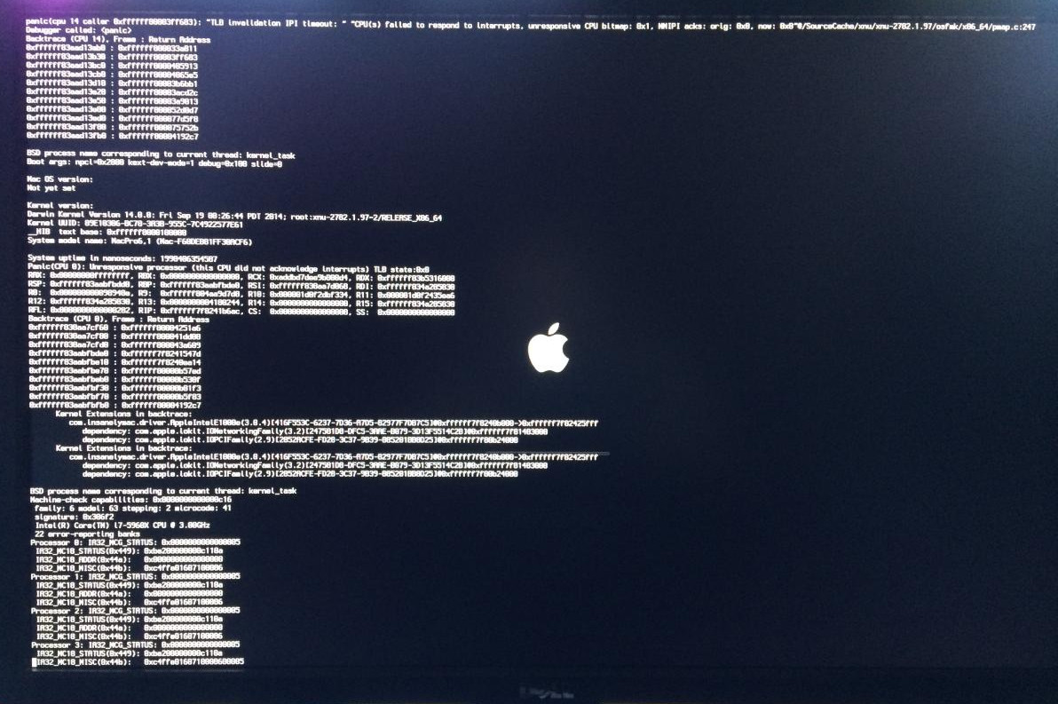

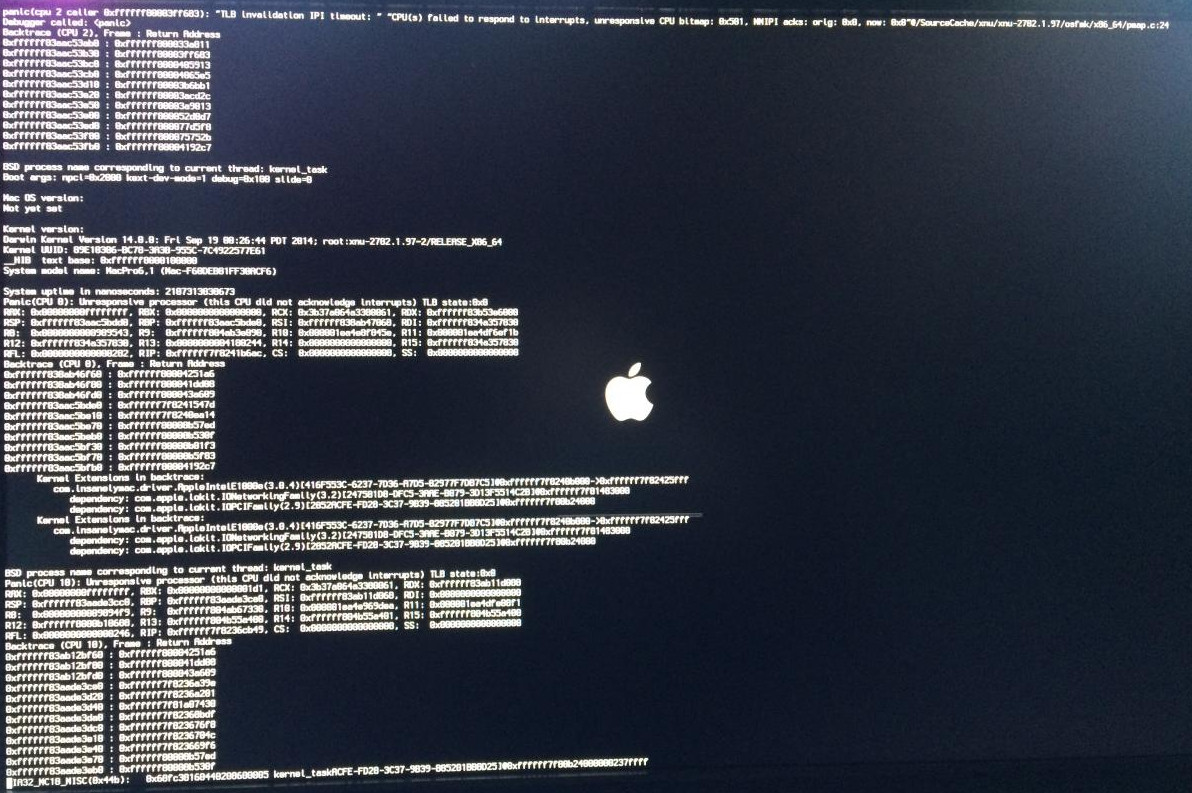

gulftown Posted November 8, 2014 Share Posted November 8, 2014 jamiethemorris-Have not tried sleep enabler. Do you think I can get an accurate read on it given the random issues I am currently having?Out of 14 boots, 7 have been successful and 7 failed. Most of the time I get KP like those attached but sometimes it just restarts without any output. I am not running verbose but I will. The thing that baffles me is that in the last 3 reboots I got the attached kp and then it booted fine with no changes whatsoever. What i read out of these two is that there is still something going on with the CPU but it seems like a different cpu (one is CPU14, other is CPU2) then the issue gets into I/O which appears to start with the ethernet driver but may be related to IOPCIFamily. Link to comment https://www.insanelymac.com/forum/topic/301585-haswell-e-mach_kernel-patch-5960x-5830k-and-5820k-1010-10101-yosemite/page/12/#findComment-2082930 Share on other sites More sharing options...
jamiethemorris Posted November 8, 2014 Share Posted November 8, 2014 It's a because of the Ethernet kext. I think that's the only problem, I don't think there's anything going in with the CPU. Are you using the same version that is working for others? 1 Link to comment https://www.insanelymac.com/forum/topic/301585-haswell-e-mach_kernel-patch-5960x-5830k-and-5820k-1010-10101-yosemite/page/12/#findComment-2082950 Share on other sites More sharing options...
gulftown Posted November 8, 2014 Share Posted November 8, 2014 It's a because of the Ethernet kext. I think that's the only problem, I don't think there's anything going in with the CPU. Are you using the same version that is working for others? That was my intent - but i was having Ethernet issues, so i am expecting this is an I/O problem (incompetent operator). Thank you for pointing me in the right direction - i will go back and delete all copies (EFI and S/L/E) of AppleGB.kext and AppleIntelE1000e then use stinga's rebuild caches command and then kext wizard to rebuild permissions. I will add them back in to the 10.10 folder in EFI and rebuild.repair. I will also disable the second NIC just for good measure. Thanks again keeping me away from poking in other areas that would have done more harm than good :-) EDIT1 - confirmed issue was with AppleGB.kext or AppleIntelE1000e.kext by removing from 10.10, rebuild/repair. No more KP at boot. Looking to find clean version to get Ethernet back. I was hoping this also fixed my wake issue...but no. Link to comment https://www.insanelymac.com/forum/topic/301585-haswell-e-mach_kernel-patch-5960x-5830k-and-5820k-1010-10101-yosemite/page/12/#findComment-2082962 Share on other sites More sharing options...

gulftown Posted November 8, 2014 Share Posted November 8, 2014 It's a because of the Ethernet kext. I think that's the only problem, I don't think there's anything going in with the CPU. Are you using the same version that is working for others? i thought i was using the same kext - the one i am using is from rampagedev x99.dmg. When i removed it i could boot without issue- adding it back into SLE and rebuilding cache resulted in KP. Is anyone else using the kext from rampagedev's x99.dmg? Is there any chance that the issue is not with the AppleIntelE1000e but something else up the chain? Edit- i grabbed AppleIntelE1000e from another build - and it worked fine. For those that have a bat phone to contact rampagedev may want to alert him of this issue. I won't say the kext in his dmg is corrupt..but it did cause issues for me. The version i am using has a date 6/25/14, 9:50 PM version 3.1.0. Rampage dev is version 3.0.4.1 2 Link to comment https://www.insanelymac.com/forum/topic/301585-haswell-e-mach_kernel-patch-5960x-5830k-and-5820k-1010-10101-yosemite/page/12/#findComment-2083087 Share on other sites More sharing options...
jamiethemorris Posted November 9, 2014 Share Posted November 9, 2014 i thought i was using the same kext - the one i am using is from rampagedev x99.dmg. When i removed it i could boot without issue- adding it back into SLE and rebuilding cache resulted in KP. Is anyone else using the kext from rampagedev's x99.dmg? Is there any chance that the issue is not with the AppleIntelE1000e but something else up the chain? Edit- i grabbed AppleIntelE1000e from another build - and it worked fine. For those that have a bat phone to contact rampagedev may want to alert him of this issue. I won't say the kext in his dmg is corrupt..but it did cause issues for me. The version i am using has a date 6/25/14, 9:50 PM version 3.1.0. Rampage dev is version 3.0.4.1 just notify him on his blog in the x99 DMG page. Link to comment https://www.insanelymac.com/forum/topic/301585-haswell-e-mach_kernel-patch-5960x-5830k-and-5820k-1010-10101-yosemite/page/12/#findComment-2083327 Share on other sites More sharing options...
