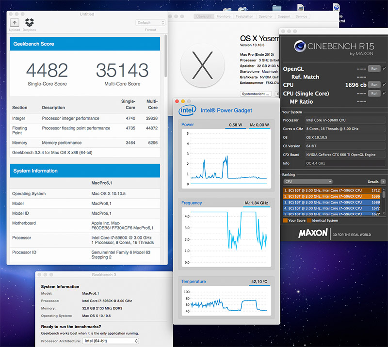

Smallersen Posted March 14, 2016 Share Posted March 14, 2016 This is similar to my build except i've Asus X99-E-WS as mainboard. I run too an overclock to 4.3 and 4.4 ghz, but the problem is that speedstep is still not supported so cpu will run ALWAYS at higher frequency even when it's in idle mode! Hi Nightflyer, You just still havnt got the right setting in kexts and Bios, I suppose. I have a very fast running system and quite good speedsteps. Watch the frequence line in Intel Power Gadget, showing Geekbench and Cinebench action. Frequency jumps from 1.2 Ghz to 4.4 Ghz. Power draw with hardware watt meter for the computer jumps from 115W idle to 370W in Cinebench. I managed to run my processor stable at 4.4 Ghz and just 1.2 volt processor voltage. 1 Link to comment https://www.insanelymac.com/forum/topic/301585-haswell-e-mach_kernel-patch-5960x-5830k-and-5820k-1010-10101-yosemite/page/27/#findComment-2223903 Share on other sites More sharing options...
thenightflyer Posted March 15, 2016 Share Posted March 15, 2016 Hi Nightflyer, You just still havnt got the right setting in kexts and Bios, I suppose. I have a very fast running system and quite good speedsteps. Watch the frequence line in Intel Power Gadget, showing Geekbench and Cinebench action. Frequency jumps from 1.2 Ghz to 4.4 Ghz. Power draw with hardware watt meter for the computer jumps from 115W idle to 370W in Cinebench. I managed to run my processor stable at 4.4 Ghz and just 1.2 volt processor voltage. Which kext settings do you use? And please can you post your bios settings? Link to comment https://www.insanelymac.com/forum/topic/301585-haswell-e-mach_kernel-patch-5960x-5830k-and-5820k-1010-10101-yosemite/page/27/#findComment-2223956 Share on other sites More sharing options...
golfleep Posted March 16, 2016 Share Posted March 16, 2016 Which kext settings do you use? And please can you post your bios settings? Hey nightflyer, I had to turn off IntelXHCI in BIOS in order to get the 5960x to step down during idle. Flip side is that I lose all USB ports except two on the back, which I can get back by adding an aftermarket USB 3 PCIe card (although I don't really need the USB ports anyways). Turns out something in the IntelXHCI is causing a massive amount of interrupts (something like 200,000 a second) which you can observe with the powermetrics command in terminal. These interrupts keep the CPU from idling down. It's not speedstep in that the Vcore doesn't step down, but it defintely helps in terms of temps and power consumption. You can install genericxhci kext to get back the USB ports after turning off intelXHCI in BIOS, but this was too buggy/laggy on my system, and it was easier to live without the USB ports or use the USB PCIe card. HTHs! Link to comment https://www.insanelymac.com/forum/topic/301585-haswell-e-mach_kernel-patch-5960x-5830k-and-5820k-1010-10101-yosemite/page/27/#findComment-2224275 Share on other sites More sharing options...
thenightflyer Posted March 16, 2016 Share Posted March 16, 2016 Hey nightflyer, I had to turn off IntelXHCI in BIOS in order to get the 5960x to step down during idle. Flip side is that I lose all USB ports except two on the back, which I can get back by adding an aftermarket USB 3 PCIe card (although I don't really need the USB ports anyways). Turns out something in the IntelXHCI is causing a massive amount of interrupts (something like 200,000 a second) which you can observe with the powermetrics command in terminal. These interrupts keep the CPU from idling down. It's not speedstep in that the Vcore doesn't step down, but it defintely helps in terms of temps and power consumption. You can install genericxhci kext to get back the USB ports after turning off intelXHCI in BIOS, but this was too buggy/laggy on my system, and it was easier to live without the USB ports or use the USB PCIe card. HTHs! Thanks for your answer...what brand of USB3 pci-e card is native with OSX? Link to comment https://www.insanelymac.com/forum/topic/301585-haswell-e-mach_kernel-patch-5960x-5830k-and-5820k-1010-10101-yosemite/page/27/#findComment-2224280 Share on other sites More sharing options...
jamiethemorris Posted March 16, 2016 Share Posted March 16, 2016 Hey nightflyer, I had to turn off IntelXHCI in BIOS in order to get the 5960x to step down during idle. Flip side is that I lose all USB ports except two on the back, which I can get back by adding an aftermarket USB 3 PCIe card (although I don't really need the USB ports anyways). Turns out something in the IntelXHCI is causing a massive amount of interrupts (something like 200,000 a second) which you can observe with the powermetrics command in terminal. These interrupts keep the CPU from idling down. It's not speedstep in that the Vcore doesn't step down, but it defintely helps in terms of temps and power consumption. You can install genericxhci kext to get back the USB ports after turning off intelXHCI in BIOS, but this was too buggy/laggy on my system, and it was easier to live without the USB ports or use the USB PCIe card. HTHs! You can also avoid the interrupts by using the GenericUSBXHCI kext. Everyone with an X99 build should either be using this kext or disabling XHCI in the BIOS because not only does it prevent it from idling properly, but it also drastically hurts performance. 2 Link to comment https://www.insanelymac.com/forum/topic/301585-haswell-e-mach_kernel-patch-5960x-5830k-and-5820k-1010-10101-yosemite/page/27/#findComment-2224285 Share on other sites More sharing options...
golfleep Posted March 16, 2016 Share Posted March 16, 2016 Thanks for your answer...what brand of USB3 pci-e card is native with OSX? There's whole thread on the other forum about which cards are compatible, I use the intatek KTU3FR-502U, but there are many others described on the thread. edit - just saw jamiethemorris' post. yeah my geekbench jumped up by 2,500 after turning off intelXHCI. I tried GenericUSBXHCI kext, but it was pretty buggy for me, it was easier for me to turn off intelXHCI Link to comment https://www.insanelymac.com/forum/topic/301585-haswell-e-mach_kernel-patch-5960x-5830k-and-5820k-1010-10101-yosemite/page/27/#findComment-2224288 Share on other sites More sharing options...
