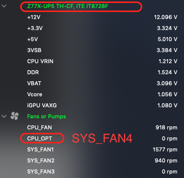

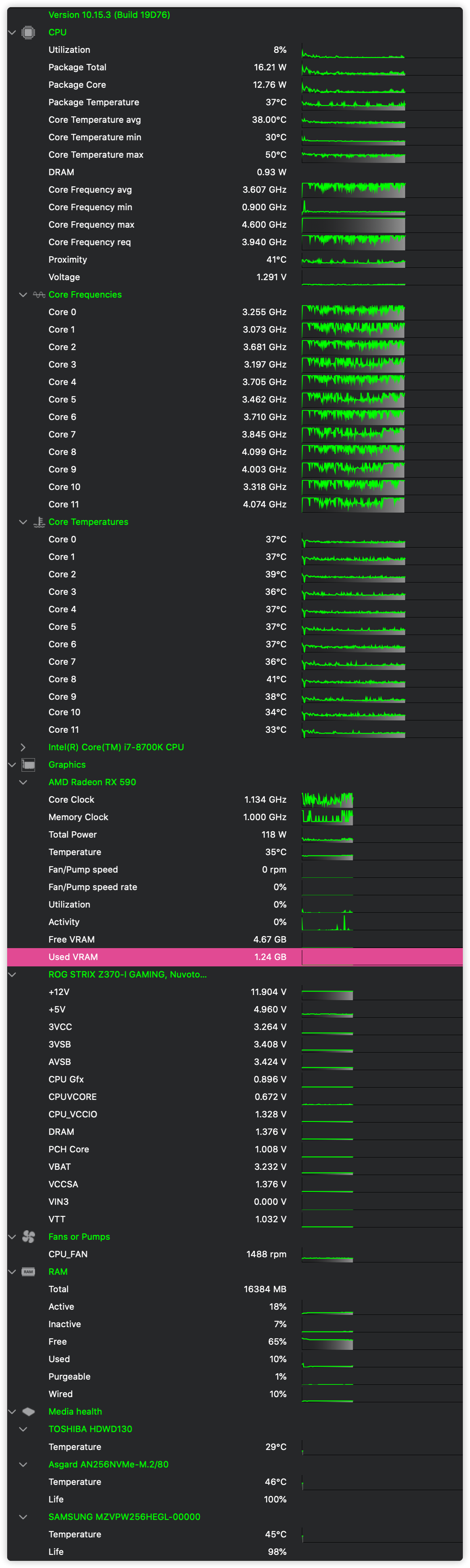

MacNB Posted February 16, 2020 Share Posted February 16, 2020 2 hours ago, Andrey1970 said: Thanks that helped my situation with the motherboard name (Z77X-UP5-TH). It would be good to list in the Configuration.pdf file what exact OEM info is exposed when turning on that option. Thx. Now it's displayed correctly: @vector sigma Motherboard name now correct after changing OC config to expose more OEM info. The only thing that's not right is CPU_OPT fan name should be called SYS_FAN4...at least that is how it is marked on the motherboard and in the manual. I do not see Z77X-UP5 TH-CF.plist in the HWMonitorSMC2 app's Contents LPC Gigabyte folder. Link to comment https://www.insanelymac.com/forum/topic/299861-hwsensors3/page/83/#findComment-2708593 Share on other sites More sharing options...

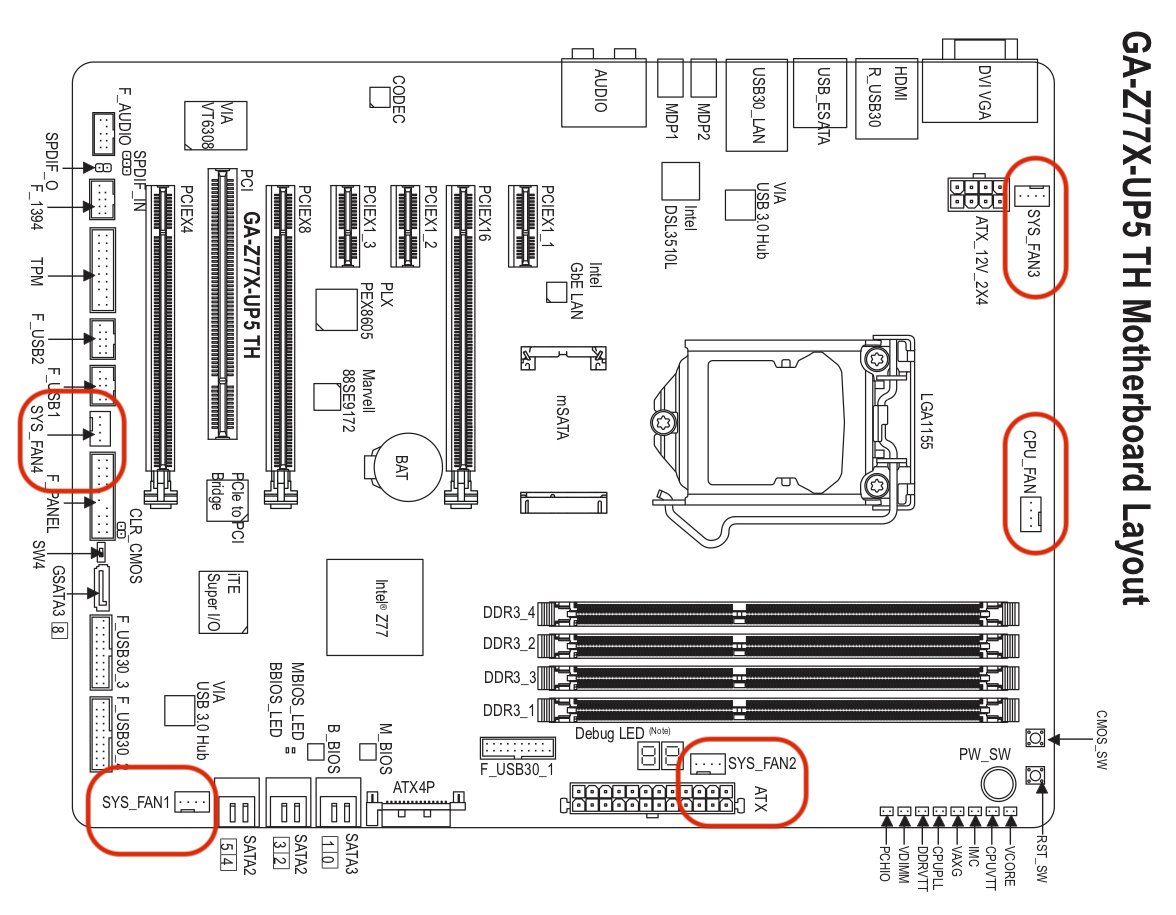

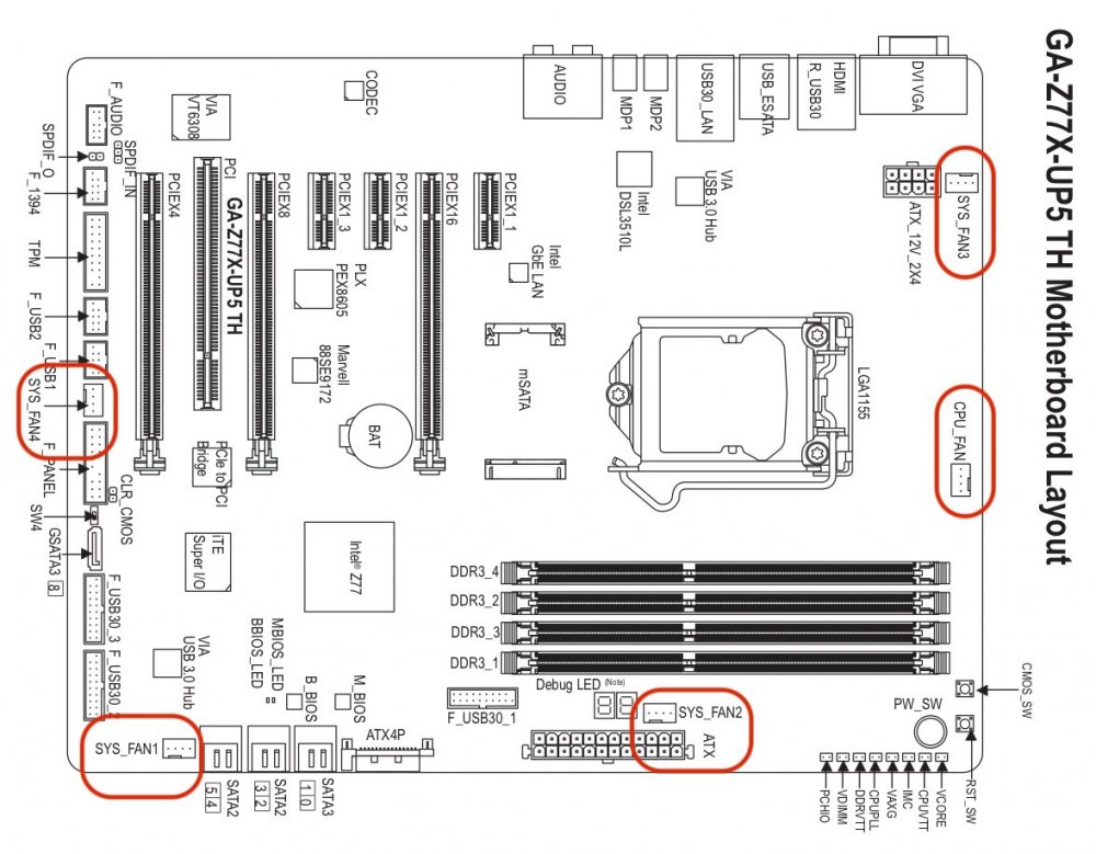

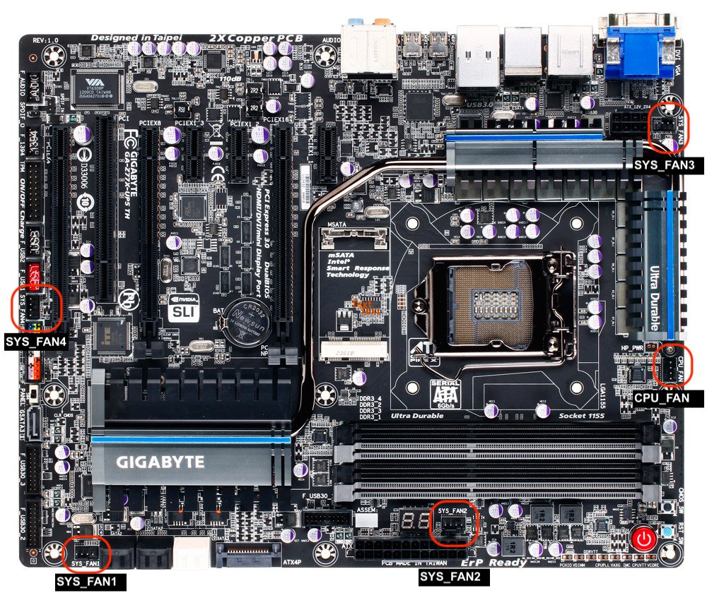

MacNB Posted February 16, 2020 Share Posted February 16, 2020 16 minutes ago, Andrey1970 said: Where SYS_FAN4? Here are the fan header locations: Manual page: I hope that helps. Link to comment https://www.insanelymac.com/forum/topic/299861-hwsensors3/page/83/#findComment-2708607 Share on other sites More sharing options...

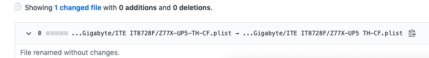

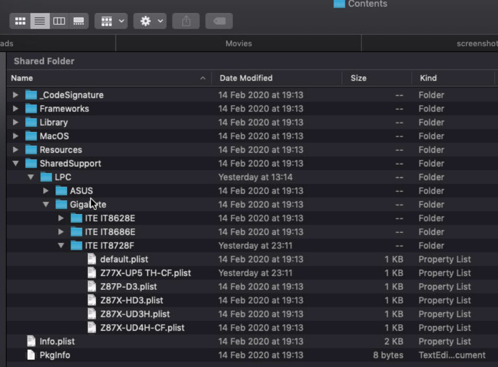

Andrey1970 Posted February 16, 2020 Share Posted February 16, 2020 (edited) 33 minutes ago, MacNB said: Here are the fan header locations: Rename Gigabyte/ITE IT8728F/default.plist to Z77X-UP5 TH-CF.plist and to write the correct names of fans for your motherboard. Edited February 16, 2020 by Andrey1970 1 Link to comment https://www.insanelymac.com/forum/topic/299861-hwsensors3/page/83/#findComment-2708610 Share on other sites More sharing options...
MacNB Posted February 16, 2020 Share Posted February 16, 2020 37 minutes ago, Andrey1970 said: Rename Gigabyte/ITE IT8728F/default.plist to Z77X-UP5 TH-CF.plist and enter the correct names of fans for your motherboard. Thanks. That fixed it. Link to comment https://www.insanelymac.com/forum/topic/299861-hwsensors3/page/83/#findComment-2708613 Share on other sites More sharing options...
Andrey1970 Posted February 16, 2020 Share Posted February 16, 2020 1 minute ago, MacNB said: Thanks. That fixed it. Unload Gigabyte/ITE IT8728F/Z77X-UP5 TH-CF.plist here. 1 Link to comment https://www.insanelymac.com/forum/topic/299861-hwsensors3/page/83/#findComment-2708614 Share on other sites More sharing options...
vector sigma Posted February 16, 2020 Share Posted February 16, 2020 8 minutes ago, Andrey1970 said: Unload Gigabyte/ITE IT8728F/Z77X-UP5 TH-CF.plist here. done .. I'm a fortune teller 1 Link to comment https://www.insanelymac.com/forum/topic/299861-hwsensors3/page/83/#findComment-2708617 Share on other sites More sharing options...
Andrey1970 Posted February 16, 2020 Share Posted February 16, 2020 1 minute ago, vector sigma said: done .. I'm a fortune teller Probably it so. But we don't know precisely where CPU_FAN and compliance SYS_FAN X. Link to comment https://www.insanelymac.com/forum/topic/299861-hwsensors3/page/83/#findComment-2708618 Share on other sites More sharing options...

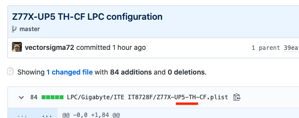

Andrey1970 Posted February 16, 2020 Share Posted February 16, 2020 6 minutes ago, MacNB said: I don't understand what you mean. Simply confirm it https://www.insanelymac.com/forum/topic/299861-hwsensors3/?do=findComment&comment=2708617 Link to comment https://www.insanelymac.com/forum/topic/299861-hwsensors3/page/83/#findComment-2708621 Share on other sites More sharing options...
vector sigma Posted February 17, 2020 Share Posted February 17, 2020 @MacNB you reuse default.plist but fans name may be looks ok, but in reality may be something else as the default.plist was based on another motherboard. e.g. Sys Fan 4 can be else on your mobo, may be is Sys Fan 1 for what we know if you do not ensure this. Otherwise the fan configuration is not true.. Link to comment https://www.insanelymac.com/forum/topic/299861-hwsensors3/page/83/#findComment-2708622 Share on other sites More sharing options...
Andrey1970 Posted February 17, 2020 Share Posted February 17, 2020 (edited) 49 minutes ago, vector sigma said: done .. I'm a fortune teller You are sure? Here its screen, there space. Edited February 17, 2020 by Andrey1970 Link to comment https://www.insanelymac.com/forum/topic/299861-hwsensors3/page/83/#findComment-2708624 Share on other sites More sharing options...
vector sigma Posted February 17, 2020 Share Posted February 17, 2020 24 minutes ago, Andrey1970 said: You are sure? Here its screen, there space. fixed: Link to comment https://www.insanelymac.com/forum/topic/299861-hwsensors3/page/83/#findComment-2708626 Share on other sites More sharing options...

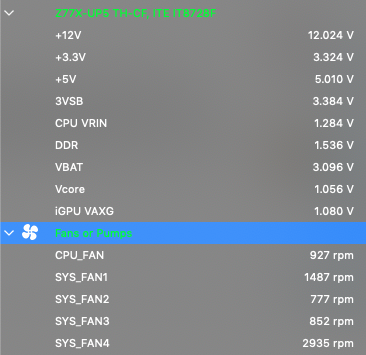

MacNB Posted February 17, 2020 Share Posted February 17, 2020 (edited) 14 hours ago, vector sigma said: as the default.plist comes from ...but if @MacNB want ensure it.. I confirm the fan locations and their their names as shown in the pictures of the Z77X-UP TH motherboard. I went through each fan connecter one by one connecting a fan to make sure there was a speed reading on each connector. Then attached 4 fans + the one on the CPU cooler: Also attached is the config file in from the App. Z77X-UP5 TH-CF.plist.zip Edited February 17, 2020 by MacNB added screenshot 1 Link to comment https://www.insanelymac.com/forum/topic/299861-hwsensors3/page/83/#findComment-2708725 Share on other sites More sharing options...
vector sigma Posted February 17, 2020 Share Posted February 17, 2020 7 hours ago, MacNB said: I confirm the fan locations and their their names as shown in the pictures of the Z77X-UP TH motherboard. I went through each fan connecter one by one connecting a fan to make sure there was a speed reading on each connector. Then attached 4 fans + the one on the CPU cooler: Also attached is the config file in from the App. Z77X-UP5 TH-CF.plist.zip Thanks to had taken the time to ensure fans connectors are right. The file is identical on what it's already on Github.. Link to comment https://www.insanelymac.com/forum/topic/299861-hwsensors3/page/83/#findComment-2708783 Share on other sites More sharing options...

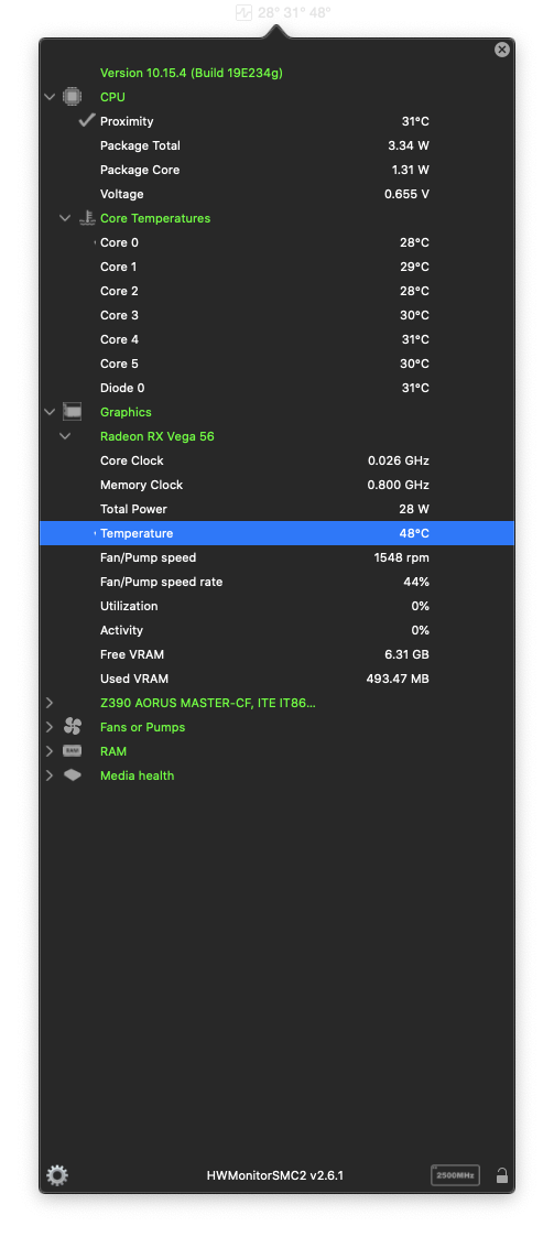

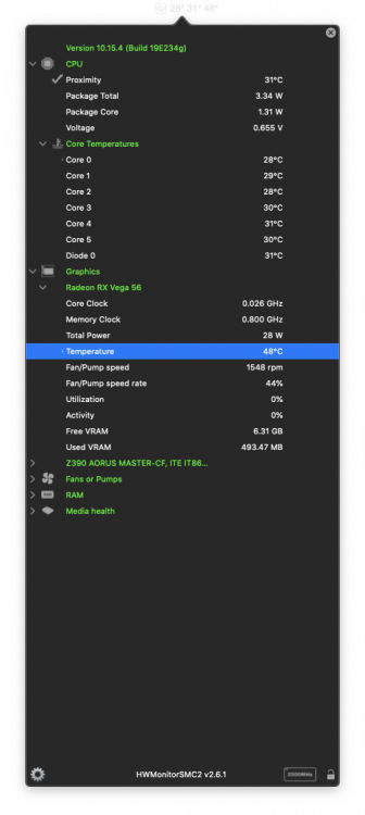

darthsian Posted February 20, 2020 Share Posted February 20, 2020 Hi vector, for items that are in a subgroup, such as Graphics / Vega56 / Temperature or CPU / Core Temperatures / Core 0, the check boxes ✔ are shifted to the right and are not visible. 1 Link to comment https://www.insanelymac.com/forum/topic/299861-hwsensors3/page/83/#findComment-2709114 Share on other sites More sharing options...

vector sigma Posted February 25, 2020 Share Posted February 25, 2020 On 2/20/2020 at 9:55 AM, darthsian said: Hi vector, for items that are in a subgroup, such as Graphics / Vega56 / Temperature or CPU / Core Temperatures / Core 0, the check boxes ✔ are shifted to the right and are not visible. Fixed at github. On 2/22/2020 at 10:44 PM, maclinuxG4 said: sur for radeon VII ? radeon frontier all before vega and 5700 ? Doesn't require kexts to be installed, so running the app and see cost nothing On 2/24/2020 at 6:35 PM, iCanaro said: sorry for OT kext virtualsmc plugin for temp. CPU AMD + app AMD Power gadget developer https://github.com/trulyspinach/SMCAMDProcessor Good, anyway for different sensor projects I'll be glad to talk about it here 1 Link to comment https://www.insanelymac.com/forum/topic/299861-hwsensors3/page/83/#findComment-2709843 Share on other sites More sharing options...
