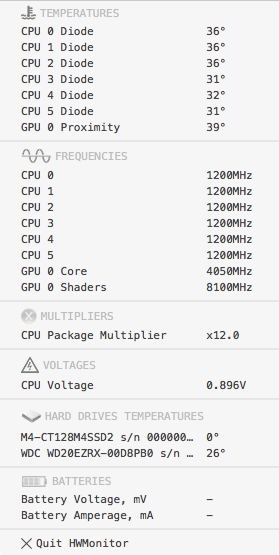

I just updated my X79 to the latest rev51 from the rev33 that I've been using for the past year or so.
GeforceSensors is showing 10x the speeds for Core and Shaders (should be 405 and 810). Rolling back to the older kext fixed this.
Also, is there any way to have the Batteries section in HWMonitorSMC not show up while running on a desktop? Again, rolling back to the older version fixed this for me.

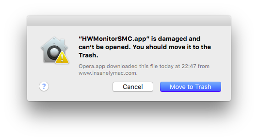

If I use the HWMonitorSMC.app after extractin it, I've got this error message:
don't know, it tells you is damaged, but redownloading it is fine here.
Well, I think should be easy, but no time today. I'll looking into this later.

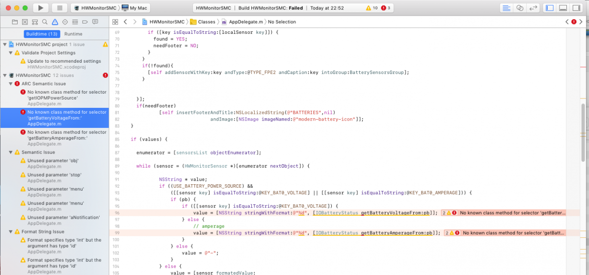

Explain me please these issues
Is my corrected sources differ from your? attachicon.gifhwmonitor.zip
I have Xcode 9.0.1, in OS 10.12.6.
in IOBatteryStatus.h you should add these function's declaration:
+(NSDictionary *)getIOPMPowerSource;
+(int) getBatteryVoltageFrom:(NSDictionary *)IOPMPowerSource;
+(int) getBatteryAmperageFrom:(NSDictionary *)IOPMPowerSource;
and in IOBatteryStatus.m the corresponding functions:
+ (NSDictionary *) getIOPMPowerSource
    CFMutableDictionaryRef matching , properties = NULL;
    io_registry_entry_t entry = 0;
    matching = IOServiceMatching( "IOPMPowerSource" );
    entry = IOServiceGetMatchingService( kIOMasterPortDefault , matching );
    IORegistryEntryCreateCFProperties( entry , &properties , NULL , 0 );
    NSDictionary * dict = CFBridgingRelease(properties);
    IOObjectRelease( entry );
    return dict;
// Voltage measured in mV
+ (int) getBatteryVoltageFrom:(NSDictionary *)IOPMPowerSource
    if (IOPMPowerSource && [IOPMPowerSource objectForKey:@kIOPMPSVoltageKey]) {
        return [[IOPMPowerSource objectForKey:@kIOPMPSVoltageKey] intValue];
    return 0;
// Capacity measured in mA
+ (int) getBatteryAmperageFrom:(NSDictionary *)IOPMPowerSource
    if (IOPMPowerSource && [IOPMPowerSource objectForKey:@kIOPMPSAmperageKey]) {
        int mA = [[IOPMPowerSource objectForKey:@kIOPMPSAmperageKey] intValue];
        return (mA > 0) ? mA : (0 - mA);
    return 0;
both before @end.
More, on top of the .h or the .m file (better the .m) you must add:
#import <IOKit/pwr_mgt/IOPM.h>
Only needed to get the keys kIOPMPSAmperageKey and kIOPMPSVoltageKey (or all the others in the IOPMPowerSource dictionary). Their strings can change in time, who knows, but not the macros.
Your original project does not use default Xcode settings so little differences in the "Build Settings" to avoid common clang's warnings.. so to restore them. it should work anyway.
Latest project I posted was just the one in:
../hwsensors-hwsensors3-code/trunk/hwmonitor
+ my modification. Basically this code will work with voodoo, rehabman's kext... or just in a real mac, since all kexts publish the same thing in IOPMPowerSource.
See that this time I used kIOPMPSAmperageKey (mA) as suggested by you.

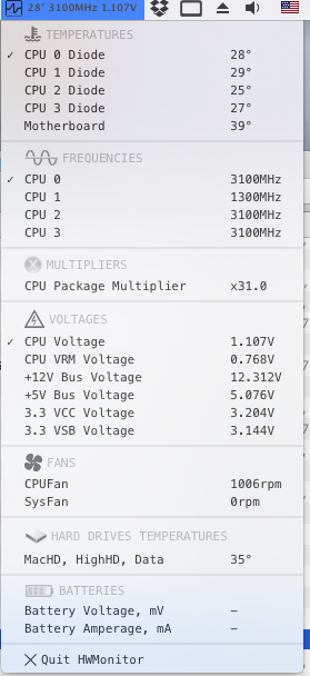

See Battery section is empty.
can we make it invisible if no batteries found?
