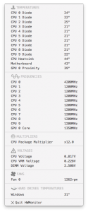

Thank you slice I am playing with options
I miss some core (only 16 displayed and no fan monitored) some weird high motherboard temperature also
Attached DarwinDumper
Thank you

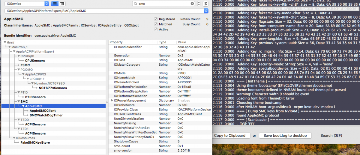

1. You seems have double FakeSMC?
kernel: Couldn't alloc class "FakeSMCKeyStore"
2. The kext works but with default profile which seems not good for you
kernel: (W836x) W836x: found NCT6779D
kernel: (W836x) W836x:  mother vendor=ASUSTeK COMPUTER INC. product=Z10PE-D16 WS
kernel: (W836x) W836x: [Warning] set default configuration
Open info.plist of the kext and try to understand the differences between profiles for different motherboard. Apply your connectors.

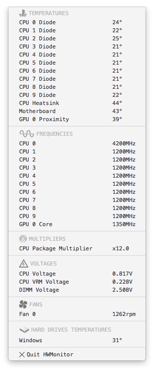

On the dual cpu systems it shows all CPU cores for 1 cpu only (0-F), also I have the same Temperature issue as Fabio have it, Motherboard >106C, CPU Heatsink > 97C
The only reason why we might need all cores and processors on the dual system so we can monitor the frequency changers to make sure the power management works correctly since IPG doesn't work with dual CPU systems.
Another bug I've found is the GPU 0 Core frequency is constantly 1350MHZ on GTX 980
Any suggestions :)?

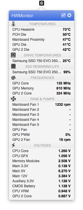

Hello Slice,
It's interesting that kozlek's version of this gives some sensors that yours does not, and vice versa.  I'm switching to your version now so I can have proper CPU temperatures.  But with this version, rev40, I am lacking some voltage sensors, PCH die temp, and the second GPU temp.
Also, it would be awesome to get all the fan speeds, but I realize that might be very difficult, since even most Windows apps don't seem to work with this board.  The only app that shows all fan speeds properly is Gigabyte SIV.  This motherboard's SuperIO chip is an IT8620F.  Your IT87x plugin shows 1 out of 4 fans accurately.
EDIT: I just realized this board has a second chip for additional fan control, an ITE8792E.  Would it be possible to add support for that one too?

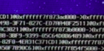

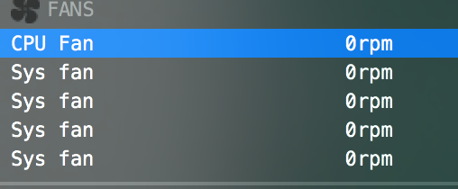

This is interesting information but the photo quality is too low
ok no problem. will upload higher res photo.
So i booted with helper card intel and i got this kp. but then i thought maybe this is problem. Then i booted blind with amd gpu and it just rebooted. must check logs.

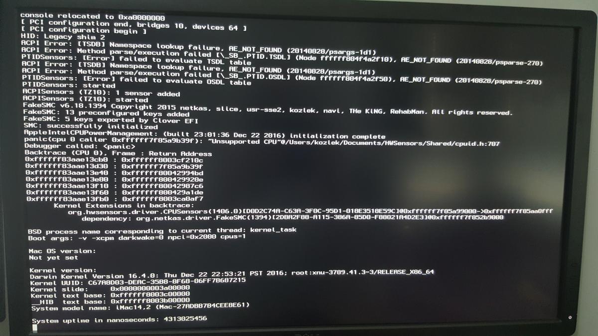

Hi,
I had this kp as part of an installation on my X299 hack. CPU is i9-7900x
The install was successful after I removed the plugins from fakeSMC kext.
But of course now I don't have HWMon. Which with this chip makes me nervous given that I haven't got speedstep working yet and it's running at full noise (and heat).
Is there a way this can be fixed?
Hi,
this is FakeSMC v6 on the screenshot. Use my version or ask Kozlek for update his version.

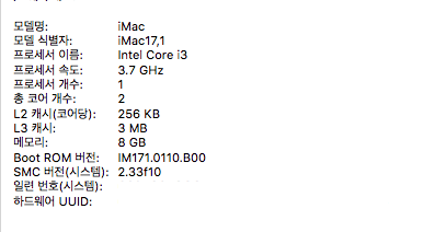

seems smc version problem on some osx or some system. not sure and clear.
i replaced fakesmc files with plugins files. then got result
kozlek's kext shown corrected smc version
slice's kext shown incorrected smc version
i just report problem. thanks in advance.
Test, please,
Release350.zip
Test, please,
attachicon.gifRelease350.zip
it works. :)
