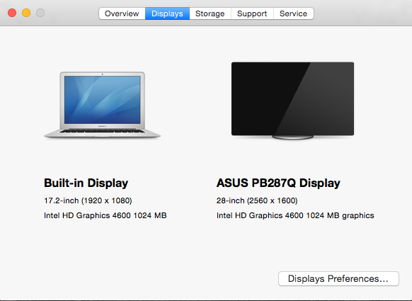

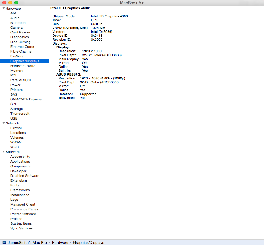

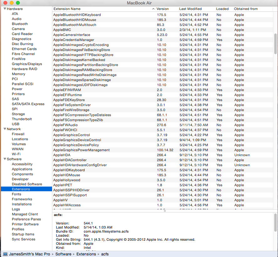

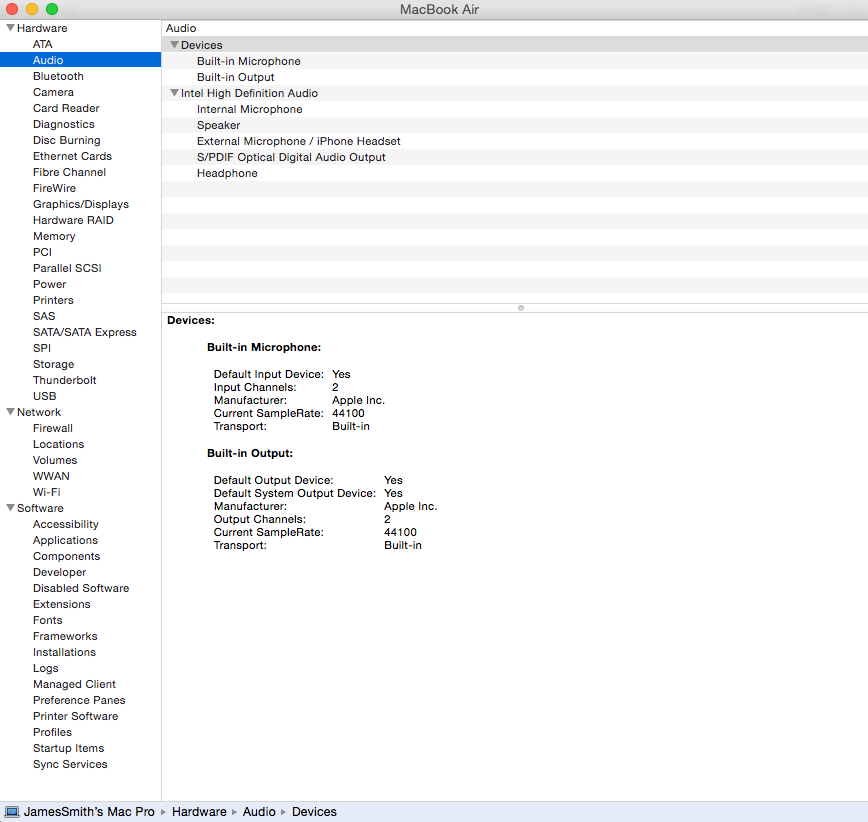

jsl Posted September 13, 2014 Share Posted September 13, 2014 The HD4600 HDMI patch changed with dp5/beta2. Contact Piker-Alpha at Issues · Piker-Alpha/AppleHDA8Series.sh. Up to DP7 is there any chance to enable HDMI audio from Intel Mobile HD4600 with unsupported ALC-282 audio in a laptop ? I can enable both Laptop Screen and HDMI display from Mobile HD4600 and Internal Speaker from ALC-282, but up to now no HDMI audio working even after patching AppleIntelFramebufferAzul.kext & AppleIntelHD5000Graphics.kext and editing of DSDT.aml. In desktop HD4600 these are working, but no luck for laptop. By the way no actual output from VoodooHDA's HDMI audio output even it was shown in System Information & Preferences. Link to comment https://www.insanelymac.com/forum/topic/298819-yosemite-audio-realtek-alc-applehda/page/7/#findComment-2060345 Share on other sites More sharing options...
toleda Posted September 14, 2014 Author Share Posted September 14, 2014 Up to DP7 is there any chance to enable HDMI audio from Intel Mobile HD4600 with unsupported ALC-282 audio in a laptop ? No files attached, no idea. Link to comment https://www.insanelymac.com/forum/topic/298819-yosemite-audio-realtek-alc-applehda/page/7/#findComment-2060664 Share on other sites More sharing options...

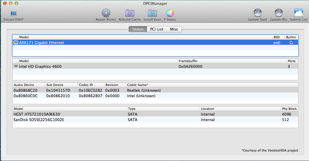

jsl Posted September 15, 2014 Share Posted September 15, 2014 No files attached, no idea. Thanks for your reply and help. The following are boot by Clover in DP7. DSDT.aml.zip JamesSmith’s Mac Pro.zip Link to comment https://www.insanelymac.com/forum/topic/298819-yosemite-audio-realtek-alc-applehda/page/7/#findComment-2060685 Share on other sites More sharing options...
jsl Posted September 15, 2014 Share Posted September 15, 2014 No files attached, no idea. In both 10.9.4 & 10.9.5 I can boot by Chameleon with patched mach_kernel. But using VoodooHDA can get only Internal Speakers & Microphone working only, no actual audio output from HDMI port. Hope get HDMI audio working in Mavericks 10.9.4/10.9.5 or Yosemite DP7 ! DSDT1.aml.zip JamesSmith’s MacBook Pro.zip Link to comment https://www.insanelymac.com/forum/topic/298819-yosemite-audio-realtek-alc-applehda/page/7/#findComment-2060690 Share on other sites More sharing options...
toleda Posted September 15, 2014 Author Share Posted September 15, 2014 Thanks for your reply and help. No HDMI audio dsdt edits, no HDMI audio. See Mavericks AppleHDA HDMI Audio The dsdt edits are the same for Mavericks and Yosemite. 1 Link to comment https://www.insanelymac.com/forum/topic/298819-yosemite-audio-realtek-alc-applehda/page/7/#findComment-2060693 Share on other sites More sharing options...
jsl Posted September 15, 2014 Share Posted September 15, 2014 No HDMI audio dsdt edits, no HDMI audio. See Mavericks AppleHDA HDMI Audio The dsdt edits are the same for Mavericks and Yosemite. If I Clover boot with DSDT1.aml in which I have added HDMI audio, always got kernel Panic. Can you take a look at DSDT1.aml for me ? Link to comment https://www.insanelymac.com/forum/topic/298819-yosemite-audio-realtek-alc-applehda/page/7/#findComment-2060694 Share on other sites More sharing options...

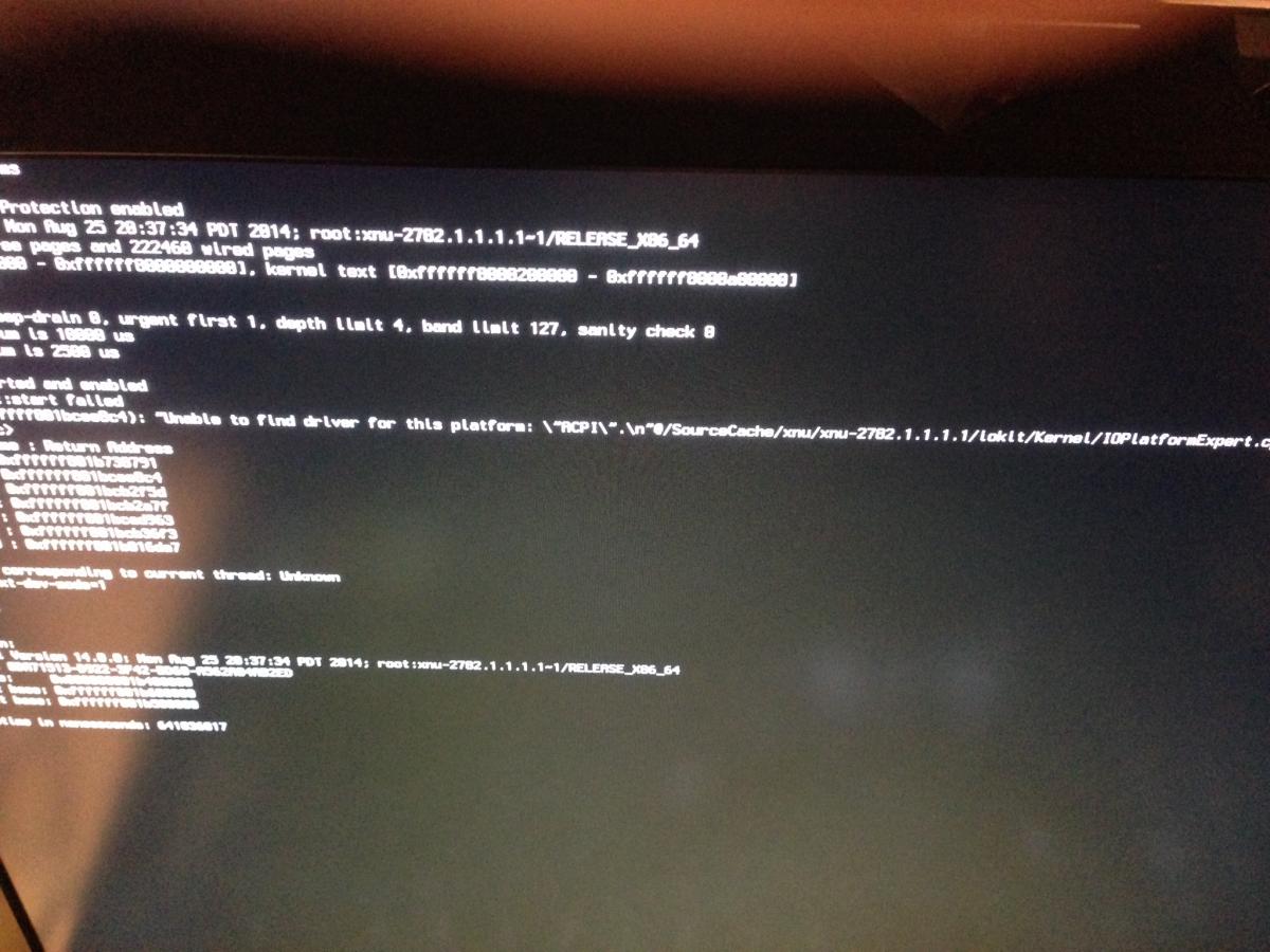

jsl Posted September 15, 2014 Share Posted September 15, 2014 Off topic, post in Mavericks AppleHDA HDMI Audio Voodoo is not compatible with the AppleHDA techniques described in this AppleHDA thread or the HDMI audio thread. What does it panic on? What chipset? My chipset is Intel 8 Series and always KP due to AppleACPIPlatformExpert failure related to DSDT0.aml or DSDT1.aml. DSDT0.aml.zip DSDT1.aml.zip Link to comment https://www.insanelymac.com/forum/topic/298819-yosemite-audio-realtek-alc-applehda/page/7/#findComment-2060712 Share on other sites More sharing options...

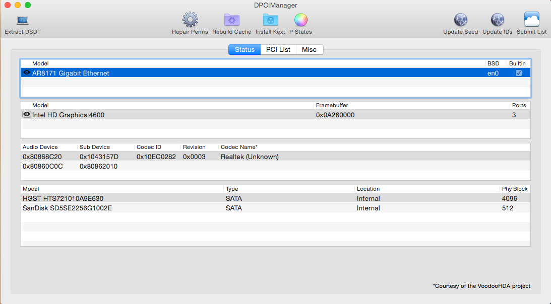

toleda Posted September 15, 2014 Author Share Posted September 15, 2014 My chipset is Intel 8 Series and always KP due to AppleACPIPlatformExpert failure related to DSDT0.aml or DSDT1.aml. Attach all native ACPI tables: MaciASL/File/Export Tableset... System specs? What dsdt did you use in Post #142 Link to comment https://www.insanelymac.com/forum/topic/298819-yosemite-audio-realtek-alc-applehda/page/7/#findComment-2060799 Share on other sites More sharing options...
jsl Posted September 15, 2014 Share Posted September 15, 2014 Attach all native ACPI tables: MaciASL/File/Export Tableset... System specs? What dsdt did you use in Post #142 Sorry for confusing you about my two different PCs. What bothers me currently is an Asus G750 Laptop. Its spec: Chipset: Intel 8 Series (Haswell CPU) Display: Intel HD4600 Mobile (04168086) + Nvidia 880M (Disabled by DSDT) Audio: ALC-282 + Intel HDMI audio (0c0c8086) Its native ACPI tables is attached as G750.acpi.zip, G750DSDT.acpi.zip, & SSDTs.zip Another Archive.zip from AIDA64 Extreme version in Windows was also attached for your reference. In post #142 I am using an desktop PC in which 3 audios are working now. Its spec: Chipset: Intel 8 Series (Haswell CPU) Display: Intel HD4600 Desktop (04128086) + AMD Radeon HD 7950 Audio: ALC-1150(900) + Intel Display Audio + AMD 7950 HDMI audio DSDT: Z87Y.aml Z87Y.aml.zip Archive.zip G750.acpi.zip G750DSDT.acpi.zip SSDTs.zip Link to comment https://www.insanelymac.com/forum/topic/298819-yosemite-audio-realtek-alc-applehda/page/7/#findComment-2060821 Share on other sites More sharing options...
toleda Posted September 15, 2014 Author Share Posted September 15, 2014 What bothers me currently is an Asus G750 Laptop. Not native; remove edited dsdt and ssdts. Restart and extract; only attach tableset (.acpi). Link to comment https://www.insanelymac.com/forum/topic/298819-yosemite-audio-realtek-alc-applehda/page/7/#findComment-2060833 Share on other sites More sharing options...
jsl Posted September 16, 2014 Share Posted September 16, 2014 Not native; remove edited dsdt and ssdts. Restart and extract; only attach tableset (.acpi). Without disabled Nvidia card by edited DSDT I can not login Mavericks 10.9.4 or 10.9.5. by Chameleon boot. Without patched DSDT.aml I always got reboot by Clover boot. The only way to extract native ACPI tables from my G750 laptop is AIDA64 Extreme or Business version in Windows. The attached are what I can extract up to now. Or you can show me how to properly login Mac OS X without the above restriction to extract native ACPI tableset ? Archive.zip Link to comment https://www.insanelymac.com/forum/topic/298819-yosemite-audio-realtek-alc-applehda/page/7/#findComment-2061006 Share on other sites More sharing options...
toleda Posted September 16, 2014 Author Share Posted September 16, 2014 The attached are what I can extract up to now. Can't open .bin files; convert the files to .aml Last resort, attach native dsdt.aml. Link to comment https://www.insanelymac.com/forum/topic/298819-yosemite-audio-realtek-alc-applehda/page/7/#findComment-2061010 Share on other sites More sharing options...
jsl Posted September 16, 2014 Share Posted September 16, 2014 Can't open .bin files; convert the files to .aml Last resort, attach native dsdt.aml. DSDT.aml.zip DSDT.dsl.zip Link to comment https://www.insanelymac.com/forum/topic/298819-yosemite-audio-realtek-alc-applehda/page/7/#findComment-2061014 Share on other sites More sharing options...
toleda Posted September 16, 2014 Author Share Posted September 16, 2014 Run an experiment. config.plist/ACPI/DropTables/Signature/TableId (without quotes, with space) SSDT "SaSsdt " SSDT "SgPeg" SSDT "OptTabl" Install one of your edited dsdts that results in a KP Boot. if KP, experiment failed. If Desktop, attach all troubleshooting files. Link to comment https://www.insanelymac.com/forum/topic/298819-yosemite-audio-realtek-alc-applehda/page/7/#findComment-2061027 Share on other sites More sharing options...
