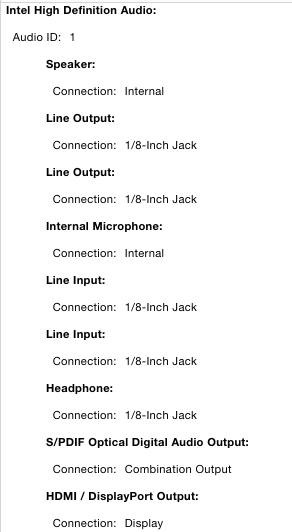

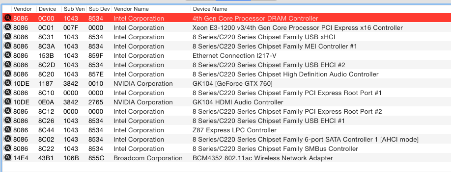

Marius_rg Posted May 21, 2015 Share Posted May 21, 2015 1.OSX10.3/AsusMaximusFormulaVI/Bios1505/CPUi7-4790/GPUgtx-960 2.CloverInjection; 3.NativeAppleHDA (attached screenshots with DPCIManager and AudioHW) Thank you for you help and let me know if you miss anything. PS: I mentioned windows just to be clear that it's not an issue with the "audio external setup",like receiver/cables) iMacIOreg.zip Link to comment https://www.insanelymac.com/forum/topic/298819-yosemite-audio-realtek-alc-applehda/page/26/#findComment-2137436 Share on other sites More sharing options...
toleda Posted May 21, 2015 Author Share Posted May 21, 2015 let me know if you miss anything. Audio is configured properly. IOReg shows no player; ignored Post #629. Link to comment https://www.insanelymac.com/forum/topic/298819-yosemite-audio-realtek-alc-applehda/page/26/#findComment-2137503 Share on other sites More sharing options...

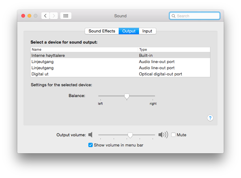

theconnactic Posted May 28, 2015 Share Posted May 28, 2015 Thank you very much, Toleda! Changed my Audio ID to 1 and everything works, even the two mic and line front connectors. There is a thing, though, that I expect you to help me solve if you know how: my system language is set to English, but the inputs and outputs have danish (!!!) names! See for yourself: Link to comment https://www.insanelymac.com/forum/topic/298819-yosemite-audio-realtek-alc-applehda/page/26/#findComment-2139623 Share on other sites More sharing options...

toleda Posted May 29, 2015 Author Share Posted May 29, 2015 my system language is set to English, but the inputs and outputs have danish (!!!) names! Indicates the AppleHDA.kext used for patching was not native; Combo Update AppleHDAs are not complete. See Post #1/Requirements/2. Native AppleHDA.kext/1. Need native . . Link to comment https://www.insanelymac.com/forum/topic/298819-yosemite-audio-realtek-alc-applehda/page/26/#findComment-2139744 Share on other sites More sharing options...
