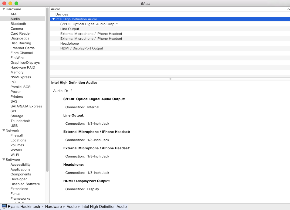

MacWienie Posted August 23, 2015 Share Posted August 23, 2015 Problem Reporting (Post to this thread with requested information attached) Description of audio problem: Please recommend ideal audio install procedure for Realtek ALC887/888B. OS X version/motherboard model/BIOS version/processor/graphics: OS X 10.10.5/Asus Z97-K/AMI UEFI 2604 x64/Intel Core i5 4590@3.3GHz/EVGA Geforce GTX 750 Ti Procedure/Guide Used: None selected at this point. Hoping you could elucidate that. Copy of IOReg (Tools 1.) - File/Save a Copy As…, verify file (no ioreg.txt): See attached zip. Copy Of Console/All Messages (last boot)/File/Save a Copy As..: See attached zip. Installed S/L/E/AppleHDA.kext or AppleHDA8Series AppleHDAxxx kext: See attached zip Screen shots: DPCIManager/Status (Tools 3.): See attached zip. System Information/Hardware/Audio/Intel High Definition Audio (not Devices): See attached zip Terminal/Shell/Export Test As. . . (if script used): Not attempted...yet audio_realtekALC-100.command AppleHDA8Series.sh audio_cloverALC-100.command Chameleon Extra/org.chameleon.Boot.plist: See attached zip DPCIManager/Misc/Boot Log: See attached zip Extra/dsdt.aml (if installed): See attached zip Extra/ssdt.aml (if installed): Not used (at least I did not create one) Requested Files.zip Link to comment https://www.insanelymac.com/forum/topic/298819-yosemite-audio-realtek-alc-applehda/page/31/#findComment-2162913 Share on other sites More sharing options...
toleda Posted August 23, 2015 Author Share Posted August 23, 2015 Description of audio problem: Please recommend ideal audio install procedure for Realtek ALC887/888B Correct edits in the wrong order, Patch 1. 9series/AMI-9eries-ssdt_HDEF-fix - Apply 2. ALCInjection/Enable Audio ID: 2 - Apply Compile, Save, Install No codec: Verify BIOS/Advanced/On Board Devices/HD Audio Controller/Enabled Link to comment https://www.insanelymac.com/forum/topic/298819-yosemite-audio-realtek-alc-applehda/page/31/#findComment-2162933 Share on other sites More sharing options...
MacWienie Posted August 23, 2015 Share Posted August 23, 2015 Not using Clover. Where do I copy the SSDT.aml file if there is no Clover subdirectory on EFI partition? Good call on the BIOS entry. I had it set to AC97. Link to comment https://www.insanelymac.com/forum/topic/298819-yosemite-audio-realtek-alc-applehda/page/31/#findComment-2162939 Share on other sites More sharing options...
toleda Posted August 24, 2015 Author Share Posted August 24, 2015 Where do I copy the SSDT.aml file if there is no Clover subdirectory on EFI partition? The guide notes Chameleon installation: Extra/DSDT.aml Link to comment https://www.insanelymac.com/forum/topic/298819-yosemite-audio-realtek-alc-applehda/page/31/#findComment-2163080 Share on other sites More sharing options...
MacWienie Posted August 25, 2015 Share Posted August 25, 2015 Applied the procedure described in this guide: OS X hdmi audio/hdef audio dsdt_v3.0 (PDF included in archive) OS X 10.10.5/Asus Z97-K/AMI UEFI 2604 x64/Intel Core i5 4590@3.3GHz/EVGA Geforce GTX 750 Ti Problem: No audio output devices found in system preferences. Files attached: Archive.zip If audio injection is necessary, please identify recommended guide to use. Thanks, in advance, for your help! One more file you might want to see: The plot thickens... Link to comment https://www.insanelymac.com/forum/topic/298819-yosemite-audio-realtek-alc-applehda/page/31/#findComment-2163443 Share on other sites More sharing options...
toleda Posted August 25, 2015 Author Share Posted August 25, 2015 Files attached: Archive.zip If audio injection is necessary, please identify recommended guide to use. Injection is provided in the patched dsdt. DSDT is correct. AppleHDA.kext is not patched. See Post #1 Nvidia HDMI audio is not working because the attached display is not HDMI. Link to comment https://www.insanelymac.com/forum/topic/298819-yosemite-audio-realtek-alc-applehda/page/31/#findComment-2163487 Share on other sites More sharing options...
MacWienie Posted August 26, 2015 Share Posted August 26, 2015 Audio installation for ALC887 successful. Used the Piker-Alpha procedure to preserve patched AppleHDA after OS X software updates. This install/patch/update procedure is not trivial. Your efforts to make it possible are commendable and appreciated. Nvidia HDMI audio will not be used as my (very old) LCD monitor currently does not support HDMI. Maybe at a later time. Link to comment https://www.insanelymac.com/forum/topic/298819-yosemite-audio-realtek-alc-applehda/page/31/#findComment-2163498 Share on other sites More sharing options...

MacWienie Posted September 13, 2015 Share Posted September 13, 2015 Sorry to ask you to revisit this problem. I decided to reinstall OS X with Clover bootloader because it works better with UEFI than Chameleon. Now that the install is complete, I am having a problem getting the Realtek 887/888B audio to work. All requested files are in the archive. Description of audio problem: No audio output devices found in system preferences OS X version/motherboard model/BIOS version/processor/graphics OS X 10.10.5/Asus Z97-K/AMI UEFI 2604 x64/Intel Core i5 4590@3.3GHz/EVGA Geforce GTX 750 Ti Procedure/Guide Used: OS X hdmi audio/hdef audio dsdt_v3.0 (PDF included in archive) Thanks again for your assistance. Archive.zip Link to comment https://www.insanelymac.com/forum/topic/298819-yosemite-audio-realtek-alc-applehda/page/31/#findComment-2167680 Share on other sites More sharing options...
toleda Posted September 13, 2015 Author Share Posted September 13, 2015 having a problem getting the Realtek 887/888B audio to work. Method actually used: Piker-Alpha AppleHDA8series dsdt patching incorrect; 4 patches applied a total of 5 times. Only 1 patch is required. Native dsdt/MaciASL/Patches: 1. 9series/AMI-Clean_Compile-9series (if required) 2, ALCinjection/Enable Audio ID: 1 MaciASL/Apply/Close/Compile/etc.. Reply with edited dsdt and new IOReg. Link to comment https://www.insanelymac.com/forum/topic/298819-yosemite-audio-realtek-alc-applehda/page/31/#findComment-2167697 Share on other sites More sharing options...
MacWienie Posted September 14, 2015 Share Posted September 14, 2015 How did you determine that the DSDT patches were applied multiple times? I am curious as to what you saw in the IOReg file (not sure where IOReg gets its data). You are correct, that is what I did (not intentionally), but the DSDT.aml I sent you was created from a DSL file that was extracted using Linux. I was very careful to patch it only 1 time and ensure it compiled without error. The only DSDT.aml files that exist in the OS (that I know of ) are in the EFI volume/partition and the EFI folder off the root directory of Macintosh HD. The audio ID used in the past was 2. What do you see that leads you to recommend Audio ID 1? Thanks for your help and prompt response. I took the liberty to include screen shots of each step of creating DSDT.aml and update/adding AppleHDA.kext to AppleHDA887.kext. With the changes that appear in the archive, I remain unable to find any audio output devices in the System Preferences. Archive.zip Link to comment https://www.insanelymac.com/forum/topic/298819-yosemite-audio-realtek-alc-applehda/page/31/#findComment-2167953 Share on other sites More sharing options...
liujianwei Posted September 15, 2015 Share Posted September 15, 2015 Seems like work on 10.9.5 and fix mic can't record bug for QQ. Link to comment https://www.insanelymac.com/forum/topic/298819-yosemite-audio-realtek-alc-applehda/page/31/#findComment-2168154 Share on other sites More sharing options...
toleda Posted September 15, 2015 Author Share Posted September 15, 2015 remain unable to find any audio output devices in the System Preferences. Problem: no dsdt/HDEF/layout-id injection, result layout-id=0, no audio Cause: ignored #763, 1 patch specified, applied 4 patches, fail Try Post #763 again. Seems like work on 10.9.5 and fix mic can't record bug for QQ. See Post #1, Problem Reporting. Specify mic, connect mic, run QQ, make IOReg. Link to comment https://www.insanelymac.com/forum/topic/298819-yosemite-audio-realtek-alc-applehda/page/31/#findComment-2168165 Share on other sites More sharing options...
toleda Posted September 15, 2015 Author Share Posted September 15, 2015 What is the URL source for MaciASL patch for "ALCinjection/Enable Audio ID: 1"? https://raw.github.com/toleda/audio_ALCInjection/master Link to comment https://www.insanelymac.com/forum/topic/298819-yosemite-audio-realtek-alc-applehda/page/31/#findComment-2168197 Share on other sites More sharing options...
MacWienie Posted September 15, 2015 Share Posted September 15, 2015 Ok, followed the instructions in #763. Attached are the requested files (see archive). Still no audio devices in System Preferences. Archive 2.zip Link to comment https://www.insanelymac.com/forum/topic/298819-yosemite-audio-realtek-alc-applehda/page/31/#findComment-2168217 Share on other sites More sharing options...
toleda Posted September 16, 2015 Author Share Posted September 16, 2015 Ok, followed the instructions in #763. Still no audio devices in System Preferences. Not quite, 3 patches applied a total of 4 times. Fortunately, the last patch was the only patch required. result, layout-id=2, correct. The AppleHDA.kext is not patched. Install native AppleHDA.kext. See Post #1, run 1 of the 3 patch methods. Reply with patch script Terminal Output and IOReg. Link to comment https://www.insanelymac.com/forum/topic/298819-yosemite-audio-realtek-alc-applehda/page/31/#findComment-2168254 Share on other sites More sharing options...
MacWienie Posted September 16, 2015 Share Posted September 16, 2015 Still unable to see any audio devices in System Preferences. Archive includes native AppleHDA.kext and AppleHDA887.kext. Thanks again for your assistance. Archive 3.zip Link to comment https://www.insanelymac.com/forum/topic/298819-yosemite-audio-realtek-alc-applehda/page/31/#findComment-2168261 Share on other sites More sharing options...
MacWienie Posted September 16, 2015 Share Posted September 16, 2015 I successfully got it to work. When patching the AppleHDA.kext file, I had to patch with binaries (e.g. $ ./AppleHDA8Series.sh -b AppleHDA). Wasn't doing that before. After that, it worked. Thanks for all of your help. Link to comment https://www.insanelymac.com/forum/topic/298819-yosemite-audio-realtek-alc-applehda/page/31/#findComment-2168275 Share on other sites More sharing options...
