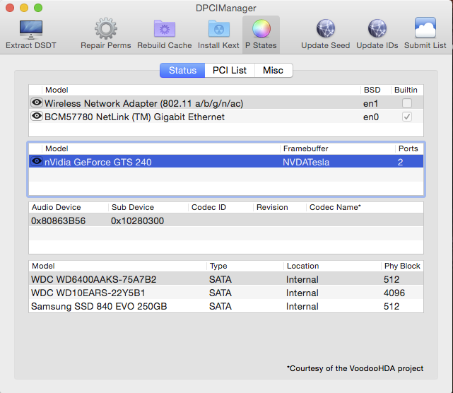

Toucanet Posted April 2, 2015 Share Posted April 2, 2015 Problem: in DPCIManager Codec ID and Codec Name is blanc. OS X 10.10.2 "Yosemite". Dell XPS 8000, preassembled mobo, Intel i7 860, nVidia GTS 240. Do I need to post all the other informations for this problem? Link to comment https://www.insanelymac.com/forum/topic/298819-yosemite-audio-realtek-alc-applehda/page/25/#findComment-2124900 Share on other sites More sharing options...
toleda Posted April 2, 2015 Author Share Posted April 2, 2015 Do I need to post all the other informations for this problem? Yes. Link to comment https://www.insanelymac.com/forum/topic/298819-yosemite-audio-realtek-alc-applehda/page/25/#findComment-2125001 Share on other sites More sharing options...
Toucanet Posted April 3, 2015 Share Posted April 3, 2015 Okay, thank you. I have not done the procedure because my problem is to find out what my codec ID and codec name are, so I think Console messages are unnecessary. System Information/Hardware/Audio/Intel High Definition Audio Not found, in the screenshot only Audio devices. No dsdt.aml and ssdt.aml installed. audio.zip Link to comment https://www.insanelymac.com/forum/topic/298819-yosemite-audio-realtek-alc-applehda/page/25/#findComment-2125050 Share on other sites More sharing options...
Sakamoto Posted April 3, 2015 Share Posted April 3, 2015 Description of audio problem I´ve followed the guide, everything to be working unti. Where I am going to use audio_realtekALC-100_v1.0.4b.command. Where it says ALC887 v_0x100302 not supported, I´m not sure what I can do from there. I´m able to get normal audio from input and output with the green and red cable. The only problem is with sound trought the HDMI Cable to my monitor with speakers. OS X version/motherboard model/BIOS version/processor/graphicsYosemite 10.10.2, MSI msi b85-e45, v10.8, i5 4440,raedon hd 7790 Procedure/Guide Used Folled the guide on post1. Copy of IOReg - IOReg_v2.1/File/Save a Copy As…, verify file (no ioreg.txt) https://www.dropbox.com/s/jq20s1na1fj7dg0/SakamotoMAC.ioreg?dl=0 Copy Of Console/All Messages (last boot)/File/Save a Copy As.. Installed S/L/E/AppleHDA.kext or AppleHDA8Series AppleHDAxxx kext My native AppleHDA: https://www.dropbox.com/sh/0e2z0yx2hm2fp9x/AADd1GoIJnCMApeC_0-et_oba?dl=0 Screen shots: DPCIManager/Status (Tools 1.)Gyazo Screen{censored}: http://gyazo.com/a3202f07f63b56f242fbf5fc5aa97caa System Information/Hardware/Audio/Intel High Definition Audio (not Devices) http://gyazo.com/df8f016db465f03ec561519b8a9df61b http://gyazo.com/4e85a2f68d04e3cffcde3a7fe31be734 Terminal/Shell/Export Test As. . . (if script used) audio_realtekALC-100.command http://gyazo.com/d2ec6de69f815112f0b3a8041e3ad0fa Clover EFI/Clover/config.plist https://www.dropbox.com/s/vq44sceg4sreyxc/config.plist?dl=0 EFI/Clover/misc/debug.log (Set config.plist/Boot/Debug/YES) Nothing inside /misc EFI/Clover/ACPI/Patched/dsdt.aml (if installed) https://www.dropbox.com/s/wfah36xwt7b0weo/DSDT.aml?dl=0 Additional info I noted when going thought your guide: 2---Realtek ALC, one of the following Device_ID - Codec Name Audio Device:0x80868C20 Codec ID: 0x10EC0887 THIS!!!! Revision:0x0302 Codec Name: Realtek ALC888B 3---- Supported Audio-IDs (Audio_ID = layout-id), select one Audio_ID: 3 - 3/5/6 port Realtek ALC onboard audio and HD3K/HD4K/AMD/Nvidia HDMI audio 4----Audio_ID Injection, select one Layout ID: 3. <03 00 00 00> Thank you! Link to comment https://www.insanelymac.com/forum/topic/298819-yosemite-audio-realtek-alc-applehda/page/25/#findComment-2125153 Share on other sites More sharing options...
toleda Posted April 3, 2015 Author Share Posted April 3, 2015 what my codec ID and codec name are No HDEF, see Realtek ALC AppleHDA Audio Injection. Select one of the available methods. Kext injection is the easiest. I´m able to get normal audio from input and output with the green and red cable. The only problem is with sound trought the HDMI Cable to my monitor with speakers. Use Audio ID: 1/layout-id: 1. 3 is for HD3000/HD4000 not HD4600. No native OS X HDMI audio on non native hardware, see Yosemite AppleHDA HDMI Audio Note: HDAEnabler?.kext disables OS X HDMI audio; must be removed. Link to comment https://www.insanelymac.com/forum/topic/298819-yosemite-audio-realtek-alc-applehda/page/25/#findComment-2125165 Share on other sites More sharing options...
