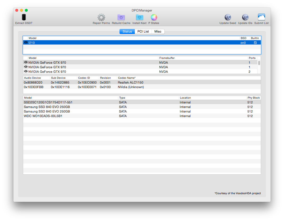

DaMadOne Posted July 13, 2015 Share Posted July 13, 2015 So... I feel like I've been around the block trying to get ALC1150 audio working so I'm now asking for help :/ I'm running vanilla Yosemite 10.10.4 installed with Clover and using Clover for pure EFI booting with vanilla kernel using Clover to patch for x99. Motherboard: MSI X99S Mpower - http://us.msi.com/product/motherboard/X99S-MPOWER.html#hero-overview Processor: i7 5930k GPU(s): 3x GTX 970 MEM: 32gb 2666 DDR4 Bios: M.6 (latest) - http://download.msi.com/bos_exe/7885vM6.zip This has been my first Intel build ever and after fiddling with OSX on AMD many times I figured this would be a breeze, lolnope . I joke, many things have been much easier with this build vs my AMD builds, but the ALC1150 on this board is kicking my butt. I have a 5.1 surround speaker setup plugged into the 3 analog outputs and nothing comes out :\ I've been trying to use the audio_CloverALC method and I've tried pure clover injection, SSDT with clover doing the rest and HDAenabler-1 with clover doing the rest. All methods net me the same results. Everything "looks" ok in IOReg, System Report and the Sound dialog in System Prefs., but I get no audio output. I've done some googleing and have found nobody else using an MSI X99 board so it looks like I may be a pioneer here. I'm primarily a Linux(Arch) user so if I can grab any info not supplied in the zip below from Linux that may be of help let me know. I've prepared a zip file that contains the info (and more) asked for from the "Problem Reporting" guidelines in the first post, let me know if more info is needed. I've spent the last 6 hours trying to get it to work and I'll continue to "mess around" and report back if I find anything new. THANKS in advance! MSI_X99S_MPower_ALC1150_Report.zip (21.5MB) - https://drive.google.com/file/d/0BxEN0cnqID8Da19PS2pqOE5RdmM/view?usp=sharing EDIT* Forgot the requested screenshot of DPCIManager and added a codec dump from linux. EDIT Again* For simplicity sake I tried the patch in place way, unfortunately I get the same results. These MSI boards must be a little different than the rest...I have a "clean" copy of my EFI folder from before messing with anything audio related so I restored it, checked AddDTGP and FixHDA and injected layoutID 1 from clover configurator, restored vanilla AppleHDA.kext (it should have been vanilla already, but can't be too cautious), rebooted and then ran audio_realtekALC-100_v1.0.4c.command, it did its thing and then I rebooted again to the same results as before MonstaPC:Documents damadone$ ./audio_realtekALC-100_v1.0.4c.command Agreement The audio_realtekALC-100 script is for personal use only. Do not distribute the patch, any or all of the files or the resulting patched AppleHDA.kext for any reason without permission. The audio_realtekALC-100 script is provided as is and without any kind of warranty. File: File: audio_realtekALC-100.command_v1.0.4c Verify kext-dev-mode=1 boot flag/argument Password: Confirm Realtek ALC1150 (y/n): y Enable HD4600 HDMI audio (y/n): n Download ALC1150 files ... % Total % Received % Xferd Average Speed Time Time Time Current Dload Upload Total Spent Left Speed 100 21366 100 21366 0 0 24306 0 --:--:-- --:--:-- --:--:-- 24307 Preparing 10.10.4 ALC1150 AppleHDA.kext_v272.18.1 Patch binaries ... 10.10.4 codec patch Install files ... Fix permissions ... Kernel cache... rebuilding //System/Library/Caches/com.apple.kext.caches/Startup/kernelcache kext-dev-mode allowing invalid signature -67030 0xFFFFFFFFFFFEFA2A for kext AppleHDAHardwareConfigDriver.kext kext-dev-mode allowing invalid signature -67030 0xFFFFFFFFFFFEFA2A for kext AppleHDA.kext kext-dev-mode allowing invalid signature -67030 0xFFFFFFFFFFFEFA2A for kext AppleGraphicsDevicePolicy.kext Install finished, restart required. To save a Copy to this Terminal session: Terminal/Shell/Export Text As ... MonstaPC:Documents damadone$ codec_dump.txt Link to comment https://www.insanelymac.com/forum/topic/298819-yosemite-audio-realtek-alc-applehda/page/29/#findComment-2153077 Share on other sites More sharing options...
toleda Posted July 14, 2015 Author Share Posted July 14, 2015 been around the block trying to get ALC1150 audio working Ran realtekALC and then ran cloverALC. The second method disables the first method and the first method disables the second method. One method start to finish. Install native AppleHDA.kext. Remove any config.plist/DSDT/Fixes. Download and run the latest script, cloverALC-110. Reply with new IOReg and config.plist. Link to comment https://www.insanelymac.com/forum/topic/298819-yosemite-audio-realtek-alc-applehda/page/29/#findComment-2153115 Share on other sites More sharing options...
