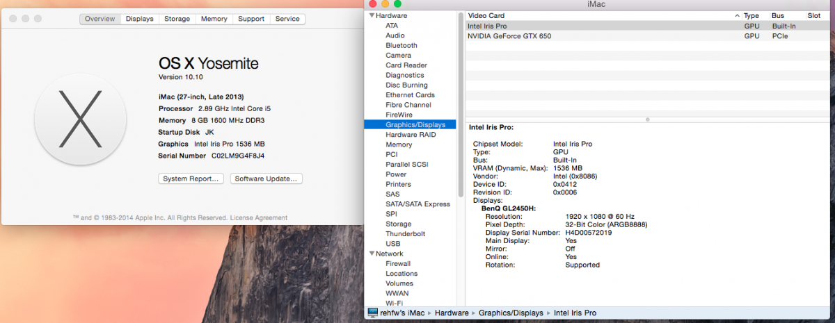

tyufhl Posted August 6, 2014 Share Posted August 6, 2014 Hello. In DP4 and DP5 if booted without a monitor, and then connect the monitor, there is no panic and HD4600 fully supported and running . Ioreg attached. (Sorry, I use a translator). rehfw’s iMac (2).zip Link to comment https://www.insanelymac.com/forum/topic/298591-intel-hd-4600-qeci-yosemite/page/9/#findComment-2049081 Share on other sites More sharing options...

tyufhl Posted August 7, 2014 Share Posted August 7, 2014 BiTRiP, I work this way with DVI and with HDMI. Dances began only in DP4, DP3 to work without dancing. Report with DVI attached. Do I understand correctly translated, that you are not working with a DVI? DarwinDumper_2.9.6_AMI_X64_2792_Yos_rehfw.zip Link to comment https://www.insanelymac.com/forum/topic/298591-intel-hd-4600-qeci-yosemite/page/9/#findComment-2049224 Share on other sites More sharing options...

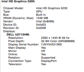

Sridhar Posted August 8, 2014 Share Posted August 8, 2014 Thanks to BITRIP for a possible work around. Have been struggling with the same reboot before login screen on Yosemite, public Beta. For me the DP2, AppleIntelFramebufferAzul solution did not work as well. my model is a Gigabyte BRIX 4770R model with an integrated graphics INTEL HD Graphics 5200. Using the following on config.plist on CLOVER 1. key>ig-platform-id</key> <string>0D220003</string> 2. in Graphics, <key>Intel</key> <true/> Again reboots when i have the mini displayport plugged in. What works for me is when i get to the clover screen, get my yosemite to boot from the volume, plug out the displayport wait patiently for a minute or so thru the boot process and then plug the display port back in. I get full QE/CI and a resolution of 2560*1440 resolution. Have been battling with this for about 3 weeks now. not the most elegant solution but atleast works now. Link to comment https://www.insanelymac.com/forum/topic/298591-intel-hd-4600-qeci-yosemite/page/9/#findComment-2049565 Share on other sites More sharing options...
