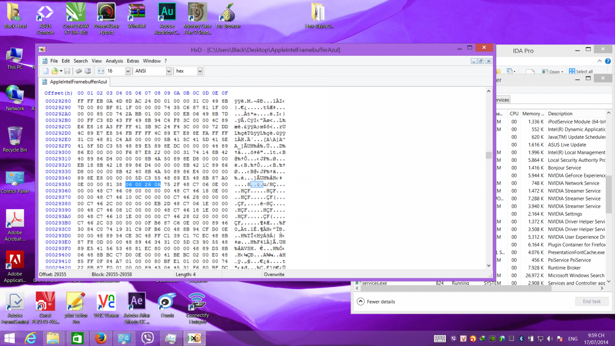

wusa Posted July 17, 2014 Author Share Posted July 17, 2014 I have digged through the AppleIntelFramebufferAzul with HxD and I found something: 15 framebuffers for Intel HD 4400/4600/Iris Pro 5100 and Iris Pro 5200 both mobile and desktop versions are still there. 0 = 000006041 = 0000060c2 = 000016043 = 0000160a4 = 0000160c5 = 000026046 = 0000260a7 = 0000260c8 = 0000260d9 = 0200160410 = 0300220d11 = 0500260a12 = 0600260a13 = 0700260d14 = 0800260a15 = 08002e0a So, I think Apple still support the HD 4600 mobile version but it somehow got messed in the binary. Any other ideas would be welcomed. Link to comment https://www.insanelymac.com/forum/topic/298591-intel-hd-4600-qeci-yosemite/page/5/#findComment-2041438 Share on other sites More sharing options...
MiniHack Posted July 17, 2014 Share Posted July 17, 2014 I have digged through the AppleIntelFramebufferAzul with HxD and I found something: 15 framebuffers for Intel HD 4400/4600/Iris Pro 5100 and Iris Pro 5200 both mobile and desktop versions are still there. 0 = 00000604 1 = 0000060c 2 = 00001604 3 = 0000160a 4 = 0000160c 5 = 00002604 6 = 0000260a 7 = 0000260c 8 = 0000260d 9 = 02001604 10 = 0300220d 11 = 0500260a 12 = 0600260a 13 = 0700260d 14 = 0800260a 15 = 08002e0a So, I think Apple still support the HD 4600 mobile version but it somehow got messed in the binary. Any other ideas would be welcomed. I imagine this won't work, but have you tried a simple find/replace to insert the previously working buffer from 10.9.4 and copy it over one of the other new frame buffers……e.g. write over one of the Iris Pro frame buffers? Of course, it will probably result in a KP but might be interesting (!). Link to comment https://www.insanelymac.com/forum/topic/298591-intel-hd-4600-qeci-yosemite/page/5/#findComment-2041442 Share on other sites More sharing options...

wusa Posted July 18, 2014 Author Share Posted July 18, 2014 I imagine this won't work, but have you tried a simple find/replace to insert the previously working buffer from 10.9.4 and copy it over one of the other new frame buffers……e.g. write over one of the Iris Pro frame buffers? Of course, it will probably result in a KP but might be interesting (!). Hmm, I have digged through the 10.9.4 AppleIntelFramebufferAzul, the 15 Framebuffers are still there, the same encoding and the same letters. For the Device ID, I have digged through the 10.9.4 and the 10.10 DP3 AppleIntelFramebufferAzul and I found that, only the device id of the Intel HD Graphics 4600 (Desktop version - the 0x04128086) and Intel HD Graphics 5000 Mobile and Intel Iris Pro Graphics 5100/5200 Mobile Version are present in there. Any other ideas would be really appreciated Link to comment https://www.insanelymac.com/forum/topic/298591-intel-hd-4600-qeci-yosemite/page/5/#findComment-2041684 Share on other sites More sharing options...
jsl Posted July 19, 2014 Share Posted July 19, 2014 Hmm, I have digged through the 10.9.4 AppleIntelFramebufferAzul, the 15 Framebuffers are still there, the same encoding and the same letters. For the Device ID, I have digged through the 10.9.4 and the 10.10 DP3 AppleIntelFramebufferAzul and I found that, only the device id of the Intel HD Graphics 4600 (Desktop version - the 0x04128086) and Intel HD Graphics 5000 Mobile and Intel Iris Pro Graphics 5100/5200 Mobile Version are present in there. Any other ideas would be really appreciated Up to now the only working AppleIntelFramebufferAzul and AppleIntelHDGraphics5000 kext for Asus G750JZ laptop's Intel HD4600 mobile are from 10.9.1. Even in 10.9.4 I must rollback to 10.9.1 version, otherwise QE/CI functions are lost. Did you have the similar experience for your laptop in Mavericks ? I have tried to copy 10.9.1 or 10.10DP3 version to 10.10DP1 in vain. Hope someone can find the solution as soon as possible in Yosemite ! Link to comment https://www.insanelymac.com/forum/topic/298591-intel-hd-4600-qeci-yosemite/page/5/#findComment-2041888 Share on other sites More sharing options...

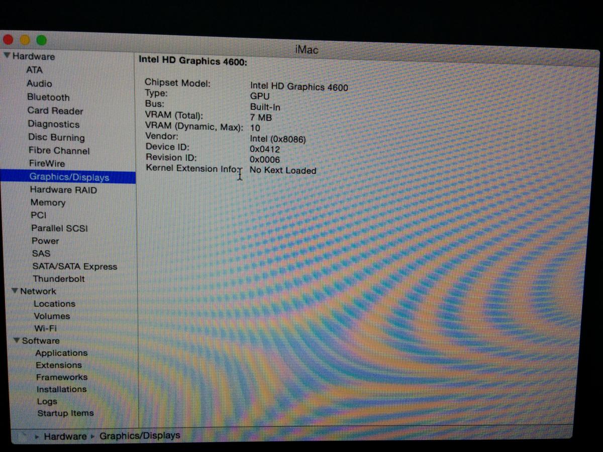

tanjiajun_34 Posted July 20, 2014 Share Posted July 20, 2014 So is HD4600 integrated graphics for desktop working? I managed to get my HD4600 detected but no QE/CI.... In System Information, it shows "Intel HD 4600" but "No kext loaded" and 7mb of ram.... Link to comment https://www.insanelymac.com/forum/topic/298591-intel-hd-4600-qeci-yosemite/page/5/#findComment-2042144 Share on other sites More sharing options...
Pimentel Posted July 20, 2014 Share Posted July 20, 2014 Hello HD 4600 work fine in OSX, with Clover or Chameleon bootloader... try boot with: -f -v GraphicsEnabler=Yes IntelAzulFB=10 And see if work Link to comment https://www.insanelymac.com/forum/topic/298591-intel-hd-4600-qeci-yosemite/page/5/#findComment-2042146 Share on other sites More sharing options...
tanjiajun_34 Posted July 20, 2014 Share Posted July 20, 2014 Hello HD 4600 work fine in OSX, with Clover or Chameleon bootloader... try boot with: -f -v GraphicsEnabler=Yes IntelAzulFB=10 And see if work Same problem for me... Does GraphicsEnaber and IntelAzulFB works with Clover? Link to comment https://www.insanelymac.com/forum/topic/298591-intel-hd-4600-qeci-yosemite/page/5/#findComment-2042149 Share on other sites More sharing options...
musicmic Posted July 20, 2014 Share Posted July 20, 2014 So is HD4600 integrated graphics for desktop working? I managed to get my HD4600 detected but no QE/CI.... In System Information, it shows "Intel HD 4600" but "No kext loaded" and 7mb of ram.... Yes many people have said they were successful. I have been trying for 2 solid weeks myself without success. I have tried uefi boot with clover and with chameleon etc to no avail. I get the same message but it says 3mb of ram. I've tried injection and kext methods. everything. I have used boot flags usingIGPlaformID=0D220003 and IGPDeviceID=0412. In terminal when I "bdmesg' I get it seeing intel HD4600 but no full acceleration, qe/ci.... I really hope I can finally get this working too! What board are you using Tanj? Im using a GA-87N-wifi w/ a i3-4340 Link to comment https://www.insanelymac.com/forum/topic/298591-intel-hd-4600-qeci-yosemite/page/5/#findComment-2042150 Share on other sites More sharing options...
tanjiajun_34 Posted July 20, 2014 Share Posted July 20, 2014 Yes many people have said they were successful. I have been trying for 2 solid weeks myself without success. I have tried uefi boot with clover and with chameleon etc to no avail. I get the same message but it says 3mb of ram. I've tried injection and kext methods. everything. I have used boot flags usingIGPlaformID=0D220003 and IGPDeviceID=0412. In terminal when I "bdmesg' I get it seeing intel HD4600 but no full acceleration, qe/ci.... I really hope I can finally get this working too! What board are you using Tanj? Im using a GA-87N-wifi w/ a i3-4340 ga-h87-d3h with i3 4340 as well. Link to comment https://www.insanelymac.com/forum/topic/298591-intel-hd-4600-qeci-yosemite/page/5/#findComment-2042151 Share on other sites More sharing options...

MiniHack Posted July 20, 2014 Share Posted July 20, 2014 I thought the Appleintelframebufferazul is already suppose to be inside? Anyway just found out something... I used 04128086 as my fake id and that tried to boot up the installation already. My monitor went no signal. Then I changed from dvi to hdmi port. My monitor detects a display and qe ci is working! 1536mb ram as well. But I had to every time wait till my monitor went no signal to do that.... Zzzzz any idea how to solve it? Did you try in bios to select as Primary Graphics your DVI and as secondary your HDMI and ONLY then connecting your HDMI display?? In DP1 and DP3 this is what I have to do for successful boot with QE/CI with my HD 5000. For me, if I want to use HDMI then I select DisplayPort as primary, but if I want to use DisplayPort then I have to select HDMI as primary... 1 Link to comment https://www.insanelymac.com/forum/topic/298591-intel-hd-4600-qeci-yosemite/page/5/#findComment-2042215 Share on other sites More sharing options...
tanjiajun_34 Posted July 20, 2014 Share Posted July 20, 2014 Did you try in bios to select as Primary Graphics your DVI and as secondary your HDMI and ONLY then connecting your HDMI display?? In DP1 and DP3 this is what I have to do for successful boot with QE/CI with my HD 5000. For me, if I want to use HDMI then I select DisplayPort as primary, but if I want to use DisplayPort then I have to select HDMI as primary... Sadly I don't have that option on my bios... Also I am on dp2 and this no signal problem still occur... Zzz 1 Link to comment https://www.insanelymac.com/forum/topic/298591-intel-hd-4600-qeci-yosemite/page/5/#findComment-2042249 Share on other sites More sharing options...
