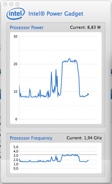

p.s. Take a look at this MSR
IA32_ENERGY_PERF_BIAS......(0x1B0)
When that isn't set to 1 then more Apple p-states will be reached.
Interesting idea!
I tested but get no result.
Jun  8 10:50:15 iMac kernel[0]: MSRDumper CoreMulti(16)
Jun  8 10:50:15 iMac kernel[0]: MSRDumper PStatesReached: 16 33
Jun  8 10:50:15 iMac kernel[0]: MSRDumper CoreMulti(33)
Jun  8 10:50:16 iMac kernel[0]: MSRDumper CoreMulti(16)
Jun  8 10:50:16 iMac kernel[0]: MSRDumper PStatesReached: 16 33
