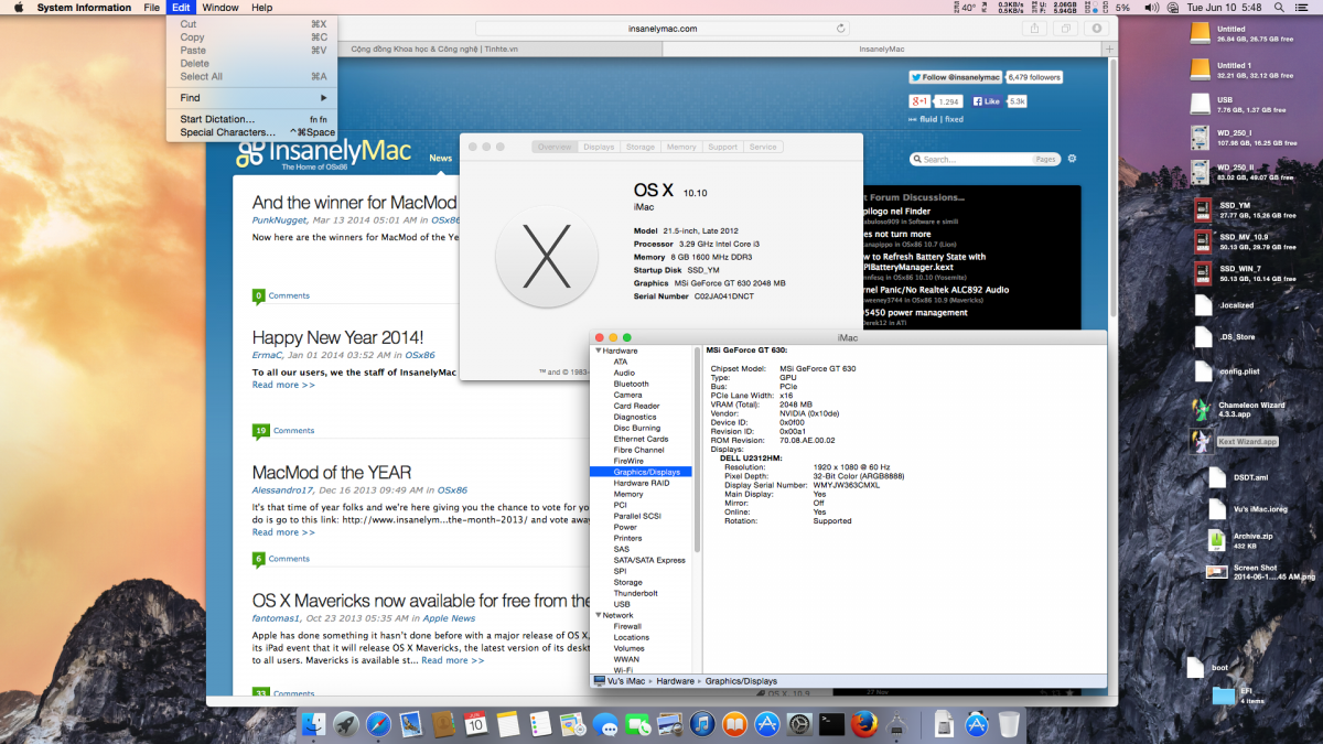

I had a problem with MSI Geforce 630 GT 2GB DDR3 (0F00:1DE0), in mavericks it had full VRAM 2048MB but in YM it has only 1024MB, i was tried with R2703, it has only 1024MB.
Fix your config.plist
Inject>   (missing >)
   ATI
   false/>
   Intel
   NVidia
If it still detects wrong VRAM, set
VRAM
2048

I will try again with solved missing ">" for end line GraphicsInject and Inject. I want Inject Ati with FBName Lotus for HD6670 when i replace 630GT by 6670, if has problem i will false for Ati.
Thanks!
Solved with missing ">" in end 2 line.

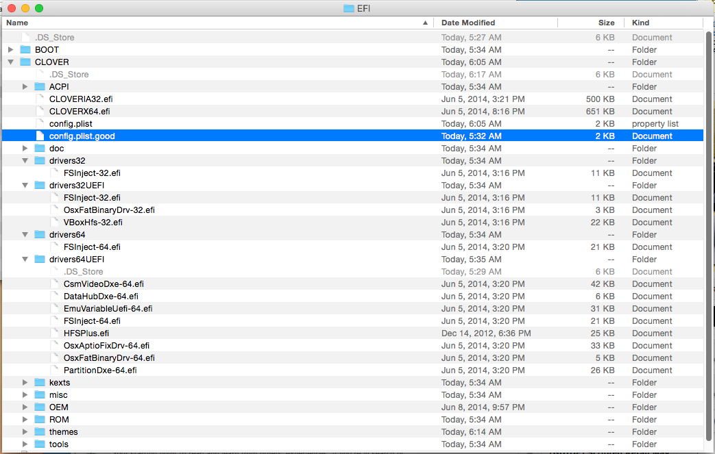

Now i have more problem with Clover boot after solved Graphics.

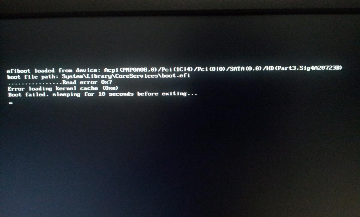

My USB is GPT it have 2 part EFI(diskXs1) and Install (diskXs2). I was install Clover to diskXs2 to install and boot. After finished graphics, i was mount EFI part and move folder EFI on diskXs2 to diskXs1. My UEFI boot to EFI partition when i chose any part o boot os all error. I reboot with USB diskXs2 same error. i much turnoff and disconnect power cable and reboot with diskXs2 then ok.
I just change from Chameleon to Clover.
I attach all file from EFI on diskXs2 and error screen when boot with EFI.
try to boot with -s and rebuild the kernel cache ( there are instruction in this topic and others ), if that can't be booted try using -x and it will rebuild the cache on its own if it can boot. when you try to reboot after using -x the system now rebuilds the cache again so it should pass that error.
Thanks to joe75, i was success with -s to rebuild cache and can boot from EFI partition to OS on other HDD. I will change from Chameleon to Clover.
