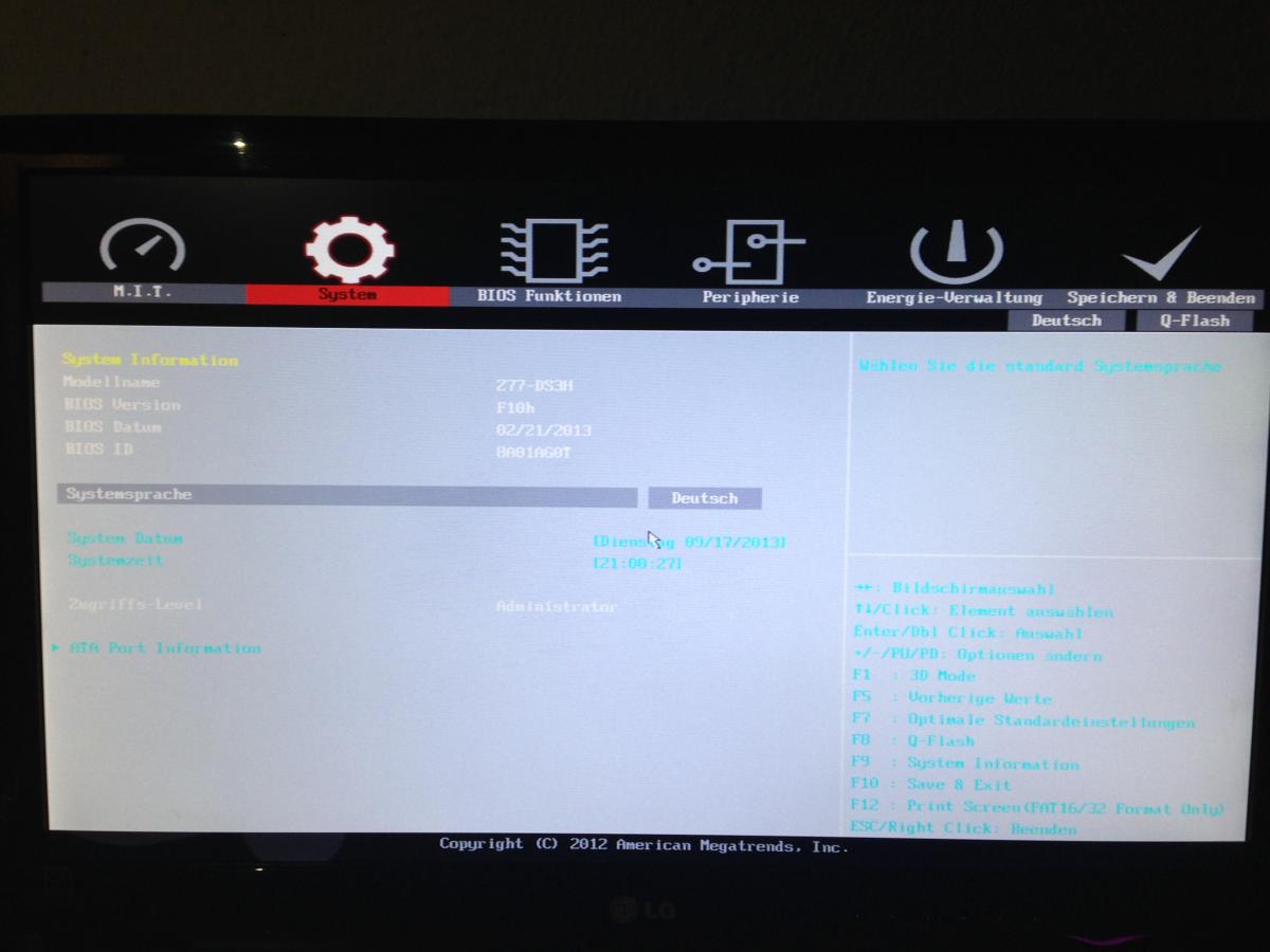

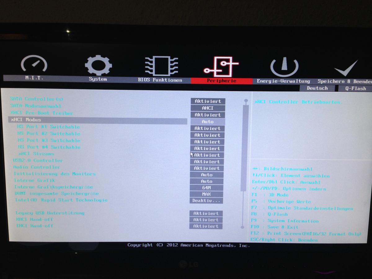

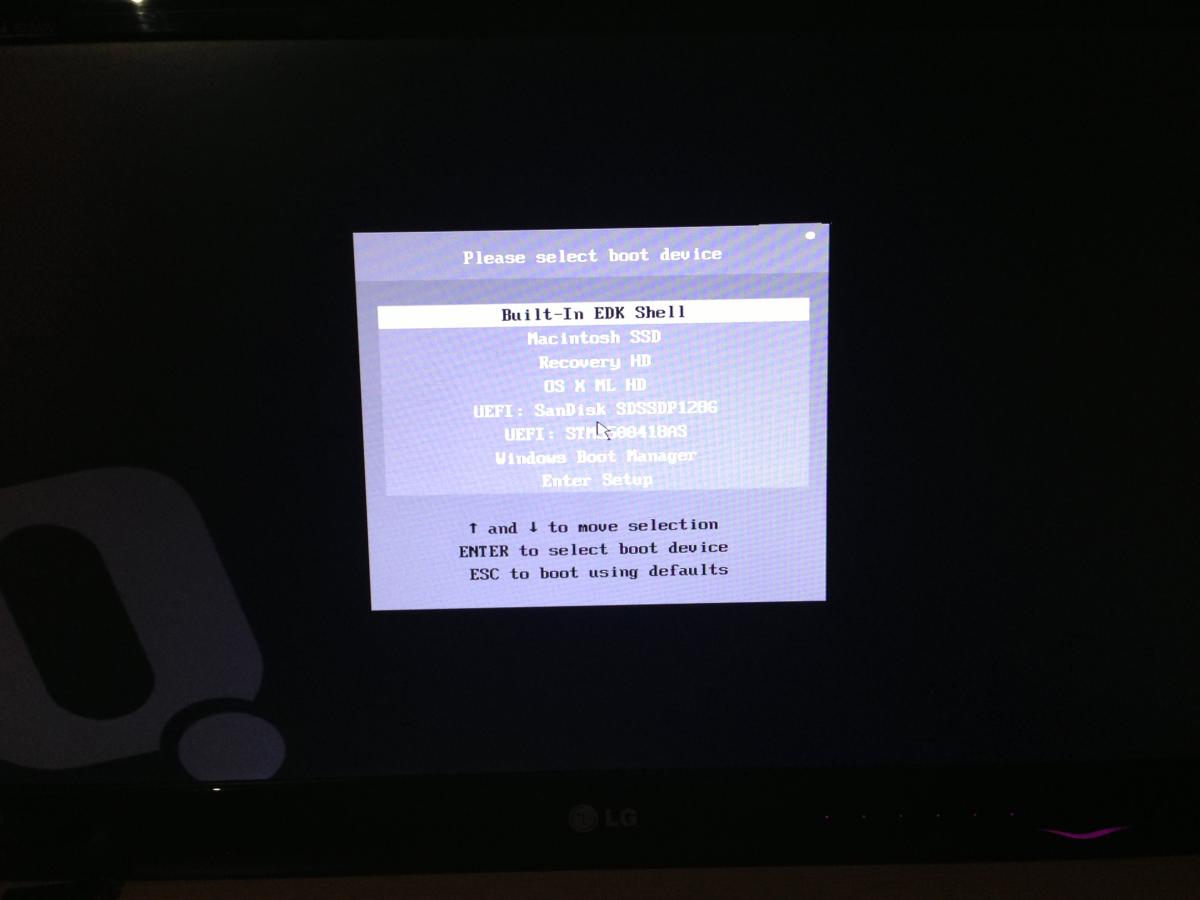

hi all
get Bios GUI from QOU Successfully!!
just replaced this module EFCB2FDB-0662-4A59-A5D7-03033EA97CAE.
Good Hack
sorry for the bad quality
Thx for reporting this,but i think thats that really not nice,its a downgrade.
Colors are really ugly.
But that only my opinion.
I'll try tonight. Busy working right now
nothing, just replace the GTSE Module. ^_^
