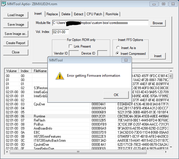

I get an error when trying to insert Core_DXE compressed into the ROM. I saw someone at projectosx had the same problem. Is it solved or is this only possible on newer Bios.
Gigabyte z68 Uefi beta Bios : https://www.dropbox.com/s/hhh1abfzyjsp0xi/Z8MXUD2H.rom
I tried with MMTool for Aptio but I see no problem, only one thing:
the compressed size after deleting and reinserting doesn't change, due to the fact that Core_Dxe is already compressed.

@BonBon6 I extract as uncompressed and try to reinsert as compressed and get this error:
it can be done if u make more space by deleting filesystem driver or,and ipv6 modules that are totally unneeded.
i try it and it works.
but when i try to insert those modules again into firmware then again get same error.
same behavior using phoenixtool but phoenix tool report that there are no free space to manage modules..
maybe to try extract more modules uncompresed then delete those and try to insert compressed.
will try and report if have sucess.
no sucess,try to fix this bios with help of MDL experts like andyp or yen
