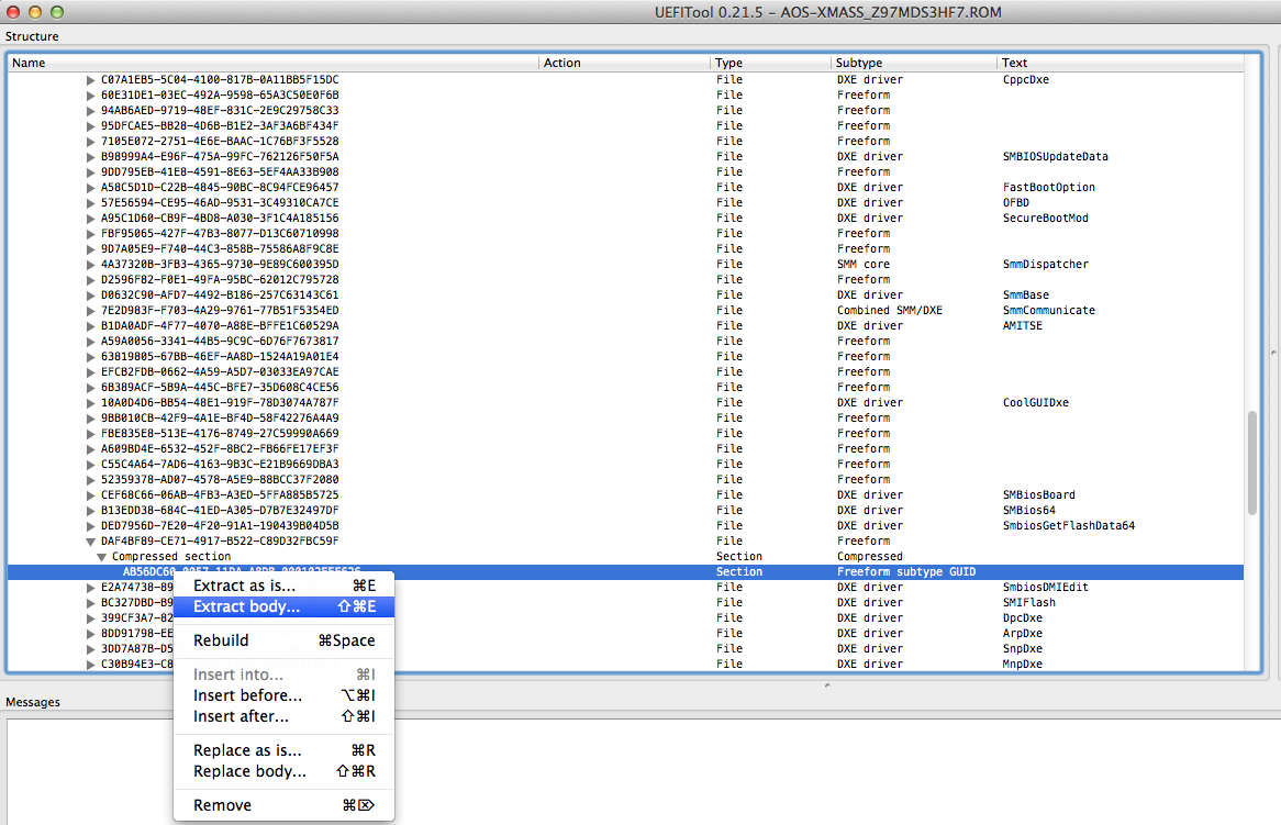

                                          THIS IS ONLY FOR 9 SERIES MOTHERBOARDS
Here's a guide for changing SMBios values on the ROM, i used only Hex Fiend, UEFITool and working SMBios values! There's two parts in this guide, extracting from the ROM the SMBios file and opening it with good Hex editor be the first, the second need you to follow FredWst post to complete the work!
1 - You need to open your ROM using UEFITool, finding and Extracting Body of this Module:

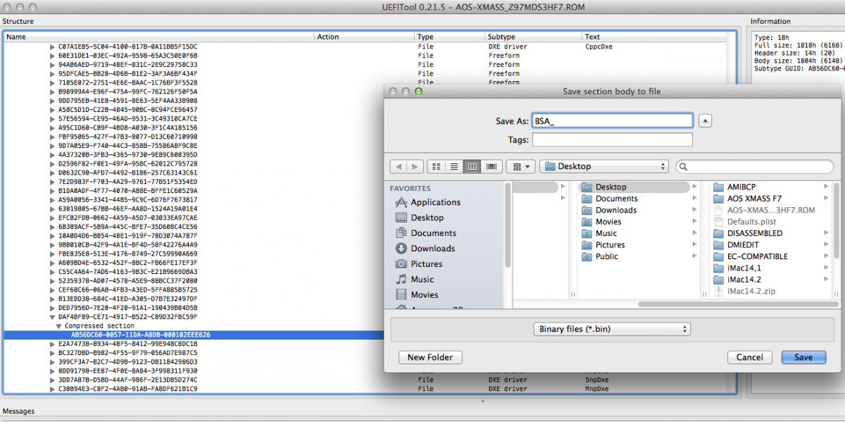

2 - Now you need to save the Body as UEFITool show you "BIN", i've named it with the exact name, because it have an extension in the Volume 3

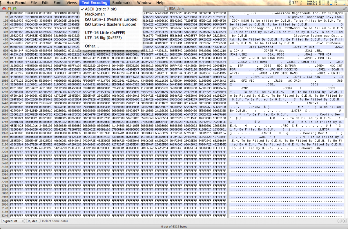

3 - Now open the extracted BIN file with a good Hex editor and change the Text Encoding like in this screenshot.
Note: because some doesn't worked perfectly, this is why i choose Hex Fiend.

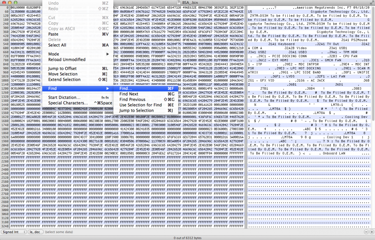

4 - Now use the Find "option" from menu bar and select the first thing that need to be changed

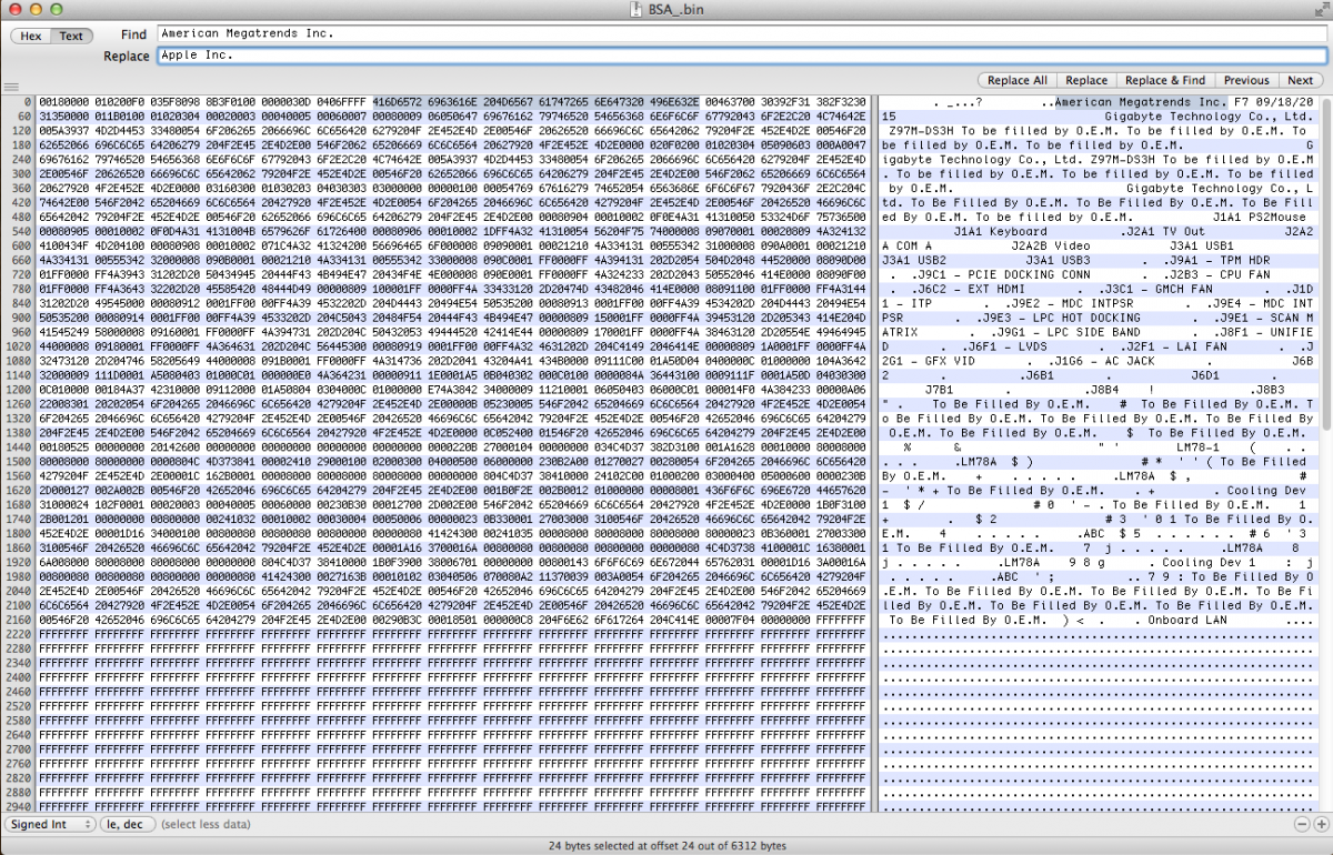

5 - Now enter in replace case the correct infos that you want from your "Exact SMBios on the OzmosisDefaults", they should be the same!

After that, click on save "only" not Save as! And Replace the Original body of the module with the one you just saved.

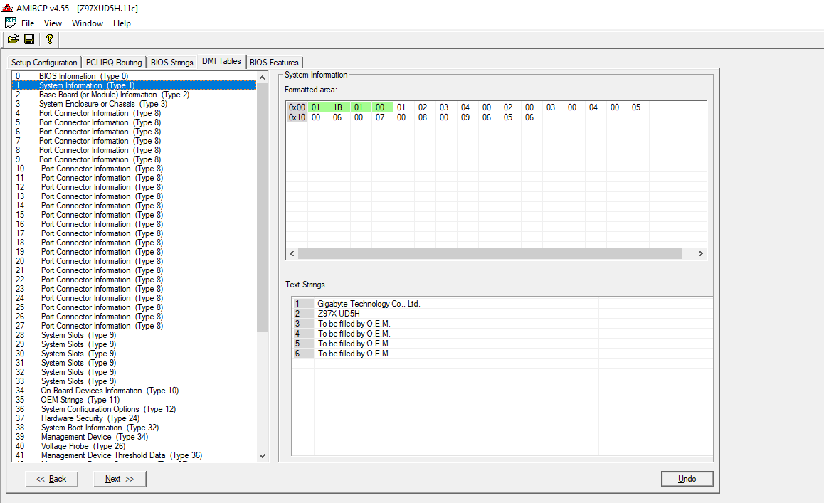

There are simpler ways to do this
for example use AMIBCP to edit your DMI
though I don't see any reason for this
Though you forgot to read the BIG RED WORDS and my previous post when i was trying to do it with this simple way you called! This way work only with 7 and 8 series, with the 9 SERIES AMBCP crash when you save the file  :thumbsup_anim:
I've tried all AMBCP versions on the net, no one worked for my Z97M-DS3H! I prefer to stay on this method, as i know exactly what i do, like the stone age, manually Hhhhhhhhh
Edited by ammoune78
There is also DMIedit.
Excuse me my friend, but you can try it by downloading the rom file from GIGABYTE Z97M-DS3H and try it, i'm sure that you will finally have the same result like me, you can do any modification that you want, the problem is when you'll have to save that ROM file the application will crash by it self!
Result, modifications are lost
