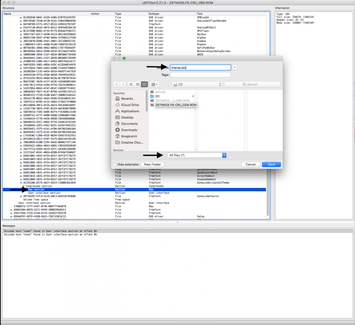

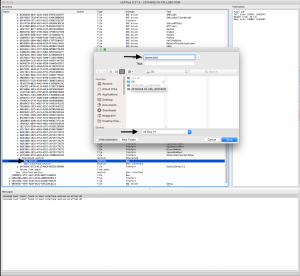

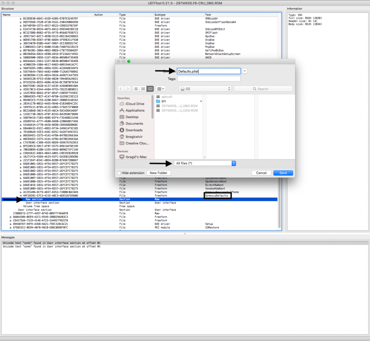

xpamamadeus Posted December 7, 2017 Author Share Posted December 7, 2017 THIS IS ONLY FOR 9 SERIES MOTHERBOARDS Here's a guide for changing SMBios values on the ROM, i used only Hex Fiend, UEFITool and working SMBios values! There's two parts in this guide, extracting from the ROM the SMBios file and opening it with good Hex editor be the first, the second need you to follow FredWst post to complete the work! 1 - You need to open your ROM using UEFITool, finding and Extracting Body of this Module: Extract.png 2 - Now you need to save the Body as UEFITool show you "BIN", i've named it with the exact name, because it have an extension in the Volume 3 Save.png 3 - Now open the extracted BIN file with a good Hex editor and change the Text Encoding like in this screenshot. Note: because some doesn't worked perfectly, this is why i choose Hex Fiend. Text Encoding.png 4 - Now use the Find "option" from menu bar and select the first thing that need to be changed Find.png 5 - Now enter in replace case the correct infos that you want from your "Exact SMBios on the OzmosisDefaults", they should be the same! Replace.png Now what first thing to put and the upcoming one, follow the post #857 by FredWst After that, click on save "only" not Save as! And Replace the Original body of the module with the one you just saved. Hi. Nice one for z97. I did same for in time of z77 but forgot what we get with this,i even rebrand memory modules. U can do it with Thaiphoon Burner. 1 Link to comment Share on other sites More sharing options...

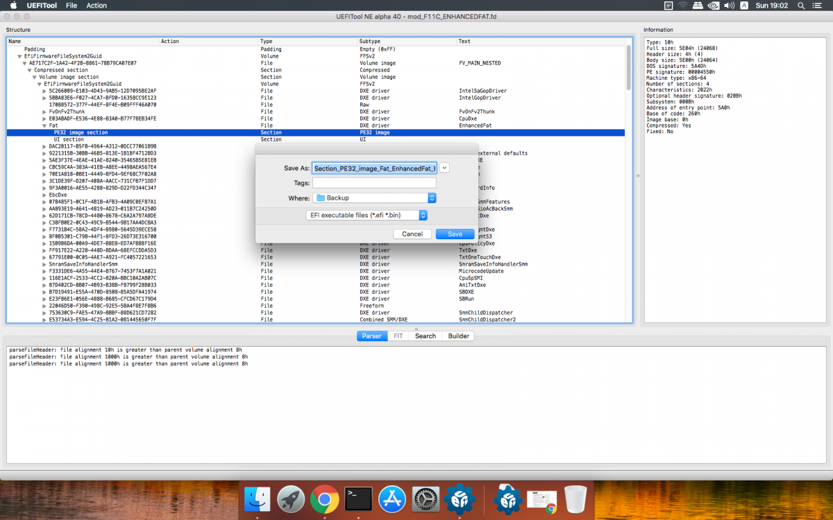

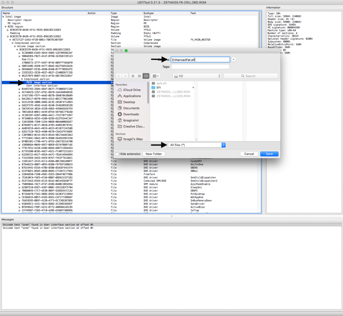

WinstonAce Posted December 10, 2017 Share Posted December 10, 2017 I can upload them later today But if you have them as ffs in bios, just extract body with uefitool. Sent from my ONEPLUS A5000 using Tapatalk Link to comment Share on other sites More sharing options...
ammoune78 Posted December 10, 2017 Share Posted December 10, 2017 extract body as: All files then xxxxx.efi ? Link to comment Share on other sites More sharing options...
WinstonAce Posted December 10, 2017 Share Posted December 10, 2017 Like this I will upload the files shortly (except Btrfs which I don't use) 1 Link to comment Share on other sites More sharing options...

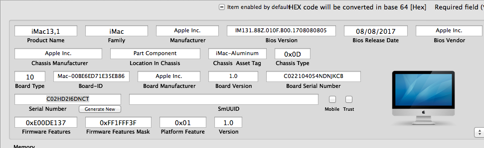

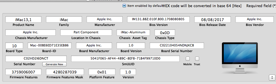

ammoune78 Posted December 11, 2017 Share Posted December 11, 2017 iMac 13,2 FirmwareFeatures: e001f537 & FirmwareFeaturesMask: e003ff37 Then it will be as FirmwareFeatures: 37f501e0 & FirmwareFeaturesMask: 37ff03e0 Then convert it to integer "FirmwareFeatures: 938 803 680 & FirmwareFeaturesMask: 939 459 552" this is what you have to put in the plist as number Go to clover configurator and generate new serial for your board as iMac 13,2 copy paste the things on your OzmosisDefaults.Plist 2 Link to comment Share on other sites More sharing options...

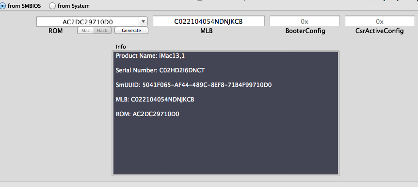

ammoune78 Posted December 11, 2017 Share Posted December 11, 2017 (edited) Click on SMBios once you're in look at the big ? in it's right side there's an (up down) button click on it an choose the Mac you want, click as many as you want on Generate button under serial number section, now just copy the the serials and past them into the proper case in the OzmosisDefaults! You don't have to save the config.plist at all, you'll just use it for Mac serial generating code I like this one: https://github.com/al3xtjames/MacGen My MAN the goal here is to simplify life for others, not to complicate it, if you look at what lexb said, 4 years with no hack, it's more clearer. And yes i like it and TheRacerMaster also i forgot excuse , but my Hack will never be an Mac , i juste use working one no more! Edited December 11, 2017 by ammoune78 1 Link to comment Share on other sites More sharing options...

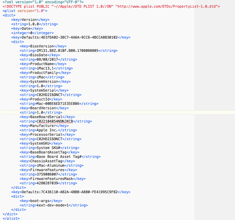

lexb Posted December 11, 2017 Share Posted December 11, 2017 Okay, thanks. So, I have added those details to the OsmosisDefaults.plist. I attached an image showing what it now looks like. Am I supposed to now place that on the hidden EFI partition on the OZ folder then attempt to update the mac to the High Sierra OS? Also, I hope you get good sleep. I appreciate your time. Link to comment Share on other sites More sharing options...

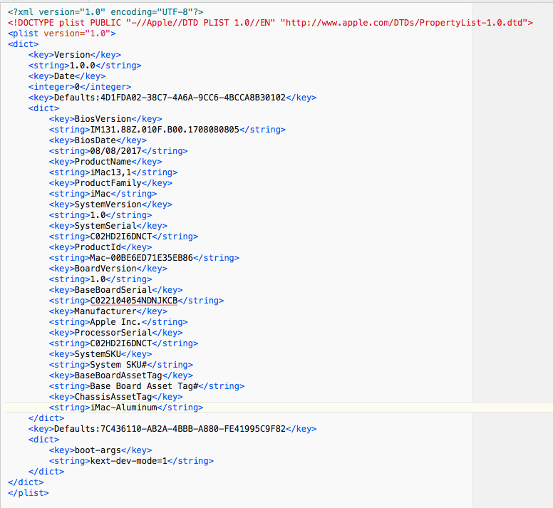

ammoune78 Posted December 11, 2017 Share Posted December 11, 2017 it's not ready yet, you just have to look at the example i gives in the post last day: <?xml version="1.0" encoding="UTF-8"?> <!DOCTYPE plist PUBLIC "-//Apple//DTD PLIST 1.0//EN" "http://www.apple.com/DTDs/PropertyList-1.0.dtd"> <plist version="1.0"> <dict> <key>Defaults:1F8E0C02-58A9-4E34-AE22-2B63745FA101</key> <dict> <key>AAPL,ig-platform-id</key> <integer>220332035</integer> <key>AtiFramebuffer</key> <string>Hamachi</string> <key>BootEntryTemplate</key> <string>$label</string> <key>DarwinCoreStorageTemplate</key> <string>$label</string> <key>DarwinDiskTemplate</key> <string>$label</string> <key>DarwinRecoveryDiskTemplate</key> <string>$label ($platform.$major.$minor)</string> <key>DisableAtiInjection</key> <false/> <key>DisableIntelInjection</key> <false/> <key>DisableNvidaInjection</key> <true/> <key>DisableVoodooHda</key> <true/> <key>LinuxDiskOptionTemplate</key> <string>initrd=$initfs root=UUID=$uuid ro</string> <key>LinuxDiskTemplate</key> <string>$label $build</string> <key>LinuxRescueDiskTemplate</key> <string>$label Rescue</string> <key>LinuxRescueOptionTemplate</key> <string>initrd=$initfs root=UUID=$uuid ro</string> <key>TimeOut</key> <integer>5</integer> <key>UserInterface</key> <true/> SMBios between them <key>Defaults:7C436110-AB2A-4BBB-A880-FE41995C9F82</key> <dict> <key>boot-args</key> <string></string> <key>csr-active-config</key> <integer>127</integer> </dict> <key>Timestamp</key> <integer>0</integer> <key>Version</key> <string>1.0.1</string> CloverConfigurator\SystemParameters=>Generate NEW:custom UUID Copy it and paste it over: SMBios\SmUUID Copy from there Board Serial Number Now go to RT Variables and paste it over MLB, Now click generate, you will have new ROM to put on ROM in OzmosisDefaults Same thing for MLB : BaseBoardSerial 1 Link to comment Share on other sites More sharing options...

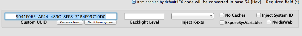

lexb Posted December 11, 2017 Share Posted December 11, 2017 Okay, I went to SystemParameters=>Generate NEW:custom UUID and hit generate.I went to SMBios and pasted that UUID into the SmUUID field.I copied the Board Serial Number and went to RT Variables and pasted the Board Serial Number into the MLB field.I got the ROM number and BaseBoardSerialI assume BaseBoardSerial = BoardSerialNumber?I ask because some of the entries that Clover Configurator creates for it’s plist are named differently than on the OzmosisDefaults.plist you provided.I'm not sure where to put the ROM entry, just create an entry like this?: <key>ROM</key> <data>rC3ClxDQ</data> Also, am I supposed to paste the Custom UUID (5041F065-AF44-489C-8EF8-71B4F99710D0) anywhere in the OzmosisDefaults.plist?Lastly, is also the two following entries in the sample OzmosisDefaults.plist you provided that I dont have the data for: <key>ProductId</key> <string>xxxxxxxxxxxxxxxx</string> <key>HardwareAddress</key> <string>xx:xx:xx:xx:xx:xx</string> Along with the top section having empty entries like the following: "AAPL,ig-platform-id" and "AtiFrameBuffer" etc…------Here is what I have so far: <?xml version="1.0" encoding="UTF-8"?> <!DOCTYPE plist PUBLIC "-//Apple//DTD PLIST 1.0//EN" "http://www.apple.com/DTDs/PropertyList-1.0.dtd"> <plist version="1.0"> <dict> <key>Defaults:1F8E0C02-58A9-4E34-AE22-2B63745FA101</key> <dict> <key>AAPL,ig-platform-id</key> <integer>xxxxxxxx</integer> <key>AtiFramebuffer</key> <string>xxxxxxxx</string> <key>BootEntryTemplate</key> <string>$label</string> <key>DarwinCoreStorageTemplate</key> <string>$label</string> <key>DarwinDiskTemplate</key> <string>$label</string> <key>DarwinRecoveryDiskTemplate</key> <string>$label ($platform.$major.$minor)</string> <key>DisableAtiInjection</key> <false/> <key>DisableIntelInjection</key> <false/> <key>DisableNvidaInjection</key> <true/> <key>DisableVoodooHda</key> <true/> <key>LinuxDiskOptionTemplate</key> <string>initrd=$initfs root=UUID=$uuid ro</string> <key>LinuxDiskTemplate</key> <string>$label $build</string> <key>LinuxRescueDiskTemplate</key> <string>$label Rescue</string> <key>LinuxRescueOptionTemplate</key> <string>initrd=$initfs root=UUID=$uuid ro</string> <key>TimeOut</key> <integer>5</integer> <key>UserInterface</key> <true/> </dict> <key>Defaults:4D1FDA02-38C7-4A6A-9CC6-4BCCA8B30102</key> <dict> <key>BaseBoardAssetTag</key> <string>Base Board Asset Tag#</string> <key>BaseBoardSerial</key> <string>C022104054NDNJKCB</string> <key>BiosReleaseDate</key> <string>08/08/2017</string> <key>BiosVersion</key> <string>IM131.88Z.010F.B00.1708080805</string> <key>BoardType</key> <integer>10</integer> <key>ChassisAssetTag</key> <string>iMac-Aluminum</string> <key>EnclosureType</key> <integer>13</integer> <key>FirmwareFeatures</key> <integer>3759006007</integer> <key>FirmwareFeaturesMask</key> <integer>4280287039</integer> <key>FirmwareVendor</key> <string>Apple</string> <key>HardwareAddress</key> <string>xx:xx:xx:xx:xx:xx</string> <key>Manufacturer</key> <string>Apple Inc.</string> <key>ProductFamily</key> <string>iMac</string> <key>ProductId</key> <string>xxxxxxxxxxxxxxxx</string> <key>ProductName</key> <string>iMac13,1</string> <key>SystemSKU</key> <string>System SKU#</string> <key>SystemSerial</key> <string>C02HD2I6DNCT</string> <key>SystemVersion</key> <string>1.0</string> </dict> <key>Defaults:7C436110-AB2A-4BBB-A880-FE41995C9F82</key> <dict> <key>boot-args</key> <string>darkwake=0</string> <key>csr-active-config</key> <integer>127</integer> </dict> <key>Timestamp</key> <integer>0</integer> <key>Version</key> <string>1.0.1</string> </dict> </plist> Thanks again, of course. 1 Link to comment Share on other sites More sharing options...
ammoune78 Posted December 11, 2017 Share Posted December 11, 2017 For ATI you have to delete the Framebuffer, disable AtiInjection?True, disable IntelInjection? False, diss-Nvid?True, DisableVoodFalse if you plan to use it, and True if not! AAPL,ig-patform-id: is for Intel Graphics HD xxxx search for the one matched with your CPU convert it as decimal and put it there! You did the JOB For: ROM: Yes Prod: Yes Hard: Yes Link to comment Share on other sites More sharing options...
