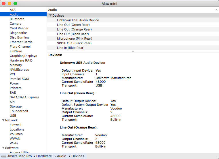

Tosk Posted December 18, 2016 Share Posted December 18, 2016 Tosk, I updated to your BIOS, and I can download Sierra now, and all is fine, except I lost sound. Not sure how to get it back. Suggestions? I used the audio package on the wiki I believe. I don't use this board regularly yet and I don't remember what I did for audio, but it definitely worked. I don't use VoodooHDA because I've had bad experiences with it in the past and prefer an AppleHDA solution. Sent from my Pixel XL using Tapatalk Link to comment https://www.insanelymac.com/forum/topic/285920-os-x-compatible-motherboard-quo/page/124/#findComment-2336400 Share on other sites More sharing options...
toastie Posted December 19, 2016 Share Posted December 19, 2016 I used the audio package on the wiki I believe. I don't use this board regularly yet and I don't remember what I did for audio, but it definitely worked. I don't use VoodooHDA because I've had bad experiences with it in the past and prefer an AppleHDA solution. Sent from my Pixel XL using Tapatalk There definitely was some weirdness going on, as it also wouldn't load the Defaults.plist I created, where I had DisableVoodooHDA set to false. I reverted back to my previous BIOS, then flashed the new one. I had to re-enable VoodooHDA in NVRAM and all is working now, including properly loading my Defaults.plist. I'm backing up my system before I upgrade to Sierra, but I'm expecting it should go OK now. 1 Link to comment https://www.insanelymac.com/forum/topic/285920-os-x-compatible-motherboard-quo/page/124/#findComment-2336715 Share on other sites More sharing options...
IronManJFF Posted December 19, 2016 Share Posted December 19, 2016 If my memory is correct you will not be able to inject VoodooHDA from BIOS or EFI under MacOS Sierra. You will have to install it in /Library/Extensions if you want to use it. 1 Link to comment https://www.insanelymac.com/forum/topic/285920-os-x-compatible-motherboard-quo/page/124/#findComment-2336939 Share on other sites More sharing options...

elviejo Posted December 20, 2016 Share Posted December 20, 2016 If my memory is correct you will not be able to inject VoodooHDA from BIOS or EFI under MacOS Sierra. You will have to install it in /Library/Extensions if you want to use it. VoodooHDA works from BIOS perfectly with H20.167x-MASS if you don't disable it on nvram. On some rare cases you need to reboot the computer a second time after installation to get it going. Link to comment https://www.insanelymac.com/forum/topic/285920-os-x-compatible-motherboard-quo/page/124/#findComment-2337132 Share on other sites More sharing options...
IronManJFF Posted December 20, 2016 Share Posted December 20, 2016 I stand corrected thanks Jo. Link to comment https://www.insanelymac.com/forum/topic/285920-os-x-compatible-motherboard-quo/page/124/#findComment-2337341 Share on other sites More sharing options...

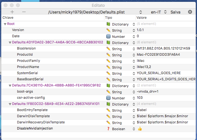

IronManJFF Posted December 24, 2016 Share Posted December 24, 2016 rootless=0 does nothing to properly disable SIP in Defaults.plist (in bold) : <key>Defaults:7C436110-AB2A-4BBB-A880-FE41995C9F82</key> <dict><key>boot-args</key><string>-v nvda_drv=1</string><key>csr-active-config</key><integer>103</integer></dict> Link to comment https://www.insanelymac.com/forum/topic/285920-os-x-compatible-motherboard-quo/page/124/#findComment-2338925 Share on other sites More sharing options...
Micky1979 Posted December 24, 2016 Share Posted December 24, 2016 Any of you has a full (very full) "Defaults.plist" as example? 1 Link to comment https://www.insanelymac.com/forum/topic/285920-os-x-compatible-motherboard-quo/page/124/#findComment-2338986 Share on other sites More sharing options...

IronManJFF Posted December 24, 2016 Share Posted December 24, 2016 Here my whole Defaults.plist iMac13,2 as it lives in the EFI partiton <?xml version="1.0" encoding="UTF-8"?> <!DOCTYPE plist PUBLIC "-//Apple//DTD PLIST 1.0//EN" "http://www.apple.com/DTDs/PropertyList-1.0.dtd"> <plist version="1.0"> <dict> <key>Version</key> <string>1.0.1</string> <key>Date</key> <integer>0</integer> <key>Defaults:4D1FDA02-38C7-4A6A-9CC6-4BCCA8B30102</key> <dict> <key>BiosVersion</key> <string>IM131.88Z.010A.B05.1210121459</string> <key>ProductId</key> <string>Mac-FC02E91DDD3FA6A4</string> <key>ProductFamily</key> <string>iMac</string> <key>ProductName</key> <string>iMac13,2</string> <key>SystemSerial</key> <string>YOUR_SERIAL_GOES_HERE</string> <key>BaseBoardSerial</key> <string>YOUR_SERIAL+5_DIGITS_GOES_HERE</string> </dict> <key>Defaults:7C436110-AB2A-4BBB-A880-FE41995C9F82</key> <dict> <key>boot-args</key> <string>-v nvda_drv=1</string> <key>csr-active-config</key> <integer>103</integer> </dict> <key>Defaults:1F8E0C02-58A9-4E34-AE22-2B63745FA101</key> <dict> <key>BootEntryTemplate</key> <string>$label</string> <key>DarwinDiskTemplate</key> <string>$label $platform.$major.$minor</string> <key>DarwinRecoveryDiskTemplate</key> <string>$label $platform.$major.$minor</string> <key>DisableNvidiaInjection</key> <true/> </dict> </dict></plist> 1 Link to comment https://www.insanelymac.com/forum/topic/285920-os-x-compatible-motherboard-quo/page/124/#findComment-2339240 Share on other sites More sharing options...
Micky1979 Posted December 25, 2016 Share Posted December 25, 2016 Here my whole Defaults.plist iMac13,2 as it lives in the EFI partiton <?xml version="1.0" encoding="UTF-8"?><!DOCTYPE plist PUBLIC "-//Apple//DTD PLIST 1.0//EN" "http://www.apple.com/DTDs/PropertyList-1.0.dtd"><plistversion="1.0"><dict><key>Version</key><string>1.0.1</string><key>Date</key><integer>0</integer><key>Defaults:4D1FDA02-38C7-4A6A-9CC6-4BCCA8B30102</key><dict><key>BiosVersion</key><string>IM131.88Z.010A.B05.1210121459</string><key>ProductId</key><string>Mac-FC02E91DDD3FA6A4</string><key>ProductFamily</key><string>iMac</string><key>ProductName</key><string>iMac13,2</string><key>SystemSerial</key><string>YOUR_SERIAL_GOES_HERE</string><key>BaseBoardSerial</key><string>YOUR_SERIAL+5_DIGITS_GOES_HERE</string></dict><key>Defaults:7C436110-AB2A-4BBB-A880-FE41995C9F82</key><dict><key>boot-args</key><string>-vnvda_drv=1</string><key>csr-active-config</key><integer>103</integer></dict><key>Defaults:1F8E0C02-58A9-4E34-AE22-2B63745FA101</key><dict><key>BootEntryTemplate</key><string>$label</string><key>DarwinDiskTemplate</key><string>$label $platform.$major.$minor</string><key>DarwinRecoveryDiskTemplate</key><string>$label $platform.$major.$minor</string><key>DisableNvidiaInjection</key><true/></dict></dict></plist> Thanks (there's an error at line 3 "<plistversion="1.0">" should be "<plist version="1.0">" ) is "Defaults:1F8E0C02-58A9-4E34-AE22-2B63745FA101" a partition uuid or a disk uuid? EDIT Merry Christmas to All! 1 Link to comment https://www.insanelymac.com/forum/topic/285920-os-x-compatible-motherboard-quo/page/124/#findComment-2339409 Share on other sites More sharing options...
IronManJFF Posted December 28, 2016 Share Posted December 28, 2016 Thanks (there's an error at line 3 "<plistversion="1.0">" should be "<plist version="1.0">" )Correct, I had pasted from post #3022 but somehow that blank got lost..it also should be "-v nvda_drv=1" and not "-vnvda_drv=1" edited the post #3117. is "Defaults:1F8E0C02-58A9-4E34-AE22-2B63745FA101" a partition uuid or a disk uuid?Actually what this Hex string represents, I do not know. I think they are uuid proprietary to Ozmosis but someone better than me would have to answer this. 1 Link to comment https://www.insanelymac.com/forum/topic/285920-os-x-compatible-motherboard-quo/page/124/#findComment-2340542 Share on other sites More sharing options...
