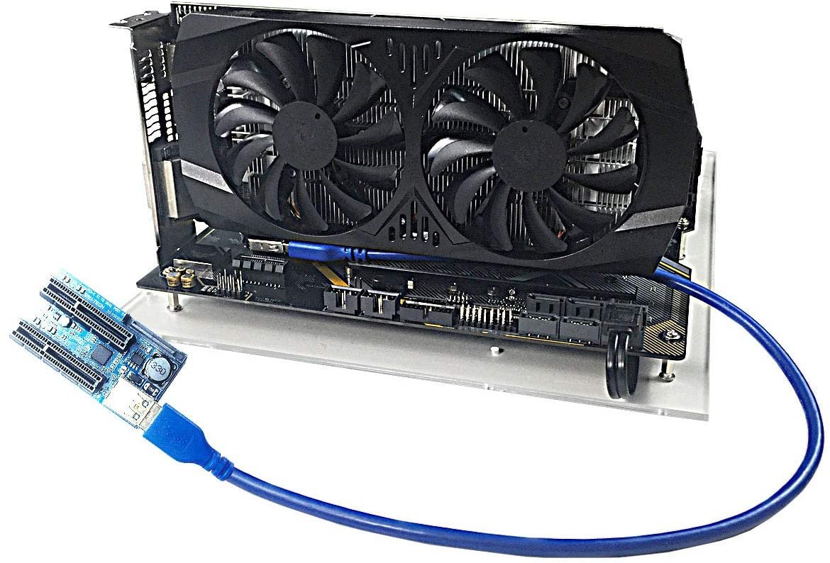

On 1/10/2020 at 7:19 PM, valiant said:
Hmm. OK. I have a similar adapter (although I don't know what card I have in it) but slot 4 doesn't work for me at all, I didn't know about slot 4 slowing down slot 1. The ribbon sounds interesting. Would it be possible to post a photo of the ribbon setup? I've never seen that arrangement.
Thanks.
Hi all. Just a quick feedback about this ribbon. I found another device, way better than the one I had: su-uex105 PCI-E Riser. It allows the connection of two pciex4 size cards to the pciex1 port located underneath the graphic card. I use it to connect two devices ( in my signature ).

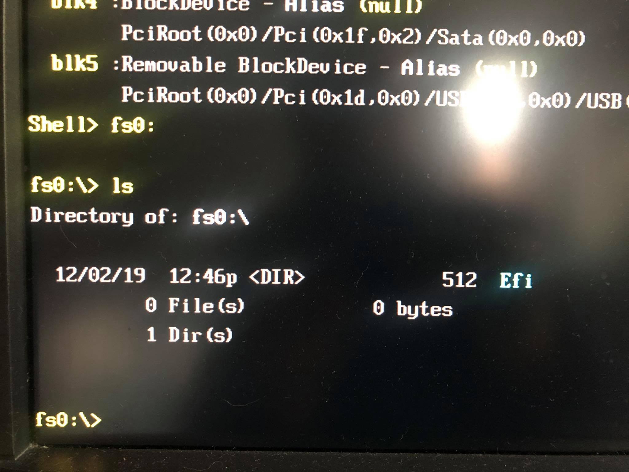

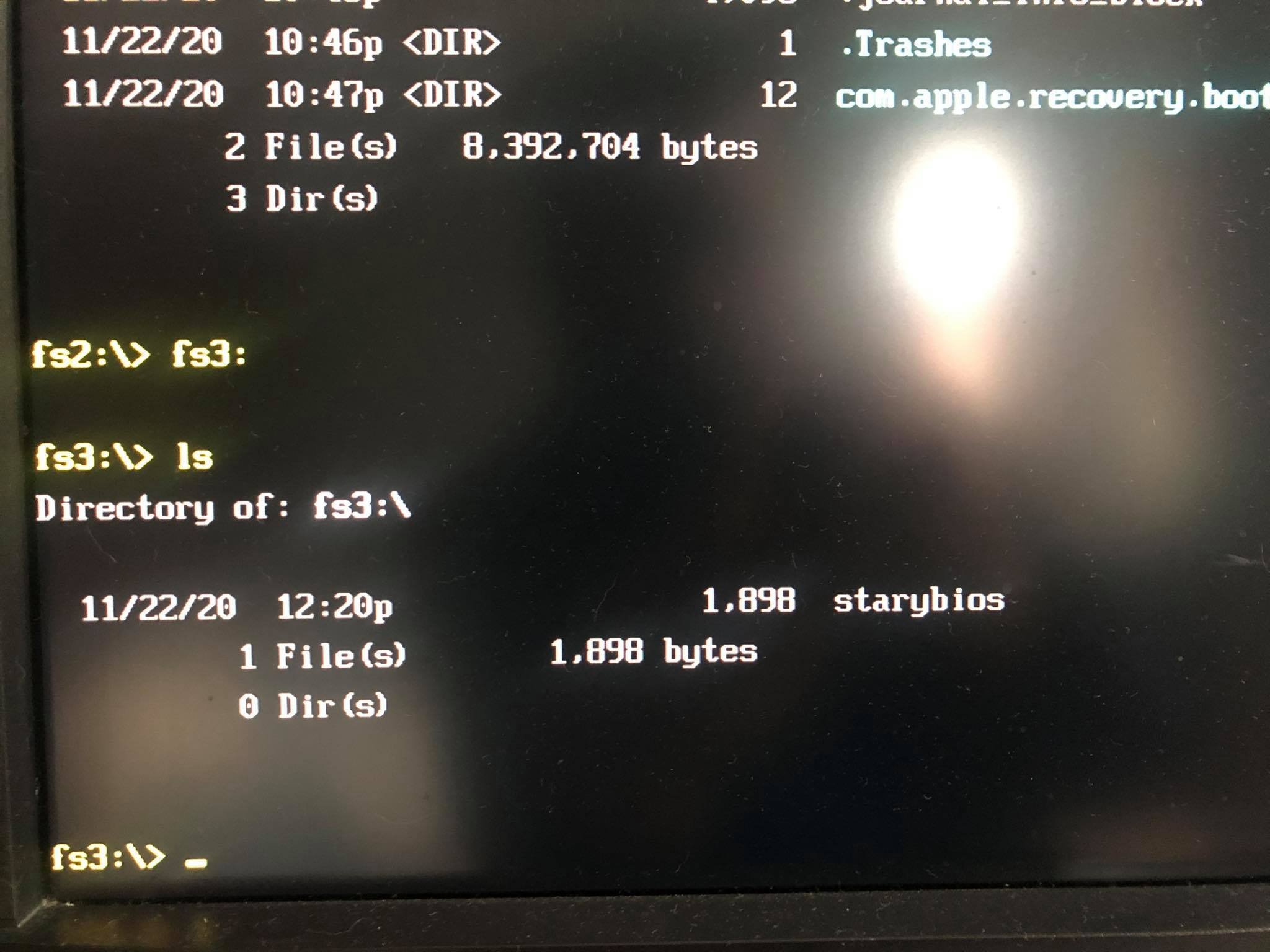

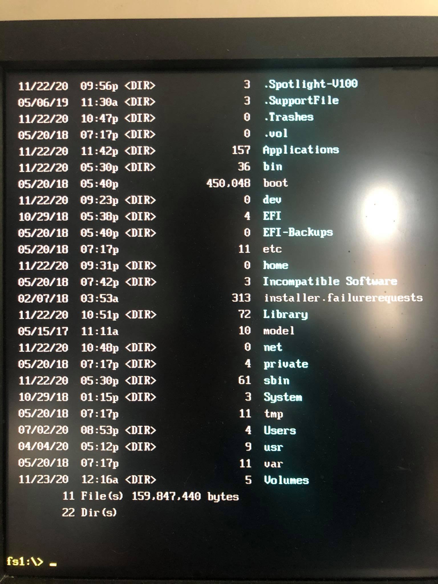

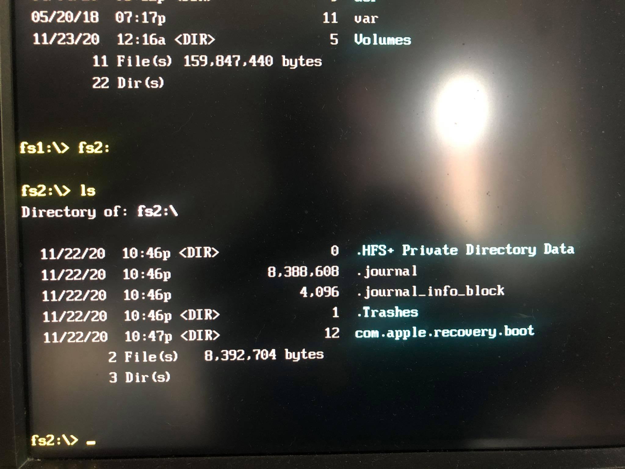

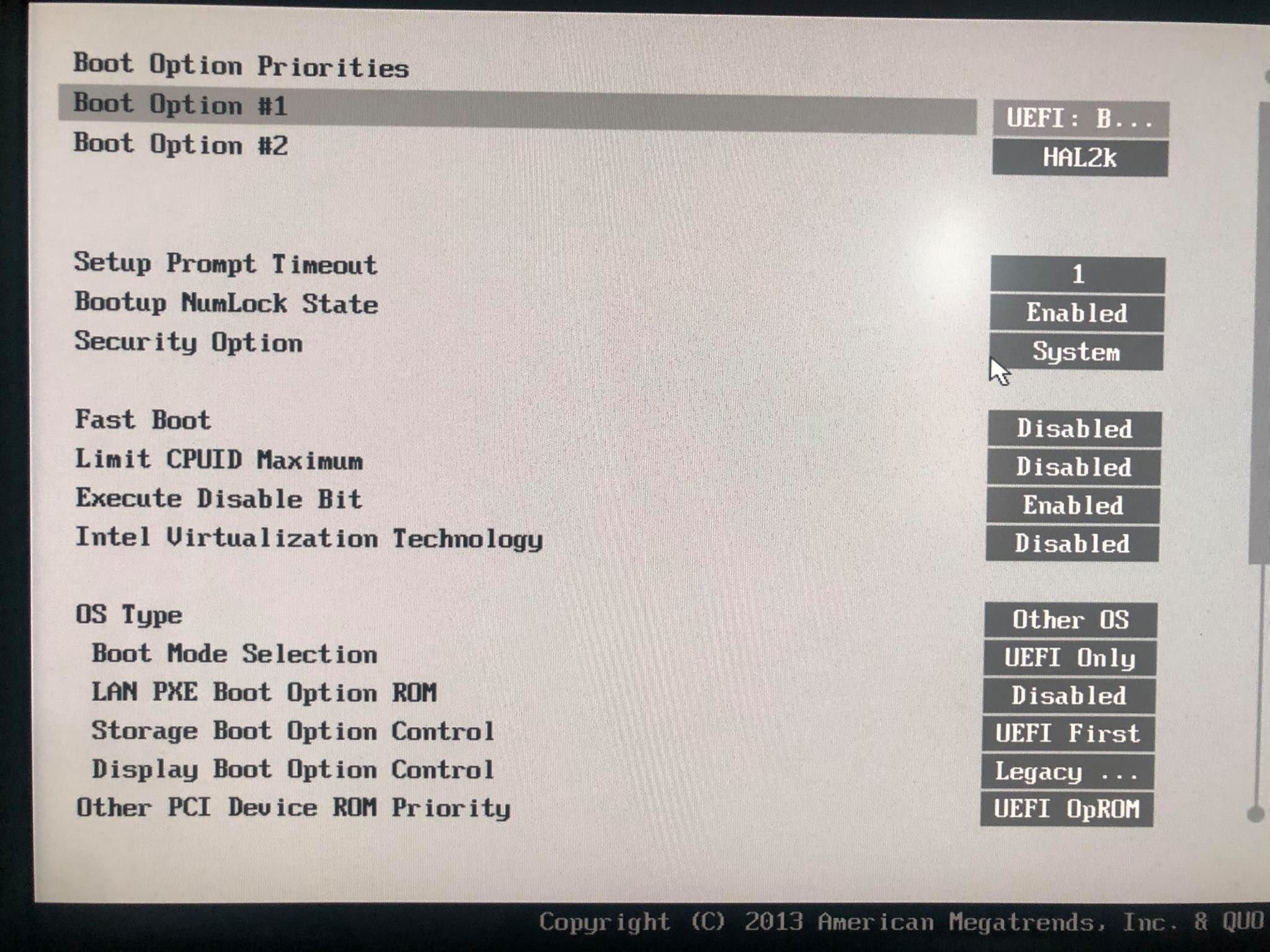

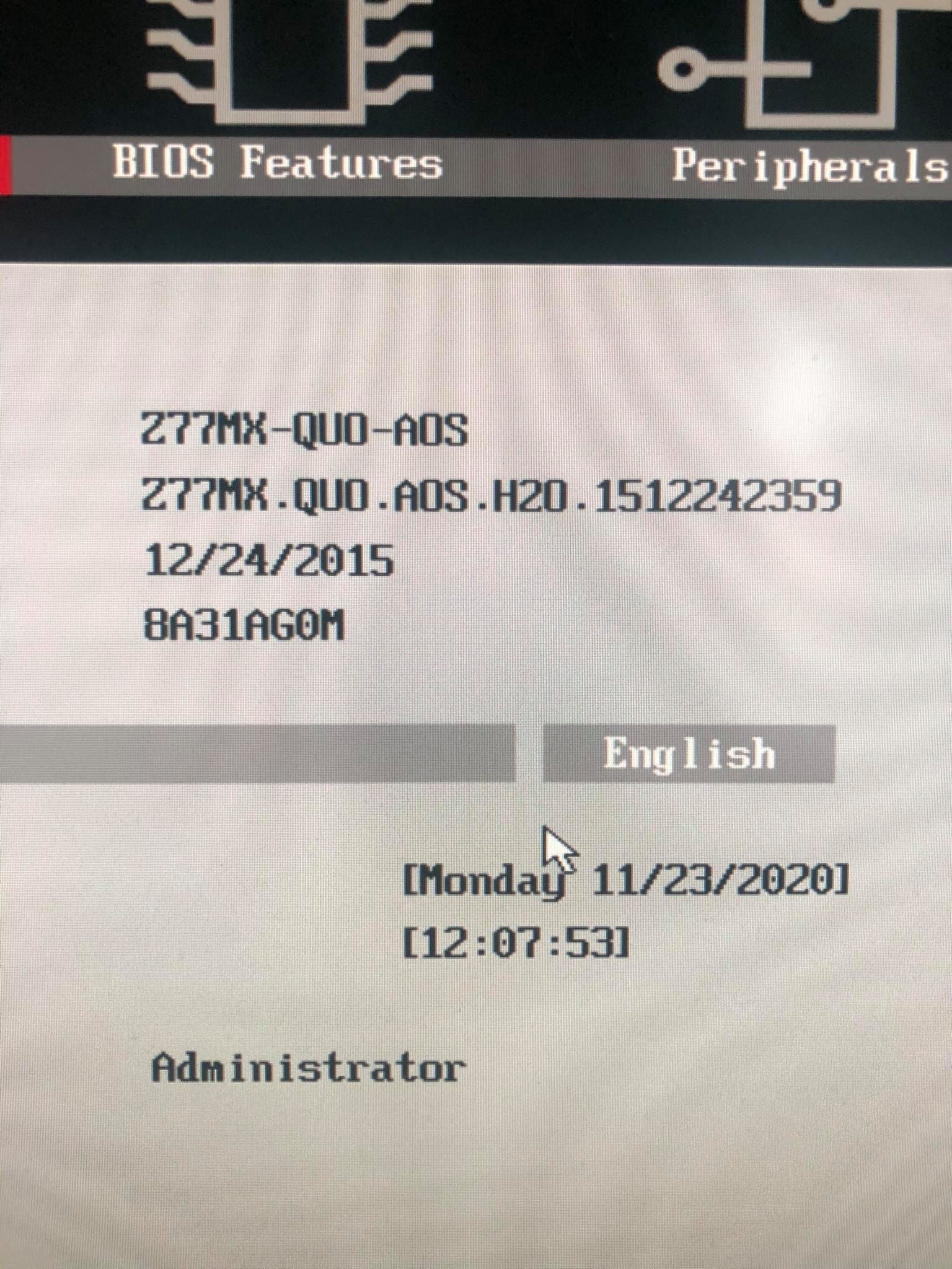

I mess up my quo aos bios i had stable instalation of high sierra with bios i forgot to backup.
Recently ive updated HS  to newest verson as i wanted to upgrade do Catalina.
my main ssd with system is fs1:
and i have cloned it to another ssd in case i mess something out.
Now i have disconnected all my othere hdds and have connected just one main 2T ssd in fs1
Neather of my ssd want to bot.
What bios should i use to make it working again?
does it have to do with bcfg comman?
Spoiler
Spoiler
Spoiler
Spoiler
Spoiler
Spoiler
Spoiler
Spoiler
On 11/12/2020 at 7:36 AM, IronManJFF said:
Updated for 0.6.3
OC numbering beginning to sound like Snow Leopard
Edited by STLVNUB
You were still on Ozmosis .. correct ?
You updated High Sierra to 10.3.6 (nothing after that.. yes I know you will want to go Catalina), correct ?
If so , your Defaults.plist and its enclosing Oz folder were left on the disk that was fs0: when it was connected.
Without Defaults.plist Ozmosis will revert to MacPro3,1 )if using firmware I was publishing) and MacPro3,1 can not boot High Sierra
What is the content of the EFI folder that is now fs0:
  • Confused 1
Hello
ive been referred to another your topic where i posted my problem.
Got a bit frustrated and wipe out ssd and start fresh.
