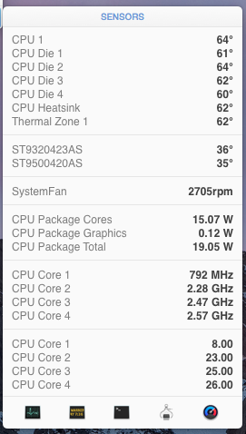

jus12 Posted October 11, 2016 Share Posted October 11, 2016 Hi Tluck, I'm successfully running Sierra on W520. 90% stuff works. I think my Fan runs at high revs (3030rpm), cpu runs at 60-65 degrees. I'm using DSDT from T420 from your zip file. Graphic is Nvidia 1000m not Intel. Maybe that is why fan runs at high speed. Any thoughts? Link to comment https://www.insanelymac.com/forum/topic/285678-lenovo-thinkpad-t420-with-uefi-only/page/114/#findComment-2297886 Share on other sites More sharing options...
tluck Posted October 12, 2016 Share Posted October 12, 2016 @jus12 - cool. glad its working of you. 64 degrees may be ok if its doing stuff and not idle (99%). sometimes these older boxes need have the heat sink re-greased to get the CPU temps down. i guess if the nvidia card is in play, then its could be generating a bit more heat? Link to comment https://www.insanelymac.com/forum/topic/285678-lenovo-thinkpad-t420-with-uefi-only/page/114/#findComment-2297967 Share on other sites More sharing options...

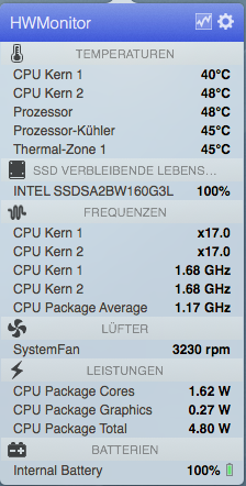

jus12 Posted October 12, 2016 Share Posted October 12, 2016 I have changed DSDT from the one for T420 to W520 (I have now W520). I have realised that in sensors information about the fan speed is gone. How can I get this back? What changes in DSDT are required? Please help? Link to comment https://www.insanelymac.com/forum/topic/285678-lenovo-thinkpad-t420-with-uefi-only/page/114/#findComment-2298216 Share on other sites More sharing options...
gpspl Posted October 12, 2016 Share Posted October 12, 2016 @jus12 Look in dsdt.dsl there are comments about all fixes. Search for "trl" or "tlr" i dont remember. The patch ypu are refering is in termal zone section aka TH0 Link to comment https://www.insanelymac.com/forum/topic/285678-lenovo-thinkpad-t420-with-uefi-only/page/114/#findComment-2298238 Share on other sites More sharing options...
tluck Posted October 12, 2016 Share Posted October 12, 2016 @jus12 yes gpspl is correct - search the T420 dsdt for string "tjl" (my initials) - and you find device SMCD - which adds 2 variables for ACPI monitors etc. - not sure about the menu bar thing or how the USB3 fixes. may need a port property injector? it is my understanding that the genericUSB kext was designed before el cap and sierra - which have totally different USB implementations now. but the USB Devices would show up in system report under Hardware/USB 1 Link to comment https://www.insanelymac.com/forum/topic/285678-lenovo-thinkpad-t420-with-uefi-only/page/114/#findComment-2298252 Share on other sites More sharing options...

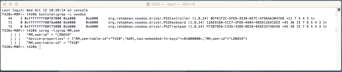

goodguess Posted October 12, 2016 Share Posted October 12, 2016 Thanks again tluck, for your awesome work! Sierra upgrade on my T420 worked like a charm, only lost my PS2 ThinkPad keyboard during installation. I did install the voodoo files from the zip you posted, and thats settled. Now my only issue is the track point behaving like on speed and the trackpad not taking taps as mouse click. Is there a workaround or did I read over something essential? Trackpoint and Trackpad did work perfectly in El Cap, much better than with W10 for that matter. Temps are looking a bit lower than in El Cap from first glance, btw. Link to comment https://www.insanelymac.com/forum/topic/285678-lenovo-thinkpad-t420-with-uefi-only/page/114/#findComment-2298373 Share on other sites More sharing options...
tluck Posted October 12, 2016 Share Posted October 12, 2016 @goodguess - the VoodooPS2 kexts in the zip behave ok for me in Sierra... the custom DSDT in the Zip defines a property identifying it as T420 so it will pick the custom settings in the kext info.plist files. checks: $ kextstat|grep -i voodoo 41 2 0xffffff7f80ba4000 0xe000 0xe000 org.rehabman.voodoo.driver.PS2Controller (1.8.24) 38EA04FC-B3B8-33BB-9E4A-7016D43B13A0 <11 7 5 4 3 1> 69 0 0xffffff7f80bc8000 0x6000 0x6000 org.rehabman.voodoo.driver.PS2Keyboard (1.8.24) 234254FF-D166-36D0-8439-964D33ABCD3E <41 35 15 7 6 5 4 3 1> 70 0 0xffffff7f80bb2000 0xc000 0xc000 org.rehabman.voodoo.driver.PS2Trackpad (1.8.24) 8D95C2E2-C69B-308A-B47F-5147A7B9CC41 <41 35 15 7 6 5 4 3 1> $ ioreg -l|grep RM,oem | | | "RM,oem-id" = "LENOVO" | | | "device-properties" = {"RM,oem-table-id"="T420","AAPL,has-embedded-fn-keys"=<01000000>,"RM,oem-id"="LENOVO"} | | | "RM,oem-table-id" = "T420" 1 Link to comment https://www.insanelymac.com/forum/topic/285678-lenovo-thinkpad-t420-with-uefi-only/page/114/#findComment-2298388 Share on other sites More sharing options...

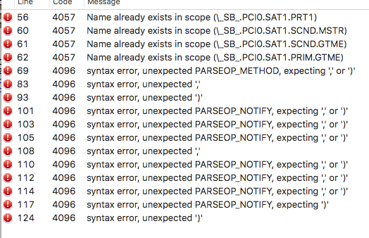

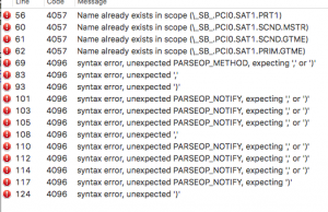

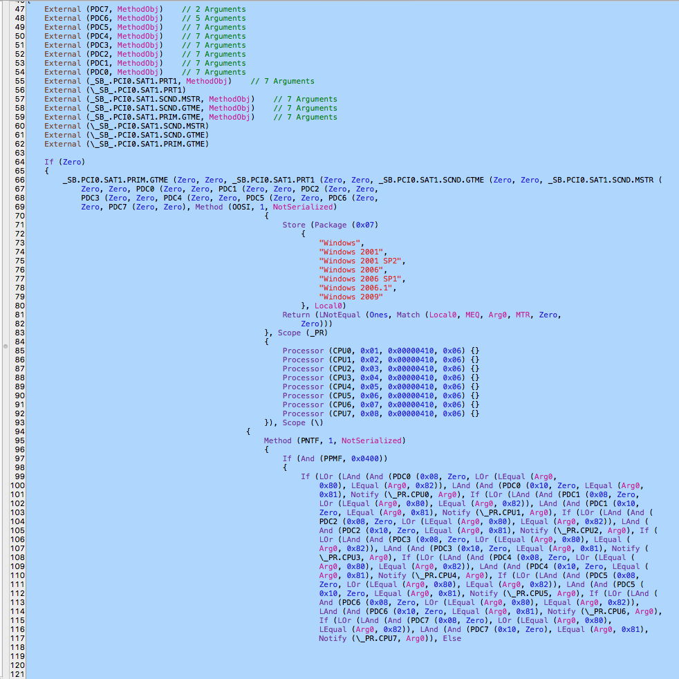

jus12 Posted October 12, 2016 Share Posted October 12, 2016 Hi Tluck, when I open your DSDT for T420, there is a lot of errors in this section (images attached). Don't really know how to fix that. I would like to make few changes for my W520. I'm using MaciASL to edit it. @goodguess - the VoodooPS2 kexts in the zip behave ok for me in Sierra... the custom DSDT in the Zip defines a property identifying it as T420 so it will pick the custom settings in the kext info.plist files. checks: $ kextstat|grep -i voodoo 41 2 0xffffff7f80ba4000 0xe000 0xe000 org.rehabman.voodoo.driver.PS2Controller (1.8.24) 38EA04FC-B3B8-33BB-9E4A-7016D43B13A0 <11 7 5 4 3 1> 69 0 0xffffff7f80bc8000 0x6000 0x6000 org.rehabman.voodoo.driver.PS2Keyboard (1.8.24) 234254FF-D166-36D0-8439-964D33ABCD3E <41 35 15 7 6 5 4 3 1> 70 0 0xffffff7f80bb2000 0xc000 0xc000 org.rehabman.voodoo.driver.PS2Trackpad (1.8.24) 8D95C2E2-C69B-308A-B47F-5147A7B9CC41 <41 35 15 7 6 5 4 3 1> $ ioreg -l|grep RM,oem | | | "RM,oem-id" = "LENOVO" | | | "device-properties" = {"RM,oem-table-id"="T420","AAPL,has-embedded-fn-keys"=<01000000>,"RM,oem-id"="LENOVO"} | | | "RM,oem-table-id" = "T420" Hi Tluck since when tapping touchpad works on T420. How to troubleshoot that if it doesn't? Currently I'm still using T420, but slowly migrating to W520, due to better graphic (Nvidia). Link to comment https://www.insanelymac.com/forum/topic/285678-lenovo-thinkpad-t420-with-uefi-only/page/114/#findComment-2298535 Share on other sites More sharing options...
tluck Posted October 12, 2016 Share Posted October 12, 2016 i use maciASL as well. but check your preferences to use ACPI 6.1 the source file dsdt.dsl is provided so you can see the code directly. the iasl binary file to compile the dsdt is there too - which is the version i used to compile it. Link to comment https://www.insanelymac.com/forum/topic/285678-lenovo-thinkpad-t420-with-uefi-only/page/114/#findComment-2298682 Share on other sites More sharing options...
