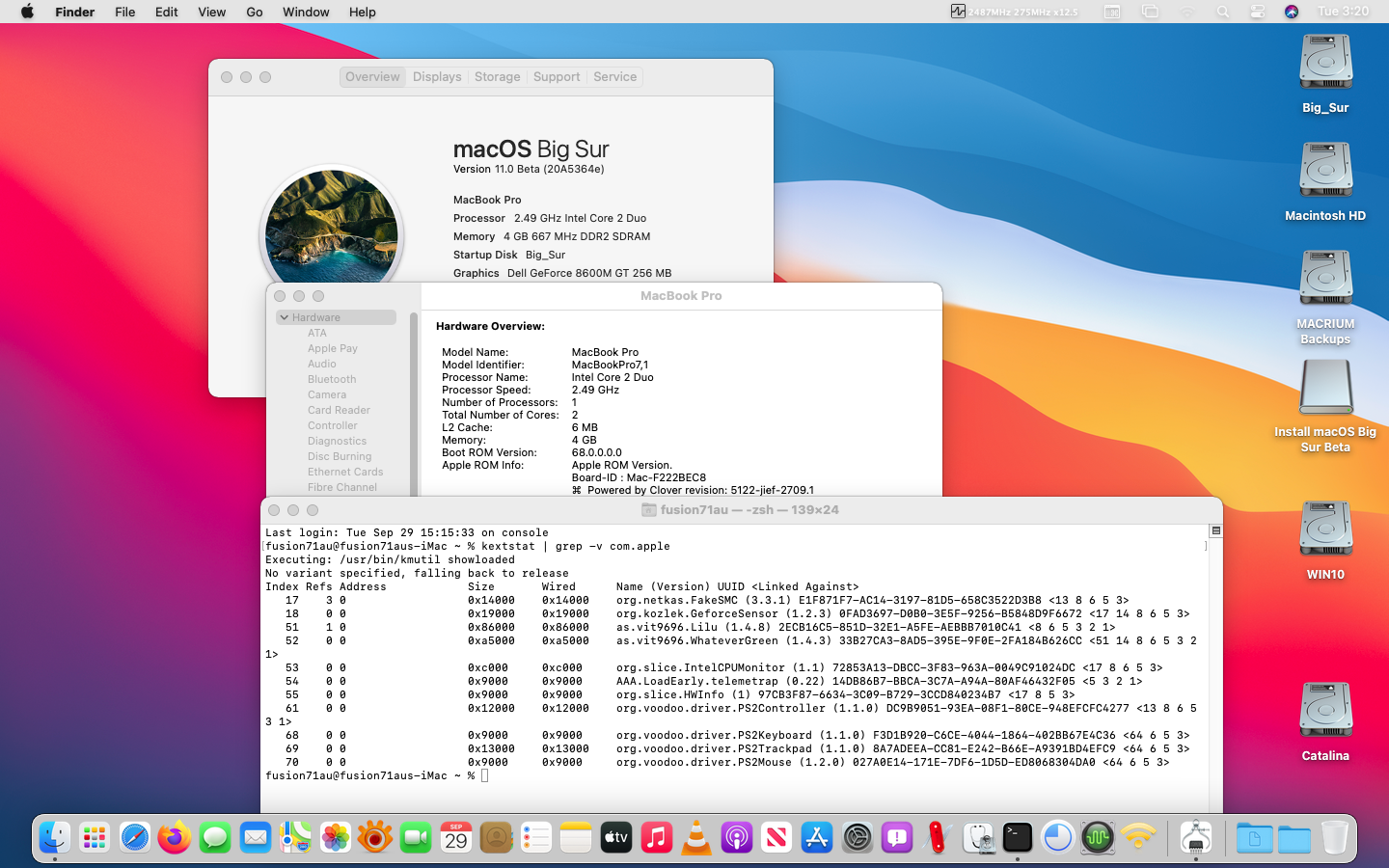

this Clover continues to start macOS successfully, BigSur included, with FakeSMC, but I note that:
does not print verbose to video, switches from memory manager load to desktop
SMBIOS is injected correctly, but from me even the previous one did not present any problems
2 windows 10 do not start, but they block when loading rotating balls
current quirks settings
475159966_Schermata2020-09-28alle11_33_24.thumb.png.ab339193fb1fcc73c78592d18c128b3d.png
PS: debug.log_BS.zip

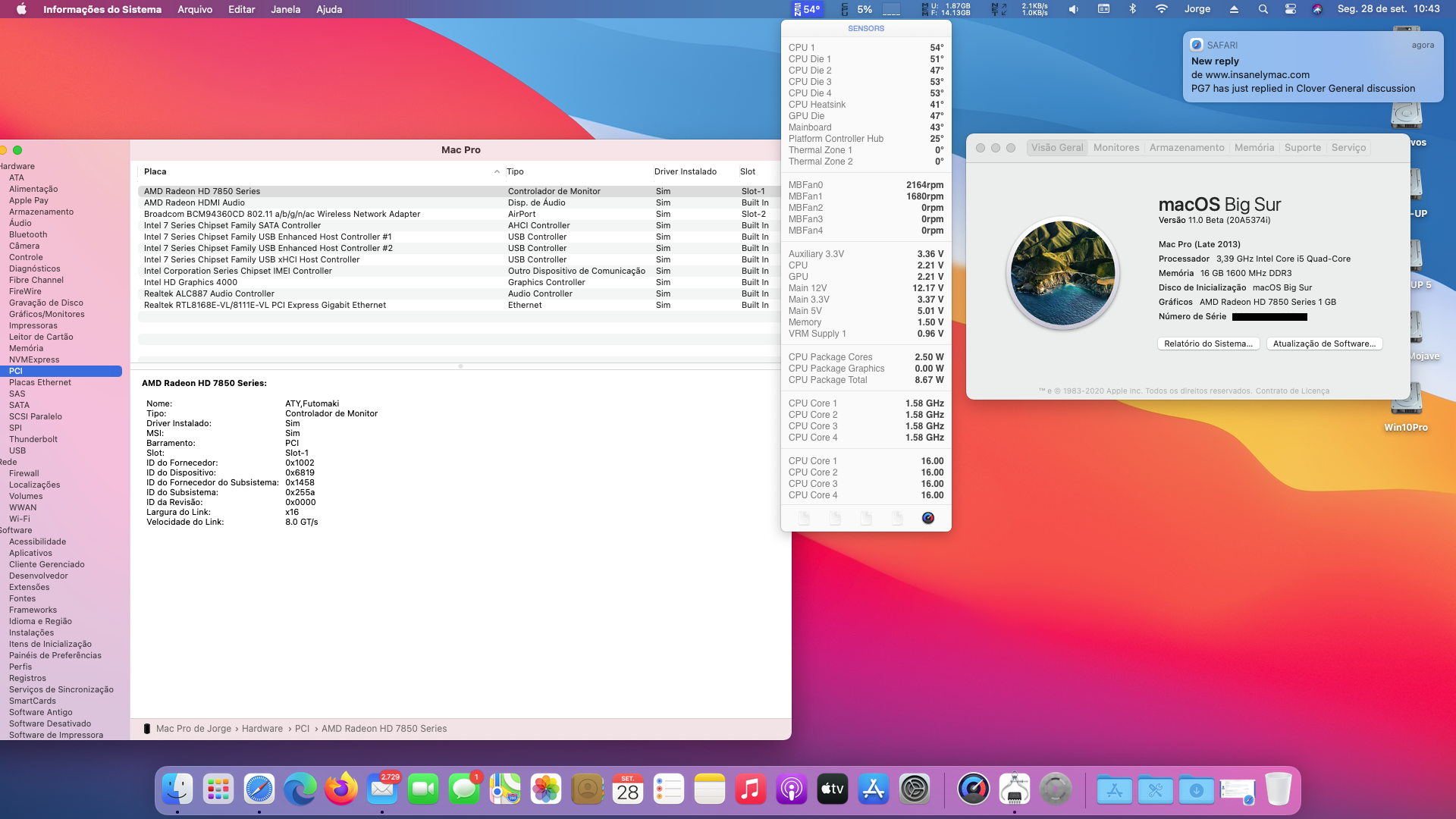

@Jief_MachakWith your new file, more recent I did some tests:
1 - With FakeSMC and its plugins, it crashes after the Clover selection screen;
2 - Only FakeSMC without plugins, it starts without problems;
3 - With VirtualSMC and its plugins, the same thing happens, it locks / freezes the PC;
4 - Only VirtualSMC starts normally.
With the previous file, made available by @iCanaro
1 - FakeSMC without plugins, starts normally
2 - VirtualSMC with or without plugins, starts normally
3 hours ago, Slice said:
I am using FakeSMC with the new Clover as well as with OC and successfully boot to BigSur. I have no Lilu at all.
@Slice I'm using RehabMan's FakeSMC from this link: https://bitbucket.org/RehabMan/os-x-fakesmc-kozlek/downloads/
I always used his with plugins, works with the latest Clover (v5122) up to macOS Catalina. In OpenCore (0.6.1), it works on all the systems I have installed: Movaje, Catalina and Big Sur
