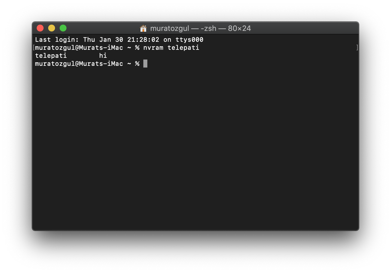

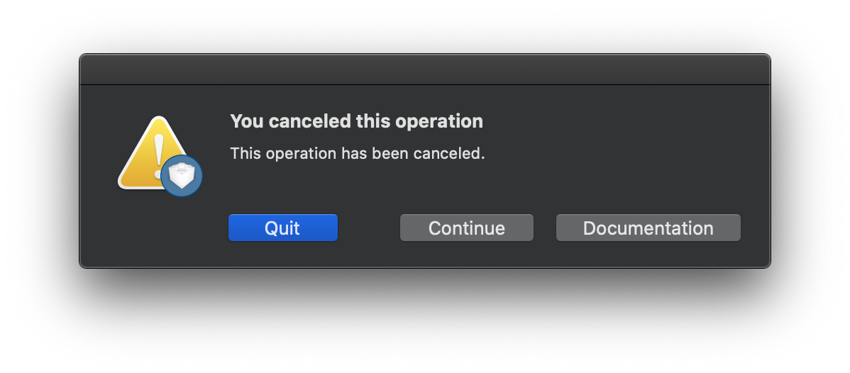

telepati Posted January 30, 2020 Share Posted January 30, 2020 @apianti now I can boot with Clover without any problem. But I am trying to clean nvram with sudo nvram -c command it doesnt work. I also tried Reset NVRAM and Rebuild caches with @Cyberdevs MacOptimizer.app but it always giving this error. Never finish the operation. Sorry, but where is this firmware menu? Link to comment https://www.insanelymac.com/forum/topic/284656-clover-general-discussion/page/834/#findComment-2706413 Share on other sites More sharing options...
Matgen84 Posted January 30, 2020 Share Posted January 30, 2020 (edited) 10 minutes ago, telepati said: @apianti now I can boot with Clover without any problem. But I am trying to clean nvram with sudo nvram -c command it doesnt work. I also tried Reset NVRAM and Rebuild caches with @Cyberdevs MacOptimizer.app but it always giving this error. Never finish the operation. Sorry, but where is this firmware menu? Just my opinion: you don't need "firmware menu" because you can boot now with Clover. MacOptimizer seems to be not update for Catalina: send a message to cyberdevs. Edited January 30, 2020 by Matgen84 1 Link to comment https://www.insanelymac.com/forum/topic/284656-clover-general-discussion/page/834/#findComment-2706415 Share on other sites More sharing options...
apianti Posted January 30, 2020 Share Posted January 30, 2020 2 minutes ago, telepati said: @apianti now I can boot with Clover without any problem. But I am trying to clean nvram with sudo nvram -c command it doesnt work. I also tried Reset NVRAM and Rebuild caches with @Cyberdevs MacOptimizer.app but it always giving this error. Never finish the operation. Sorry, but where is this firmware menu? First, do you have working NVRAM? I don't know why else those would fail. Second, if you have a working system there is no reason to do anything. The firmware menu is the menu for your firmware that you can get into when your computer first turns on by pressing some button, usually Del or F2. There is usually an option to restore default settings (that is a true NVRAM reset). If you want to actually clear your NVRAM and have no values, like the first time you ever booted, then you want to short the jumper on your motherboard that resets CMOS, power on your PC, wait however long, power it off, return the jumper to the original position. Your motherboard manual will have precise directions for this procedure and you should follow that if you intend to entirely clear. 2 minutes ago, Matgen84 said: Just my opinion: you don't need "firmware menu" because you can boot now with Clover. Yeah, unless there's some other problem now. I agree. 1 1 Link to comment https://www.insanelymac.com/forum/topic/284656-clover-general-discussion/page/834/#findComment-2706416 Share on other sites More sharing options...
telepati Posted January 30, 2020 Share Posted January 30, 2020 40 minutes ago, Matgen84 said: Just my opinion: you don't need "firmware menu" because you can boot now with Clover. MacOptimizer seems to be not update for Catalina: send a message to cyberdevs. Actually MacOptimizer always worked for me on Catalina before this OC setup. I don't know but it doesn't work now. Something crash this app but I don't know what that it is. 40 minutes ago, apianti said: First, do you have working NVRAM? I don't know why else those would fail. Second, if you have a working system there is no reason to do anything. The firmware menu is the menu for your firmware that you can get into when your computer first turns on by pressing some button, usually Del or F2. There is usually an option to restore default settings (that is a true NVRAM reset). If you want to actually clear your NVRAM and have no values, like the first time you ever booted, then you want to short the jumper on your motherboard that resets CMOS, power on your PC, wait however long, power it off, return the jumper to the original position. Your motherboard manual will have precise directions for this procedure and you should follow that if you intend to entirely clear. Yeah, unless there's some other problem now. I agree. Yes, I have a working NVRAM thanks to @MaLd0n he is implemented in custom DSDT. I checked to drive btw you mention in the earlier post with "bcfg boot dump" and just my boot drive is showing. I also soft Reset with R on the clover boot screen. Ahh, I have forgotten I am made a couple of times CMOS reset on this process. Now everything looks working. But just one thing missing no Time Machine drive on Clover Boot screen. I checked with F3 for hiding drive but No Time Machine drive. I totally lost Time Machine Drive from the boot screen but its working in the system. Link to comment https://www.insanelymac.com/forum/topic/284656-clover-general-discussion/page/834/#findComment-2706421 Share on other sites More sharing options...
apianti Posted January 30, 2020 Share Posted January 30, 2020 39 minutes ago, telepati said: Actually MacOptimizer always worked for me on Catalina before this OC setup. I don't know but it doesn't work now. Something crash this app but I don't know what that it is. Yes, I have a working NVRAM thanks to @MaLd0n he is implemented in custom DSDT. I checked to drive btw you mention in the earlier post with "bcfg boot dump" and just my boot drive is showing. I also soft Reset with R on the clover boot screen. Ahh, I have forgotten I am made a couple of times CMOS reset on this process. Now everything looks working. But just one thing missing no Time Machine drive on Clover Boot screen. I checked with F3 for hiding drive but No Time Machine drive. I totally lost Time Machine Drive from the boot screen but its working in the system. What do you mean Time Machine drive? Why would you boot from time machine? That's a backup system, do you mean recovery? Also the command for drivers is "bcfg driver dump". I assume that since the file is no longer there the firmware removed the entry itself though. I don't know why you wouldn't see recovery unless you have some how hidden. 1 Link to comment https://www.insanelymac.com/forum/topic/284656-clover-general-discussion/page/834/#findComment-2706429 Share on other sites More sharing options...
