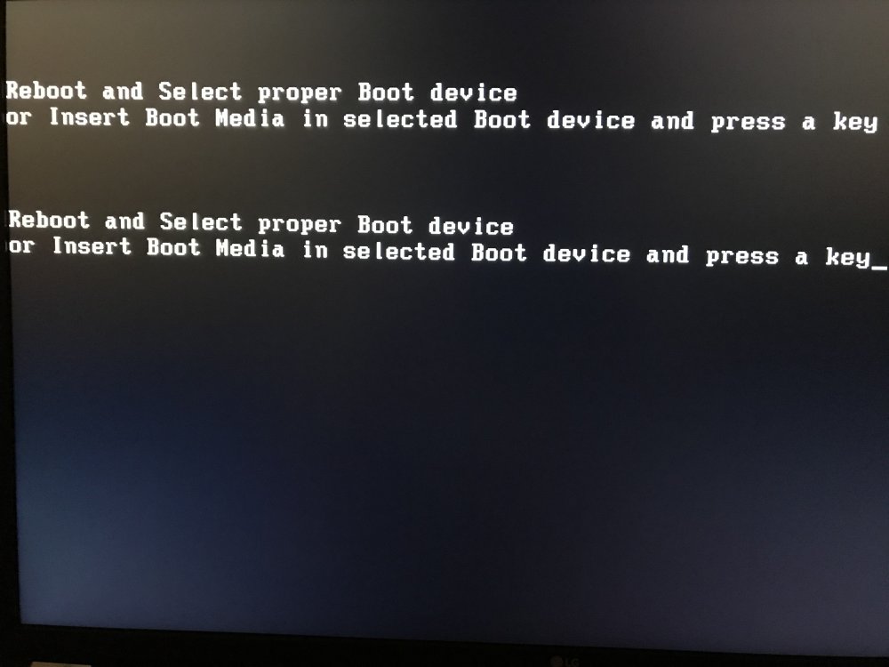

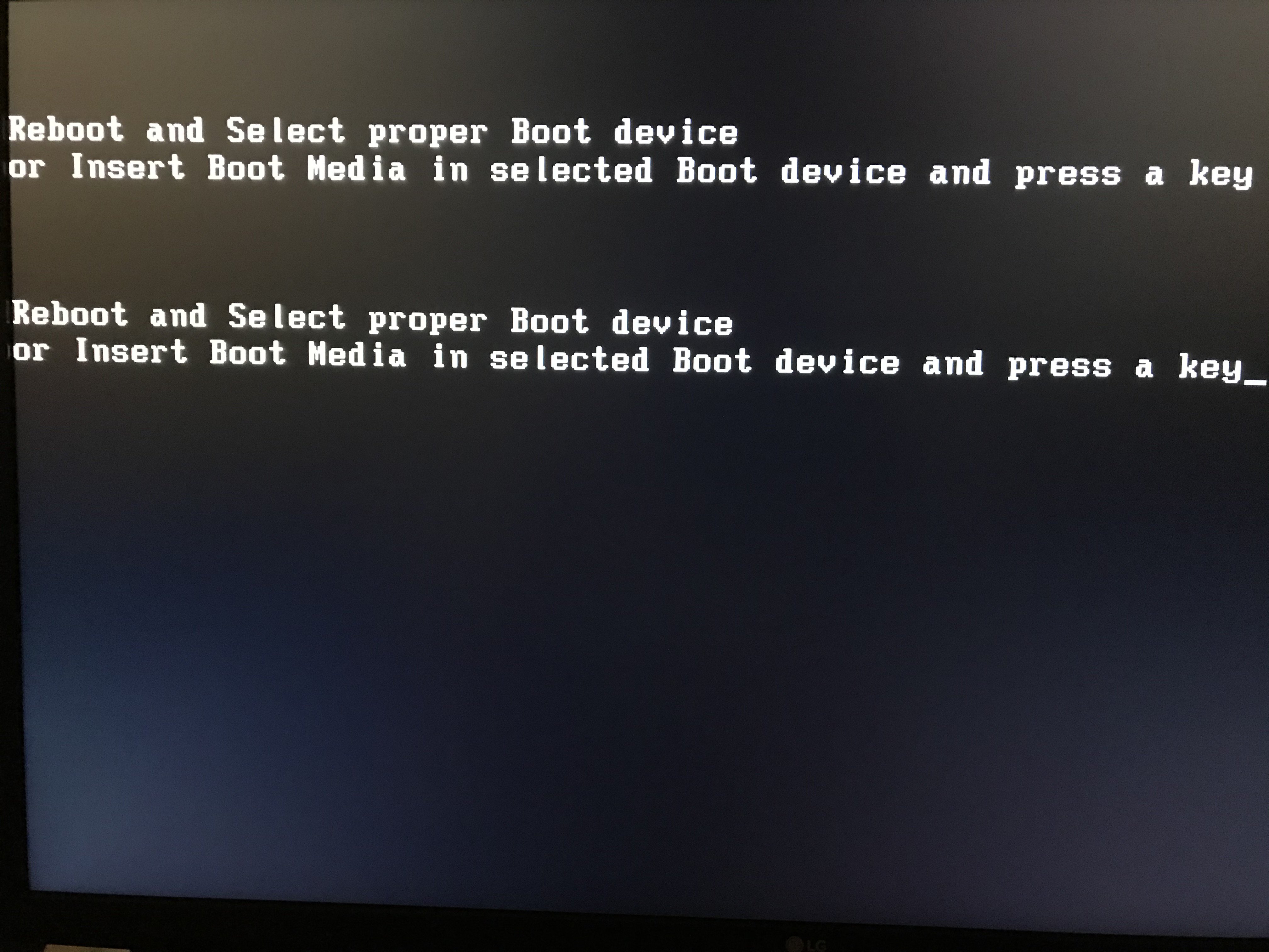

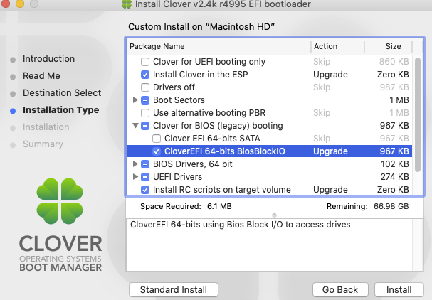

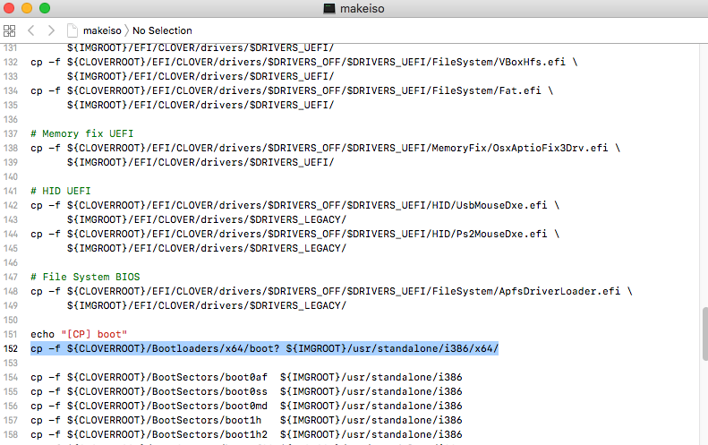

arsradu Posted July 13, 2019 Share Posted July 13, 2019 (edited) 7 hours ago, fusion71au said: @arsradu, I noticed the makeiso script formats the iso with -eltorito-boot, to allow for legacy BIOS booting, and it also uses boot6 instead of boot7 (BiosBlockIO) which works on your system. I'm guessing the presence of the legacy BIOS code is what makes the CD-DVD-ROM "invisible" to your firmware when it is set to boot to "UEFI only". Try the following modified makeiso files (place in ~/src/edk2/Clover/CloverPackage) to generate the Clover ISO instead of the default one... makeiso_boot7.zip ---> uses boot 7 instead of boot 6 for legacy boot makeiso_uefi_only.zip ---> removed -eltorito-boot formatting so only UEFI booting possible PS BiosBlockIO is still available in the latest Clover Pkg installer r4995. If the boot7/BosBlockIO installed by r4995 doesn't work, then simply replace it with the boot7 "boot" file from Clover r3911 (keep the rest of the files from Clover r4995, including CLOVERX64.efi, BOOTX64.efi and the new drivers folder file structure)... Good Luck! Clover_v2.4k_r4995.pkg.zip Hi there! So, let's see. 1. I'm guessing you're building Clover with a custom script or something, cause I couldn't get mine to add BiosBlockIO. Also, I see yours also has a few third party drivers and other wonders. This is what I get with regular compiling. However, even with your 4995 pkg, I still can't boot. But the behaviour is a little different than before. I get the cursor on the top-left corner, the "not found" thing, but no red screen anymore. It's just stuck at "not found". Replacing boot from 3911 into the 4995 USB also doesn't do anything. Same exact behaviour as above (stuck at "not found"). 2. makeiso_boot7 - same as above. Stuck at "not found". I've got the exact same behavior when nothing was written on the CD and trying to boot from it (stupid mistake on my side, I erased the disk, but forgot to put something back on it). Still, it was interesting to me that I got the exact same behaviour. So, no difference with or without content, that's what I'm trying to say. 3. makeiso_UEFI_only - still not visible in boot menu. Also, not sure that's intended (but I've got the same issue with the regular makeiso), but I've got no themes (at all) in the /themes folder on the iso...although the themes are present in CloverV2/themespkg. But they don't seem to make their way into the actual iso file. I don't think my inability to boot has anything to do with the themes, since I have the same issue with your 4995 pkg, and I do have themes on the USB drive, so it can't be that. But I'm just mentioning it in case they should be there (which I'm guessing they should). Edited July 13, 2019 by arsradu Link to comment https://www.insanelymac.com/forum/topic/284656-clover-general-discussion/page/776/#findComment-2681264 Share on other sites More sharing options...
vector sigma Posted July 13, 2019 Share Posted July 13, 2019 20 minutes ago, arsradu said: 1. I'm guessing you're building Clover with a custom script or something, cause I couldn't get mine to add BiosBlockIO. you forgot to add -mc to ebuild.sh? ./ebuild.sh -mc --no-usb -D NO_GRUB_DRIVERS_EMBEDDED -t XCODE8 2 Link to comment https://www.insanelymac.com/forum/topic/284656-clover-general-discussion/page/776/#findComment-2681267 Share on other sites More sharing options...
arsradu Posted July 13, 2019 Share Posted July 13, 2019 (edited) 2 minutes ago, vector sigma said: you forgot to add -mc to ebuild.sh? ./ebuild.sh -mc --no-usb -D NO_GRUB_DRIVERS_EMBEDDED -t XCODE8 Can't forget something I never knew I needed. :))) But yeah, that part was missing. Thank you! Edited July 13, 2019 by arsradu 1 Link to comment https://www.insanelymac.com/forum/topic/284656-clover-general-discussion/page/776/#findComment-2681269 Share on other sites More sharing options...

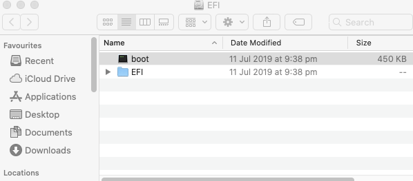

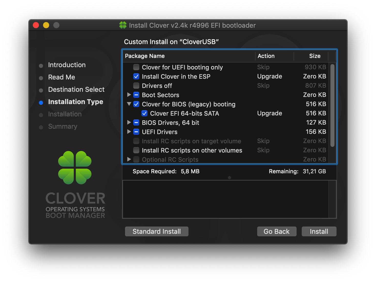

fusion71au Posted July 13, 2019 Share Posted July 13, 2019 (edited) 1 hour ago, arsradu said: Replacing boot from 3911 into the 4995 USB also doesn't do anything. Same exact behaviour as above (stuck at "not found"). There might be a bit of confusion here. Legacy boot should work now that you proved it does with r3911 . Install latest Clover r4996 with pkg installer in legacy mode targeting your USB drive (custom option: install in EFI etc) Make sure all your needed efi drivers are in EFI/CLOVER/drivers/BIOS, normal kexts, config.plist present in their respective folders etc Delete the file named "boot" at the root folder, / , of your USB drive's EFI partition (this is actually boot6=CloverEFI 64 bits SATA, renamed as "boot") Replace with boot7 = CloverEFI 64 bits BiosBlockIO (which I extracted from official Clover r3911 ISO on Sourceforge) on the root of the USB drive, renamed as "boot" Try legacy boot again to your USB... 46 minutes ago, arsradu said: Can't forget something I never knew I needed. :))) But yeah, that part was missing. Thank you! Make sure you put the working boot7 from Clover r3911 in ~/src/edk2/Clover/CloverPackage/CloverV2/Bootloaders/x64 before running makeiso_boot7 from your ~/src/edk2/Clover/CloverPackage folder. Otherwise it also won't be present in your Clover ISO . Also regarding the missing embedded theme in your ISO: Did you copy the embedded theme folder from ~/src/edk2/Clover/CloverPackage/CloverV2/EFI/CLOVER/themes to ~/src/edk2/Clover/CloverPackage/CloverV2/themespkg before running makeiso? 2 hours ago, XLNC said: is aptiomemfix removed from clover ? Yes, this is an acidanthera project now. If you build Clover with Build_Clover.command and specify XCODE5 toolchain, you will still find it compiled in the ~/src/edk2/Build/AptioFixPkg/RELEASE_XCODE5/X64 folder ---> manually copy it to your ~/src/edk2/Clover/CloverPackage/CloverV2/EFI/CLOVER/drivers/off/UEFI/MemoryFix folder. Then cd to ~/src/edk2/Clover/CloverPackage and run ./makepkg to create the Clover installer. Edited July 13, 2019 by fusion71au 2 Link to comment https://www.insanelymac.com/forum/topic/284656-clover-general-discussion/page/776/#findComment-2681270 Share on other sites More sharing options...

arsradu Posted July 13, 2019 Share Posted July 13, 2019 (edited) 1 hour ago, fusion71au said: There might be a bit of confusion here. Legacy boot should work now that you proved it does with r3911 . Install latest Clover r4996 with pkg installer in legacy mode targeting your USB drive (custom option: install in EFI etc) Make sure all your needed efi drivers are in EFI/CLOVER/drivers/BIOS, normal kexts, config.plist present in their respective folders etc Delete the file named "boot" at the root folder, / , of your USB drive's EFI partition (this is actually boot6=CloverEFI 64 bits SATA, renamed as "boot") Replace with boot7 = CloverEFI 64 bits BiosBlockIO (which I extracted from official Clover r3911 ISO on Sourceforge) on the root of the USB drive, renamed as "boot" Try legacy boot again to your USB... Yeah, I guess I mixed some drivers...cause now IT WORKS! I already replaced that boot file, as you mentioned. But I guess the problem was somewhere else....? So, right now, I managed to get 4997 to boot (all the way into the OS) in Legacy mode. But here's how: 1. on my existing USB drive with 3991, I replaced BOOTX64.efi in /BOOT and CLOVERX64.efi in /CLOVER with the ones I compiled for myself (version 4997) from my SSD's EFI folder. Call it "manual upgrade"...? :)) 2. I copy-pasted drivers from drivers64 to drivers/BIOS and from drivers64UEFI to drivers/UEFI. The new /drivers folder was already there from my previous installations of 49xx versions. So I just copy-pasted from the old folder structure to the new one. So maybe the reason why I couldn't boot with BiosBlockIO (getting stuck at Not Found) was the driver, not the boot file itself. That...or I was doing something else wrong. But I think that was it. Update: confirmed. SATA doesn't work (red screen). BiosBlockIO DOES work (including from 4997, which now I can compile on my own, thanks to Vector Sigma's feedback). BUT The drivers need to be rewritten. Otherwise I get stuck with BiosBlockIO. As I said, the behaviour is a little different. With BiosBlockIO and wrong drivers, I get stuck at "Not Found". No red screen in this case. Just stuck. With BiosBlockIO and correct drivers, all fine, I can boot Mojave with no problems. With the default drivers in 4997, I can't boot. I have to look more into it, but not right now However, with drivers copy-pasted from drivers64 and drivers64UEFI (from 3911, with some additions) into the new folder structure, it does boot. *ApfsDriverLoader has been added by me, the rest of the drivers are from original 3911 installation. *ApfsDriverLoader adn OsXAptioFix3Drv have been added by me. The rest of them are from the original 3911 installation. drivers.zip Edited July 13, 2019 by arsradu 2 Link to comment https://www.insanelymac.com/forum/topic/284656-clover-general-discussion/page/776/#findComment-2681283 Share on other sites More sharing options...

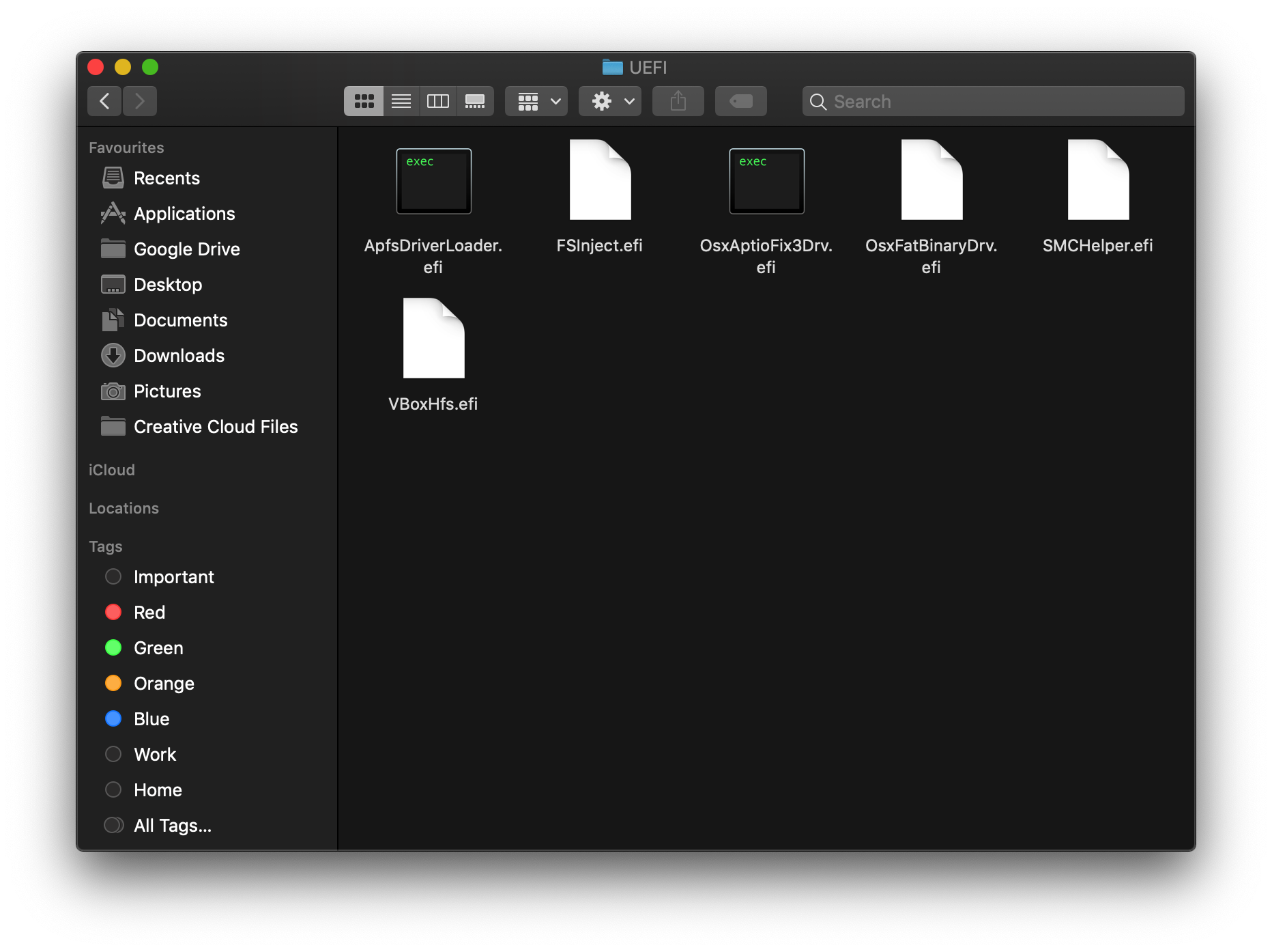

vector sigma Posted July 13, 2019 Share Posted July 13, 2019 (edited) 2 hours ago, fusion71au said: If you build Clover with Build_Clover.command and specify XCODE5 toolchain, you will still find it compiled in the ~/src/edk2/Build/AptioFixPkg/RELEASE_XCODE5/X64 folder ---> manually copy it to your Guys, isn't more easy to go at github/acidanthera/AptioMemoryFix/release and just download it? if you want it in the package, just copy it in ../CloverPackage/CloverV2/EFI/CLOVER/drivers/off/UEFI/MemoryFix/ just before call 'make pkg' Edited July 13, 2019 by vector sigma Link to comment https://www.insanelymac.com/forum/topic/284656-clover-general-discussion/page/776/#findComment-2681293 Share on other sites More sharing options...
fusion71au Posted July 13, 2019 Share Posted July 13, 2019 (edited) 29 minutes ago, vector sigma said: Guys, isn't more easy to go at github/acidanthera/AptioMemoryFix/release and just download it? if you want it in the package, just copy it in ../CloverPackage/CloverV2/EFI/CLOVER/drivers/off/UEFI/MemoryFix/ just before call 'make pkg' At the moment, the Build_Clover.command script has not been updated to take into account the new /Drivers folder structure that you introduced. Before, AptioMemoryFix was automatically compiled and included in the final installer.pkg presented to the end user. btw, I found another typo in the makeiso.script...for latest r5000, boot? should be boot6 I assume...attached fixed makeiso.fixed typo.zip OK, it copies both boot6 and boot7 Edited July 13, 2019 by fusion71au Link to comment https://www.insanelymac.com/forum/topic/284656-clover-general-discussion/page/776/#findComment-2681296 Share on other sites More sharing options...
vector sigma Posted July 13, 2019 Share Posted July 13, 2019 (edited) 7 minutes ago, fusion71au said: At the moment, the Build_Clover.command script has not been updated to take into account the new /Drivers folder structure that you introduced. Before, AptioMemoryFix was automatically compiled and included in the final installer.pkg presented to the end user. btw, I found another typo in the makeiso.script...for latest r5000, boot? should be boot6 I assume...attached fixed makeiso.fixed typo.zip Isn't a typo, it's correct. It just copy both boot6 and boot7 or whatever starts with boot Edited July 13, 2019 by vector sigma 1 Link to comment https://www.insanelymac.com/forum/topic/284656-clover-general-discussion/page/776/#findComment-2681298 Share on other sites More sharing options...
