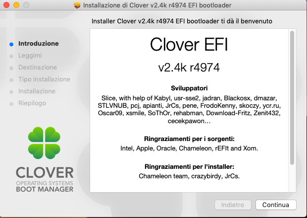

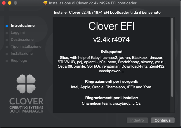

All works fine. Thanks :thumbsup_anim: Do you know a solution for Clover Logo missing in Dark Mode

6 hours ago, Matgen84 said:
Hi @Sherlocks and Clover Team,
Is it possible to display Clover Logo from Background (package/resources) in Dark Mode? Only Light Mode is correct actually.
It looks like the problem is macOS DarkMode; not Clover package. Also occurred with another packages as well.
Edited by Badruzeus
It's clearly a bug, already solved in Xcode 10 last year. Not sure we need a solution, which I eventually have (I have a tiny command line for that in the hwsensor project), or just wait for a better Xcode 11 that will fix the bug as already was with predecessor. Anyway I din't try it my self as I installed Catalina only few hours ago, but I will soon.
  • Thanks 2

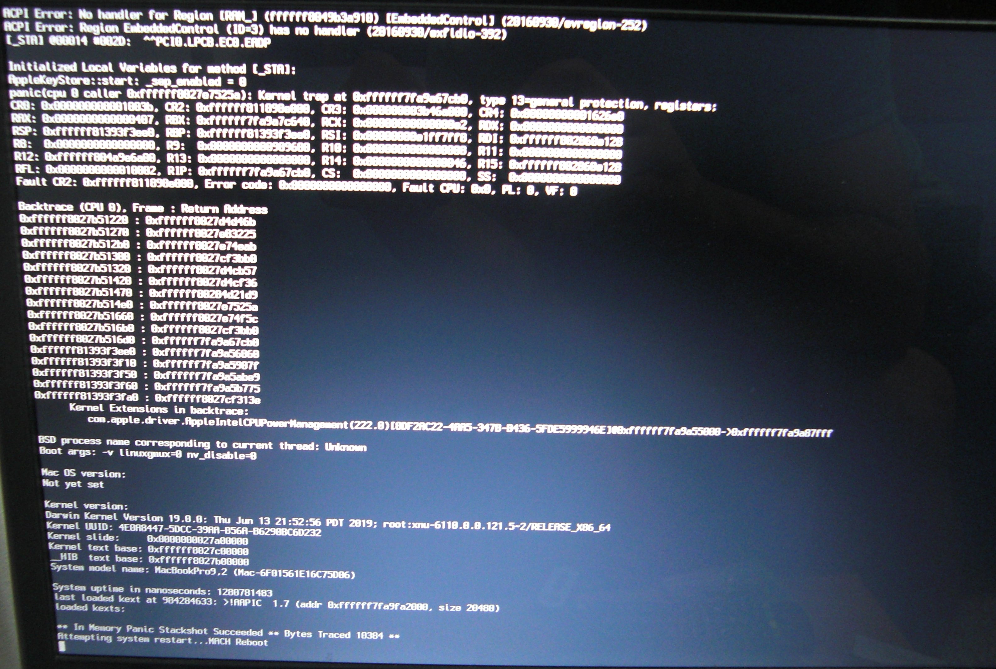

    // 10.12.6
    STATIC UINT8 find[] = { 0x8D, 0x43, 0xC4, 0x83, 0xF8, 0x22 };
    STATIC UINT8 repl[] = { 0x8D, 0x43, 0xC6, 0x83, 0xF8, 0x22 };
    applyKernPatch(kern, find, sizeof(find), repl, comment);
    // PMheart: attempt to add 10.14 compatibility
  } else if (os_version < AsciiOSVersionToUint64("10.15")) {
    // 10.13/10.14
    STATIC UINT8 find[] = { 0x89, 0xD8, 0x04, 0xC4, 0x3C, 0x22 };
    STATIC UINT8 repl[] = { 0x89, 0xD8, 0x04, 0xC6, 0x3C, 0x22 };
    // PMheart: attempt to add 10.15 compatibility
  } else if (os_version < AsciiOSVersionToUint64("10.16")) {
    STATIC UINT8 find[] = { 0x8D, 0x43, 0xC4, 0x3C, 0x22 };
    STATIC UINT8 repl[] = { 0x8D, 0x43, 0xC6, 0x3C, 0x22 };
uless my cpu isn't involved, but should since is it a Core i5 3210M if I correctly understood the code.
right. seems to check kernelandkextpatch debug option and confirm patch is working
