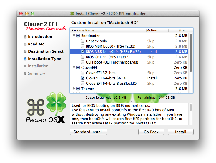

For safety reasons, I chose to install Clover in a USB flash drive. Chameleon works fine but Clover does not work at all. I mean Clover boots and then all 3 partitions are shown. If I boot OS X, I get a white underscore and it stays there. If I press Enter it goes back to the Cover menu. If I boot System Reserved or Windows 8, I get this pixelated mario character or something and it freezes.
I'm not sure what is wrong. From the Installer, this is what I selected:

I usually do differently for MBR and GPT hdd. For MBR, I create a target partition for Windows (ntfs) without leaving unallocated space before run the installer. Meanwhile in GPT, I just delete target partition leaving only ESP (EFI system partition - 200mb), so all boot files will be in installed in ESP.

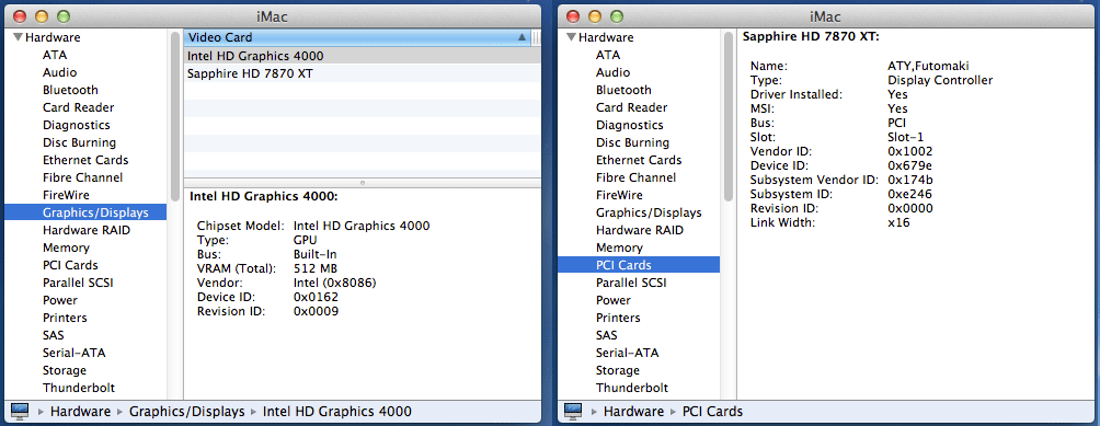

I'm currently also trying to patch the connectors, because my Sapphire 7950 Boost has four connectors (not standard) DP, HDMI, DVD-D and DVD-I. May i ask you:
1. Is your card listet later as PCI-card in Systemprofiler? (my is not listed, only visible within graphics/display tab)
2. Can you post your config.plist (regarding graphic card and kext-patches).
Must i use GraphicInjections (default is on) or not to get full/native usage of my card? My card uses the standard PCI-ID's for 7950 (0x1002/0x679a),, but with GraphicsInjector No and Futomaki frame buffer the system will not display desktop.

Have you tried all those ports (DVI/HDMI/DP) before trying to patch its connectors?
1. Yes, it's showed in PCI card section,
However, IMO it's only cosmetic. It appears there when you inject some info through DSDT (as you can see below).

It's not mandatory to use Futomaki, but it's common for 4 ports cards besides Hamachi, Aji, Buri and Dashimaki. You should use GraphicsInjector=Yes, unless you inject everything through DSDT.
