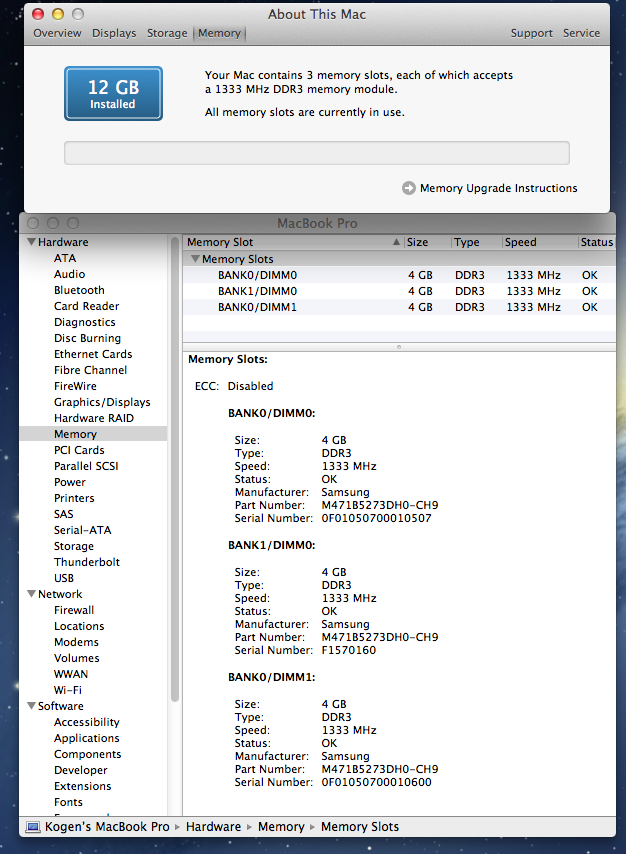

tluck Posted April 23, 2013 Share Posted April 23, 2013 i have been using b1208 successfully (after fixing the CPU frequency issue) on my Lenovo T420. very cool -can select/boot OSX and Win7 with native UEFI. i tried several builds since that have the "new CLOVER" directory but there are 2 problems: 1) shell crashes with an assertion 2) memory is reported as 3 banks (bogus) ... reports 12 in About This Mac and activity monitor seems to think it has 8.13 GB of memory vs 8.00 - not good. from b1208 - good. $ cat mem-good.txt Memory Slots: ECC: Disabled BANK 0/DIMM0: Size: 4 GB Type: DDR3 Speed: 1333 MHz Status: OK Manufacturer: Ramaxel Technology Part Number: RMT3020EC58E9F1333A Serial Number: 040206030901010B BANK 1/DIMM0: Size: 4 GB Type: DDR3 Speed: 1333 MHz Status: OK Manufacturer: Ramaxel Technology Part Number: RMT3020EC58E9F1333A Serial Number: 04030C0D0509030A from b1344 - bad $ cat mem-bad.txt Memory Slots: ECC: Disabled BANK0/DIMM0: Size: 4 GB Type: DDR3 Speed: 1333 MHz Status: OK Manufacturer: Ramaxel Technology Part Number: RMT3020EC58E9F1333A Serial Number: 040206030901010B BANK1/DIMM0: Size: 4 GB Type: DDR3 Speed: 1333 MHz Status: OK Manufacturer: 443 Part Number: RMT3020EC58E9F1333 Serial Number: 43CD593A BANK0/DIMM1: Size: 4 GB Type: DDR3 Speed: 1333 MHz Status: OK Manufacturer: Ramaxel Technology Part Number: RMT3020EC58E9F1333A Serial Number: 04030C0D0509030A Link to comment Share on other sites More sharing options...

K0gen Posted April 24, 2013 Share Posted April 24, 2013 ... 2) memory is reported as 3 banks (bogus) ... reports 12 in About This Mac and activity monitor... I'll add my screen shot for that (r1360): Link to comment Share on other sites More sharing options...
Maniac10 Posted April 24, 2013 Share Posted April 24, 2013 People, any RAM related issue please report it here. @toleda: did you activate the VBios patch? When I was booting with CloverEFI that was all I needed to get 1920x1080. Now booting in UEFI mode I need the CsmVideoDxe driver as well. I don't need to set the resolution on refit.conf. If you're using CloverGrowerPro you can check like this: $sudo clovergrowerpro -s Link to comment Share on other sites More sharing options...
