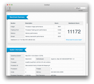

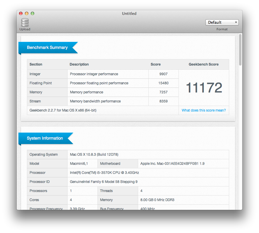

It does work after the update (rev. 1341), but in the same clumsy way as before, at least for me: this time, the useless state is 15 instead of 12. But it doesn't concern me anymore: after the update, i decided to put my custom SSDT back in /EFI/ACPI/Patched and voilà, worked like a wonder! Now i have seven P-states, as it should be, so no more GenerateIvyStates for me, and the update kept the progress made with the previous update: no more wake bug when booting in UEFI mode (the only Clover mode i'm using by the way: decided to let legacy mode exclusively for old Cham). So thank you, and thank Slice and all the crew for addressing the issue quickly.
All the best!
P.S.: a downside: the "Metal" theme is not as cool as the "Black Green" at all! Unfortunately, i only noticed the "wrong" theme was defaulted when it was too late, so i'll have to tweak the refit files later.
P.P.S.: The CPU Geekbench results improved consistently, from about 11.000 to about 11.200:
