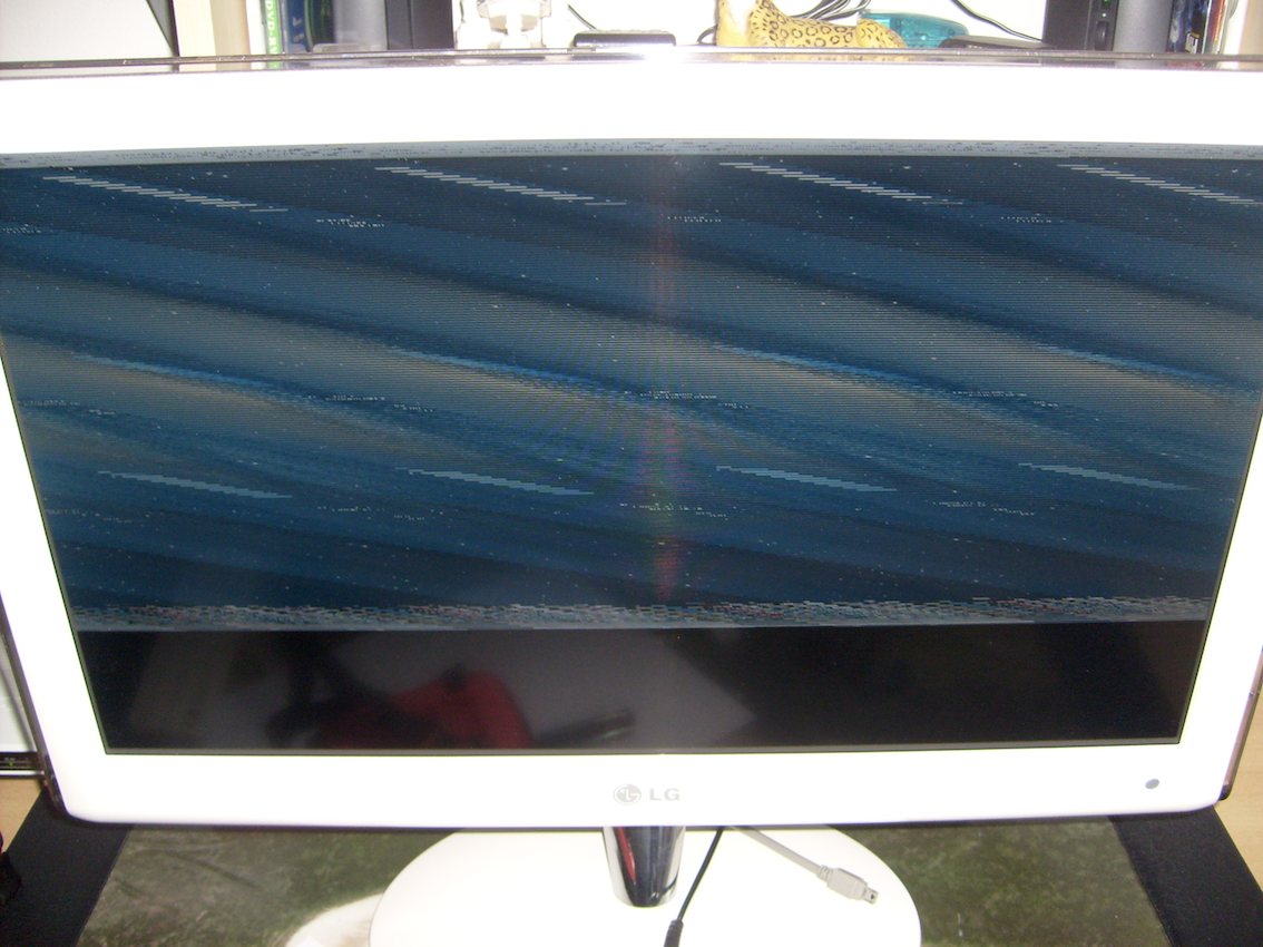

carbo178 Posted February 23, 2013 Share Posted February 23, 2013 Hi all, I've a resolution problem with iGPU when I boot in UEFI Mode; The HD4000 is connected in HDMI to LG TV 22" (the other possibility is D-SUB, but with SMBIOS 13,1 don't work, but even if it worked would have a terrible resolution...). When i boot in legacy mode everithing is OK Any solution? Link to comment https://www.insanelymac.com/forum/topic/284656-clover-general-discussion/page/47/#findComment-1891448 Share on other sites More sharing options...
ameris_cyning Posted February 23, 2013 Share Posted February 23, 2013 Hi all, I've a resolution problem with iGPU when I boot in UEFI Mode; The HD4000 is connected in HDMI to LG TV 22" (the other possibility is D-SUB, but with SMBIOS 13,1 don't work, but even if it worked would have a terrible resolution...). When i boot in legacy mode everithing is OK Any solution? Kinda reminds me of the old Too High Resolution VGA probs. Can you set Graphics Mode to a lower resolution and try again? Link to comment https://www.insanelymac.com/forum/topic/284656-clover-general-discussion/page/47/#findComment-1891490 Share on other sites More sharing options...
theconnactic Posted February 23, 2013 Share Posted February 23, 2013 Hi all, I've a resolution problem with iGPU when I boot in UEFI Mode; The HD4000 is connected in HDMI to LG TV 22" (the other possibility is D-SUB, but with SMBIOS 13,1 don't work, but even if it worked would have a terrible resolution...). When i boot in legacy mode everithing is OK Any solution? Yes, Carbo, there's a solution indeed: unplug/replug your DVI or HDMI cable. Are you using a dual card (integrated + discrete) setup? Link to comment https://www.insanelymac.com/forum/topic/284656-clover-general-discussion/page/47/#findComment-1891494 Share on other sites More sharing options...
carbo178 Posted February 23, 2013 Share Posted February 23, 2013 Thanks for the reply, Kinda reminds me of the old Too High Resolution VGA probs. Can you set Graphics Mode to a lower resolution and try again? As it set resolution in config.plist? Yes, Carbo, there's a solution indeed: unplug/replug your DVI or HDMI cable. Are you using a dual card (integrated + discrete) setup? Unplug and replug connector does not change anything... I use dual card, connecting discrete card resolution is ok. Link to comment https://www.insanelymac.com/forum/topic/284656-clover-general-discussion/page/47/#findComment-1891512 Share on other sites More sharing options...
theconnactic Posted February 23, 2013 Share Posted February 23, 2013 Unplug and replug to the video out, not to the monitor. Did you do that? If it doesn't work, you'll have to inject the HD4000 and boot with GI=No (very important) via DSDT. Try Toleda's patch for it: http://www.insanelymac.com/forum/topic/286474-about-using-discrete-and-integrated-graphics-at-the-same-time/#entry1890615 (post #11). By the way, Toleda was the one who devised the unplug/replug trick. If it does work, thank him. Best regards! Link to comment https://www.insanelymac.com/forum/topic/284656-clover-general-discussion/page/47/#findComment-1891516 Share on other sites More sharing options...
Slice Posted February 23, 2013 Share Posted February 23, 2013 Hi all, I've a resolution problem with iGPU when I boot in UEFI Mode; The HD4000 is connected in HDMI to LG TV 22" (the other possibility is D-SUB, but with SMBIOS 13,1 don't work, but even if it worked would have a terrible resolution...). When i boot in legacy mode everithing is OK Any solution? # # refit.conf # Configuration file for the rEFIt boot menu #1400x1050 screen_resolution 1024x768 Link to comment https://www.insanelymac.com/forum/topic/284656-clover-general-discussion/page/47/#findComment-1891517 Share on other sites More sharing options...
carbo178 Posted February 23, 2013 Share Posted February 23, 2013 Unplug and replug to the video out, not to the monitor. Did you do that? If it doesn't work, you'll have to inject the HD4000 and boot with GI=No (very important) via DSDT. Try Toleda's patch for it: http://www.insanelym...e/#entry1890615 (post #11). By the way, Toleda was the one who devised the unplug/replug trick. If it does work, thank him. Best regards! Thank you for reply, Yes, i have unplug/replug the video out (not monitor), i boot with GI=No because HD4000 is injected in DSDT ... But it is a temporary situation, I'm waiting for a new monitor and HDMI i will not use more (perhaps). Greetings Link to comment https://www.insanelymac.com/forum/topic/284656-clover-general-discussion/page/47/#findComment-1891521 Share on other sites More sharing options...

carbo178 Posted February 23, 2013 Share Posted February 23, 2013 # # refit.conf # Configuration file for the rEFIt boot menu #1400x1050 screen_resolution 1024x768 Hi Slice, Tried it, not work... Thanks Link to comment https://www.insanelymac.com/forum/topic/284656-clover-general-discussion/page/47/#findComment-1891554 Share on other sites More sharing options...
