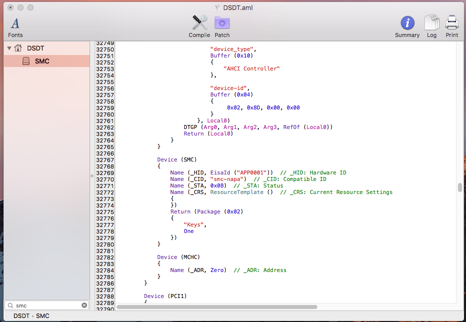

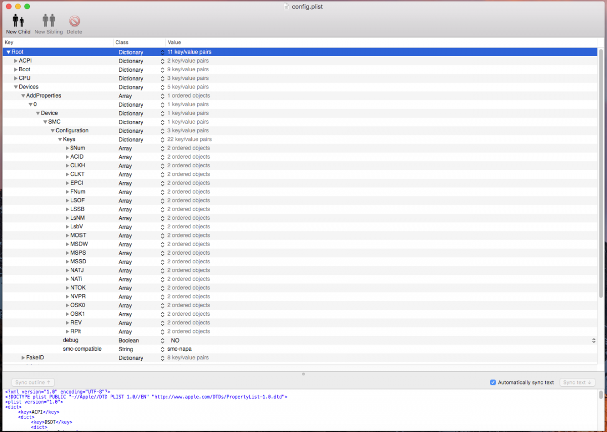

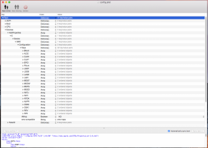

future update Clover config without FakeSMC.kext
I dont know when?
#Maintained by: N.Mano
# 1. Under Device PCI0_SMC
# 2. Fixed some X99_Warnings
into device label SMC parent_label PCI0 remove_entry;
into device label PCI0 insert begin
Device (SMC)\n
{\n
Name (_HID, EisaId ("APP0001"))  // _HID: Hardware ID\n
                    Name (_CID, "smc-napa")  // _CID: Compatible ID\n
                    Name (_STA, 0x0B)  // _STA: Status\n
                    Name (_CRS, ResourceTemplate ()  // _CRS: Current Resource Settings\n
                    {\n
})\n
                Return (Package ()\n
                {\n
                    "plugin-type",\n
                    One\n
                })\n
}\n
end;
This patches is made changes ioregistry
manoranjan’s Mac Pro.zip
Its sample config
Its worked with FakeSMC.kext
But I dont see any Error.
DSDT is the description only. FakeSMC works without this.
You need real device to work without FakeSMC.kext.
FakeSMC created virtual device but it works only inside kernel.
SMCHelper is another story. It just keep own SMC keys database to answer on boot.efi questions. It can be improved in future but it also has no deal with DSDT.
As far as you solded SMC device into your motherboard.
It can't be virtual device, it must be real chip.
For example.
You can write into DSDT that you have AMD Radeon HD770. Will you get a full Radeon graphics if you have no such device?
