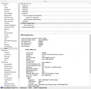

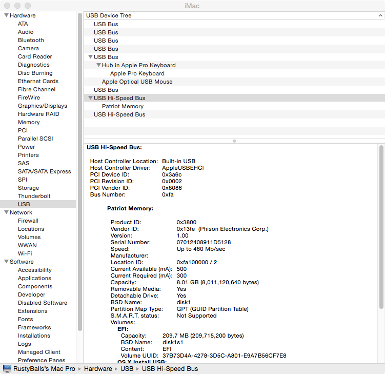

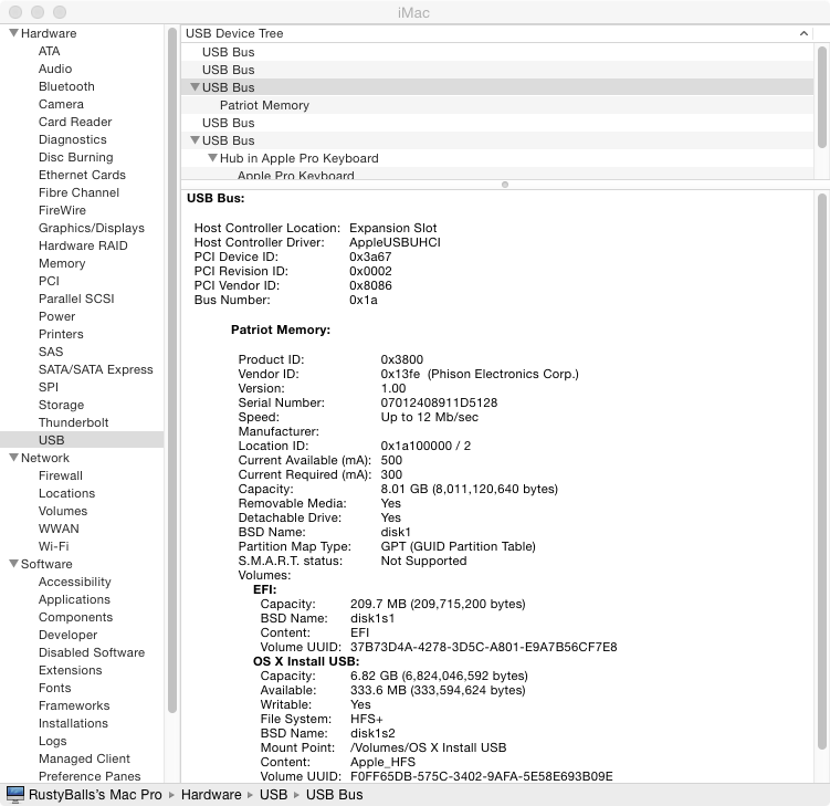

...hi, i have yosemite installed, using clover from my install usb stick...got most hardware working, but, my usb ports are not showing as highspeed(usb2) as they did in mavericks using chameleon...I'm including my boot log...just in case someone wants to look

Did you check out these keys? http://clover-wiki.zetam.org/Configuration/Devices#USB
...this is what i see during boot if i inject usb.
2014-10-21 12:43:26.000 PM kernel[0]: USBF:    1.483    EHCI controller unable to take control from BIOS
2014-10-21 12:43:26.000 PM kernel[0]: USBF:    1.483    AppleUSBEHCI:: unable to obtain ownership: 0xe00002be
2014-10-21 12:43:26.000 PM kernel[0]: USBF:    1.484    AppleUSBEHCI::UIMInitialize - Error occurred (0xe00002be)
2014-10-21 12:43:26.000 PM kernel[0]: USBF:    1.485    EHCI controller unable to take control from BIOS
2014-10-21 12:43:26.000 PM kernel[0]: USBF:    1.485    AppleUSBEHCI:: unable to obtain ownership: 0xe00002be
2014-10-21 12:43:26.000 PM kernel[0]: USBF:    1.485    AppleUSBEHCI::UIMInitialize - Error occurred (0xe00002be)
2014-10-21 12:43:26.000 PM kernel[0]: USBF:    1.740    EHCI controller unable to take control from BIOS
2014-10-21 12:43:26.000 PM kernel[0]: USBF:    1.740    AppleUSBEHCI:: unable to obtain ownership: 0xe00002be
2014-10-21 12:43:26.000 PM kernel[0]: USBF:    1.740    AppleUSBEHCI::UIMInitialize - Error occurred (0xe00002be)
2014-10-21 12:43:26.000 PM kernel[0]: USBF:    1.741    EHCI controller unable to take control from BIOS
2014-10-21 12:43:26.000 PM kernel[0]: USBF:    1.741    AppleUSBEHCI:: unable to obtain ownership: 0xe00002be
2014-10-21 12:43:26.000 PM kernel[0]: USBF:    1.741    AppleUSBEHCI::UIMInitialize - Error occurred (0xe00002be)

The AppleACPIPlataform.kext that's shipped with Yosemite causes a bug in Gigabyte 6 and x58 series motherboards. Mine is a GA-H67MA-USB3-B3.
The bug appears as a "PCI configuration begin" hang during boot.
No boot flag fixes this issue (like npci=0x2000 or 0x3000, PCIRootUID=1 or 0).
So, I've found in TonyMacx86 site that this is a new bug introduced with the new version of AppleACPIPlataform.kext shipped with Yosemite.
The solution is to simply replace the 10.10 kext with a 10.9.5 kext.
I've made a backup of AppleACPIPlataform.kext from 10.10 and installed the 10.9.5 kext. The problem has been fixed.
I was trying to inject the 10.9.5 kext with Clover without having to mess with /S/L/E, but since there's already an AppleACPIPlataform.kext in /S/L/E, I can't inject the same kext with Clover.
One solution that doesn't involve changing the kext in /S/L/E would be to patch it. The problem is that I don't know what are the differences between AppleACPIPlataform.kext 10.10 and 10.9.5 versions, so I don't know what string I should patch.
Anyone with experience in patching kexts by using Clover knows if it's possible to patch 10.10 AppleACPIPlataform.kext to work like the 10.9.5 version?

.... :blush: I see my issue is an old one..see here http://www.insanelymac.com/forum/topic/117029-usb-20-for-leopard-1057/ and here http://www.insanelymac.com/forum/topic/138303-usb-trouble-but-not-usb-trouble/ ...I may try only rolling back IOUSBFamily.kext from yosemite to mavericks version as it worked/does work on that system...
edit: perhaps not...i see this in the plist of appleusbehci.kext this:
    <key>IOKitPersonalities</key>
    <dict>
        <key>AppleUSBEHCI</key>
        <dict>
            <key>CFBundleIdentifier</key>
            <string>com.apple.driver.AppleUSBEHCI</string>
            <key>IOClass</key>
            <string>AppleUSBEHCI</string>
            <key>IOPCIClassMatch</key>
            <string>0x0c032000</string>
            <key>IOPCIPauseCompatible</key>
            <true/>
            <key>IOPCITunnelCompatible</key>
            <true/>
            <key>IOProviderClass</key>
            <string>IOPCIDevice</string>
            <key>IOUserClientClass</key>
            <string>IOUSBControllerUserClient</string>
        </dict>
    </dict>
...while the version of mavericks contains this:
    <dict/> blank...    bundle name and executable file are also different...
...so I apologize for posting here in clover as this may be a yosemite issue... :smoke:
...was neither...it was my bad syntax in writing the config file parameters....all good now...
...and here is my config file incomplete probably..but this problem is solved...
