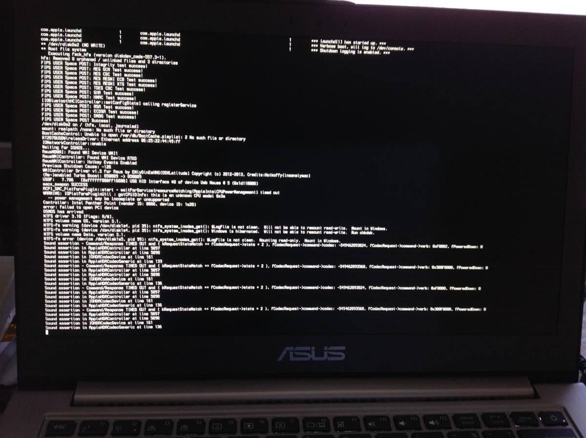

pavn Posted July 19, 2013 Share Posted July 19, 2013 I replaced my kext with yours 68x, but still the audio does not work? What am I doing wrong? I replaced also DSDT.aml file with yours in EFI\ACPI\patched\ . Is this right path for DSDT.aml to replace or should I replace DSDT.aml file also in EFI\ACPI\mini\ folder? To anyone who wants Ivy Bridge power management, you will need to do this:1. Replace your AppleACPIPlatform kext with mine (it is the default one from 10.8)2. Replace your DSDT with mine3. Replace your battery kext with this, https://code.google..../downloads/list4. You will also need to install the latest AsusNBWMI kext from http://forum.osxlati...asus-notebooks/ (DSDT edits are already done)I have attached my AppleACPI and DSDT. Most of the FN keys work (F2, F7, F9 will not work). For extended battery life, I recommend using http://forum.osxlati...-battery-power/Edit:If anyone is interested in a new kext pack, I have attached it (attached are kexts which I used and software that will help install and monitor your system). It even does not boot now, see output in verbose mode. Link to comment https://www.insanelymac.com/forum/topic/283038-asus-zenbook-prime-ux31a-db51-ultrabook-fixes-mods-tweaks-etc/page/21/#findComment-1933205 Share on other sites More sharing options...

pavn Posted July 19, 2013 Share Posted July 19, 2013 You can download it here: http://www.tonymacx86.com/buying-advice/56752-need-bluetooth-4-0-get-here.html . Have you fixed it with your proposed solution? Can you share the patched kext? (BTW: Disable vt-d and it also works.) After reinstalling Mac OS X again and trying to get it work again, the audio started to work. But unfortunately boot time is soooooooooooooooooooooooooooo looooooooooooooooooooooooooooooooooooooooong. In comparison with my previous Mac OS X installation, which booted in about 3 seconds. But audio did not work there. I am trying to find out what is the issue. Anybody has an idea, please? Link to comment https://www.insanelymac.com/forum/topic/283038-asus-zenbook-prime-ux31a-db51-ultrabook-fixes-mods-tweaks-etc/page/21/#findComment-1933286 Share on other sites More sharing options...

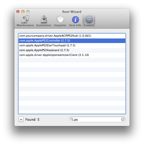

pavn Posted July 21, 2013 Share Posted July 21, 2013 Resolved backlight by deleting and reinstalling kexts as described in installation instructions and now it works. http://forum.osxlatitude.com/index.php?/topic/1948-elan-touchpad-driver-mac-os-x/ " HOW TO INSTALL:1. Remove existing Apple PS2 Controller, VoodooPS2Controller, AppleACPIPS2Nub, ApplePS2 Keyboard and old Elan Touchpad Kexts (if you have already installed) From System/Library/Extensions and Extra/Extensions folders If you have installed Mac OSX using myhack method then try to remove the above kexts from the plugins folder inside myhack kext "myHack.kext/Contents/Plugins/" in S/L/E 2. Install only the attached ApplePS2Controller and Touchpad Kexts inside the zip file, since there is some dependency between the PS2Controller and Touchpad kext for some features to work. " And removed AsusNBWMI kext before installing: AsusNBFnKeys_v1.6.zip http://forum.osxlatitude.com/index.php?/topic/1968-fn-hotkey-driver-for-asus-notebooks/ Also resolved time issue by editing registry in Windows 8. Now time is the same on both OSes. Only missing is how to resolve sleep to get it work? Should I have all of this kext loaded or are they in some duplicated functionality conflict? I just used SSDT.aml file from this Extra folder. Unfortunately it did not help me to resolve sleep issue. It still restarts instead of sleep. More or less Mac OS X is working on my zenbook now. If sleep would be resolved, that would be nice. Backlight fn keys controls worked in some stage now not. This is minor thing. I have disabled vt-d now. It boots ok now. How did you resolve different time in Mac OS X and Windows 8? Link to comment https://www.insanelymac.com/forum/topic/283038-asus-zenbook-prime-ux31a-db51-ultrabook-fixes-mods-tweaks-etc/page/21/#findComment-1933579 Share on other sites More sharing options...
68x Posted July 21, 2013 Share Posted July 21, 2013 Resolved backlight by deleting and reinstalling kexts as described in installation instructions and now it works. http://forum.osxlatitude.com/index.php?/topic/1948-elan-touchpad-driver-mac-os-x/ " HOW TO INSTALL: 1. Remove existing Apple PS2 Controller, VoodooPS2Controller, AppleACPIPS2Nub, ApplePS2 Keyboard and old Elan Touchpad Kexts (if you have already installed) From System/Library/Extensions and Extra/Extensions folders If you have installed Mac OSX using myhack method then try to remove the above kexts from the plugins folder inside myhack kext "myHack.kext/Contents/Plugins/" in S/L/E 2. Install only the attached ApplePS2Controller and Touchpad Kexts inside the zip file, since there is some dependency between the PS2Controller and Touchpad kext for some features to work. " And removed AsusNBWMI kext before installing: AsusNBFnKeys_v1.6.zip http://forum.osxlatitude.com/index.php?/topic/1968-fn-hotkey-driver-for-asus-notebooks/ Also resolved time issue by editing registry in Windows 8. Now time is the same on both OSes. Only missing is how to resolve sleep to get it work? Try this: Set sleep mode in shell: sudo pmset -a hibernatemode 0 Remove the image: sudo rm /private/var/vm/sleepimage Create a blanked file: sudo touch /private/var/vm/sleepimage Make file immutable: sudo chflags uchg /private/var/vm/sleepimage http://forums.macrumors.com/showthread.php?t=1480259 Basically, you disable "safe sleep", remove the sleepimage file, and make it so the system cannot write to it. Let me know if you still have issues. For the FN keys, I'll be uploading another DSDT with proper edits. Link to comment https://www.insanelymac.com/forum/topic/283038-asus-zenbook-prime-ux31a-db51-ultrabook-fixes-mods-tweaks-etc/page/21/#findComment-1933673 Share on other sites More sharing options...
pavn Posted July 21, 2013 Share Posted July 21, 2013 I tried to use the specified commands. Unfortunately, this simply did not help any way with the sleep issue. If fn key + f1 (Zz key) is used, then it goes to black screen, backlight keyboard is switched off and then zenbook restarts. It is the same as it was prior the commands below used. All fn keys work with latest DSDT file you sent in this thread and latest driver AsusNBFnKeys_v1.6.zip. One more issue observed. It is not possible to use iCloud or FaceTime, it is not possible to log in. App Store works not possible log in also. Try this: Set sleep mode in shell: sudo pmset -a hibernatemode 0 Remove the image: sudo rm /private/var/vm/sleepimage Create a blanked file: sudo touch /private/var/vm/sleepimage Make file immutable: sudo chflags uchg /private/var/vm/sleepimage http://forums.macrumors.com/showthread.php?t=1480259 basically, you disable "safe sleep", remove the sleepimage file, and make it so the system cannot write to it. Let me know if you still have issues. For the FN keys, I'll be uploading another DSDT with proper edits. Link to comment https://www.insanelymac.com/forum/topic/283038-asus-zenbook-prime-ux31a-db51-ultrabook-fixes-mods-tweaks-etc/page/21/#findComment-1933727 Share on other sites More sharing options...
68x Posted July 22, 2013 Share Posted July 22, 2013 I tried to use the specified commands. Unfortunately, this simply did not help any way with the sleep issue. If fn key + f1 (Zz key) is used, then it goes to black screen, backlight keyboard is switched off and then zenbook restarts. It is the same as it was prior the commands below used. All fn keys work with latest DSDT file you sent in this thread and latest driver AsusNBFnKeys_v1.6.zip. One more issue observed. It is not possible to use iCloud or FaceTime, it is not possible to log in. App Store works not possible log in also. You need a proper a wireless card for Facetime, iCloud, and AppStore. I suggest you spend couple of hours reading this whole thread (start from page 15). A lot of your issues are explained and fixed in the previous thread pages. The FN key issue is an issue with the DSDT. I have a fix for it, however, I have no intention for releasing it until I can find a proper workaround for it. Link to comment https://www.insanelymac.com/forum/topic/283038-asus-zenbook-prime-ux31a-db51-ultrabook-fixes-mods-tweaks-etc/page/21/#findComment-1933742 Share on other sites More sharing options...
pavn Posted July 22, 2013 Share Posted July 22, 2013 68x, Thanks for suggestions. I mean FN keys work: Zz, ((o)), Backlight -, Backlight +, Display Brightness -, Display Brightness +, Switch off display does not do anything, Not sure if Switch Displays Fn key works - not tested yet, Trackpad Switch Off/On works, Mute Switch works, Volume -, Volume + works. What else? Sleep does not work, it restarts zenbook even with the commands sent. What is wrong here? Wifi used: http://www.ebay.com/itm/400334229162?ssPageName=STRK:MEWNX:IT&_trksid=p3984.m1439.l2649 Internet works perfectly, going to try to find why Facetime, iCloud, and AppStore does not work as it should. Overally the zenbook works nicely and fast. With some minor issues to be resolved. Does external display connected via analog out work for you? It works for me in Windows, but I was not able to get it work in Mac OS X. HDMI works perfectly even with the sound on TV. Going to reread start from page 15, again. You need a proper a wireless card for Facetime, iCloud, and AppStore. I suggest you spend couple of hours reading this whole thread (start from page 15). A lot of your issues are explained and fixed in the previous thread pages. The FN key issue is an issue with the DSDT. I have a fix for it, however, I have no intention for releasing it until I can find a proper workaround for it. Link to comment https://www.insanelymac.com/forum/topic/283038-asus-zenbook-prime-ux31a-db51-ultrabook-fixes-mods-tweaks-etc/page/21/#findComment-1933770 Share on other sites More sharing options...

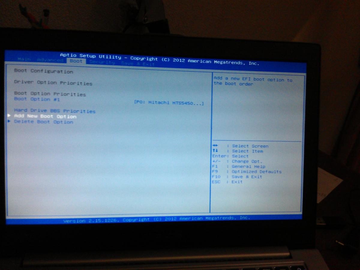

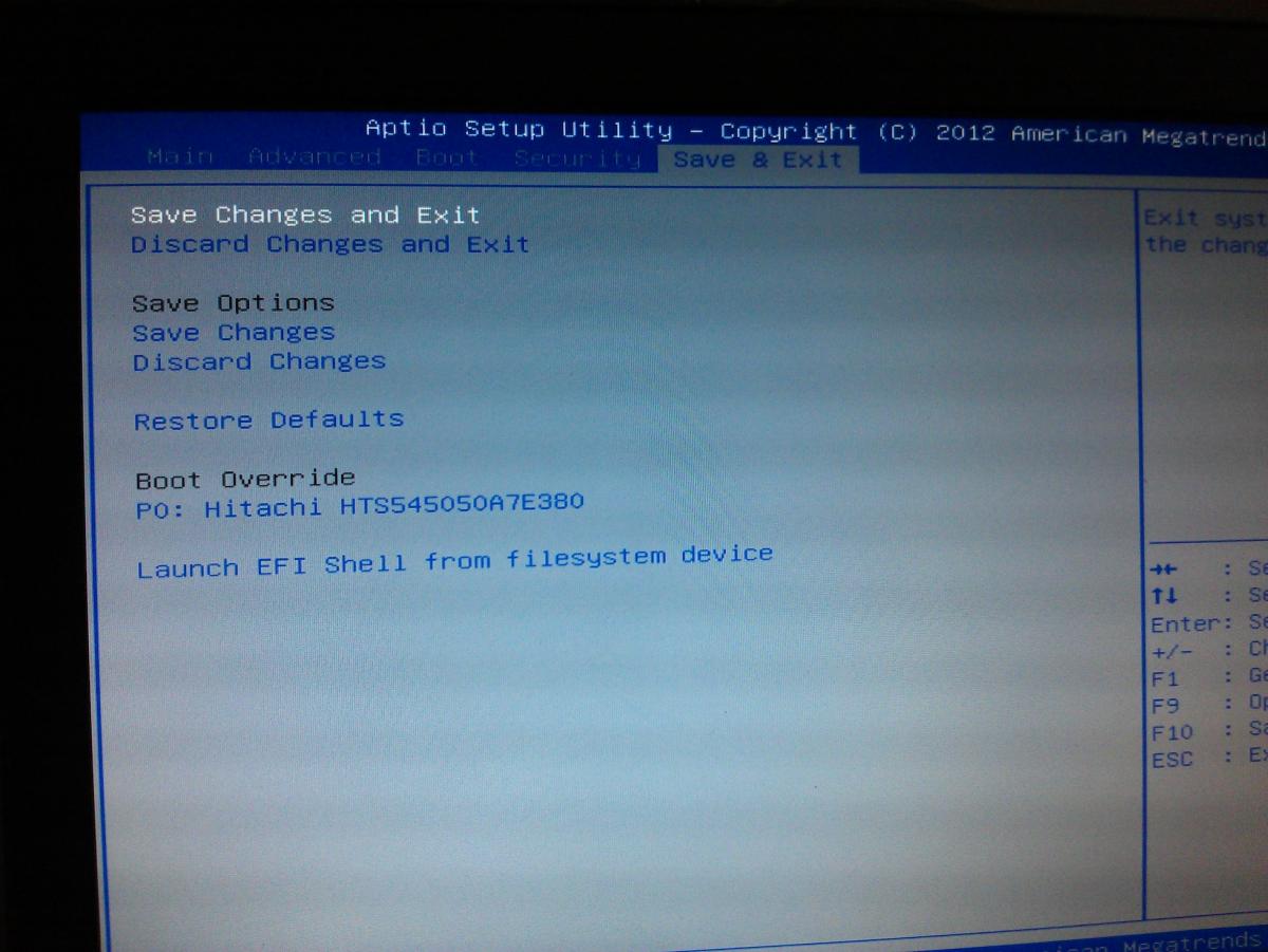

berny_ Posted July 23, 2013 Share Posted July 23, 2013 Hello everyone, I have installed on my Asus UX32VD ML 10.8 Retail without any problems. Once installed the ML Bios does not see the SSD to set it as boot, I realized that I do not see why the partition scheme is GUID, if it imposed on MSDOS sees it. So you will understand that even installing the bootloader on the ssd (where ML is installed) then I have no way to start it, so I tried to install Chimera on a partition located on the second HD in MSDOS, the bootloader is installed correctly, but despite the BIOS sees the HD does not start, giving me back this message "this is not a bootable disk". So for now I can start ML only via usb. What can I do? Thank you all. I enclose two photos of the Bios for greater clarification, notice to those settings where he speaks of EFI it may be the problem. (The Hitachi HD you see is the magnetic field, ML is installed in San Disk SSD) Link to comment https://www.insanelymac.com/forum/topic/283038-asus-zenbook-prime-ux31a-db51-ultrabook-fixes-mods-tweaks-etc/page/21/#findComment-1934065 Share on other sites More sharing options...
