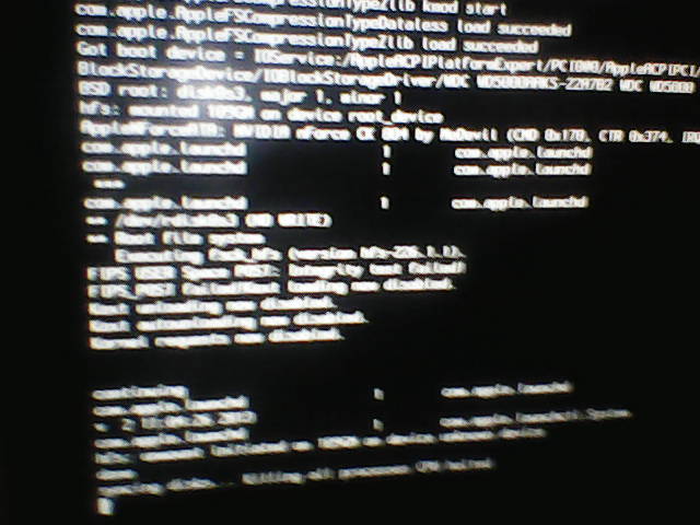

0sx324 Posted November 2, 2013 Share Posted November 2, 2013 @Andy anyway i can't boot with GE=yes it's stuck here: opemu error: no rip yetopemu error: no rip yetopemu error: no rip yetopemu error: no rip yetopemu error: no rip yetopemu error: no rip yet Link to comment https://www.insanelymac.com/forum/topic/281450-mavericks-kernel-testing-on-amd-formerly-mountain-lion-kernel-testing-on-amd/page/147/#findComment-1962473 Share on other sites More sharing options...

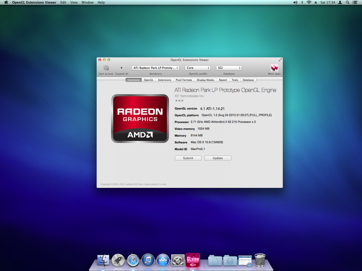

Chris Etheridge Posted November 2, 2013 Share Posted November 2, 2013 Okay booting works fine!But I have lots of artifacts. Maps is entirely grey where there should the image, and Safari has the 'soup' of letters bug. Chrome works if I disable hardware acceleration. I am gonna try in 32bit mode.ATI HD5770Biostar A780L AMD Athlon X2 (although Mavericks is saying 'Intel Core 2 Duo') Preview also has HUGE problems. 1 Link to comment https://www.insanelymac.com/forum/topic/281450-mavericks-kernel-testing-on-amd-formerly-mountain-lion-kernel-testing-on-amd/page/147/#findComment-1962475 Share on other sites More sharing options...

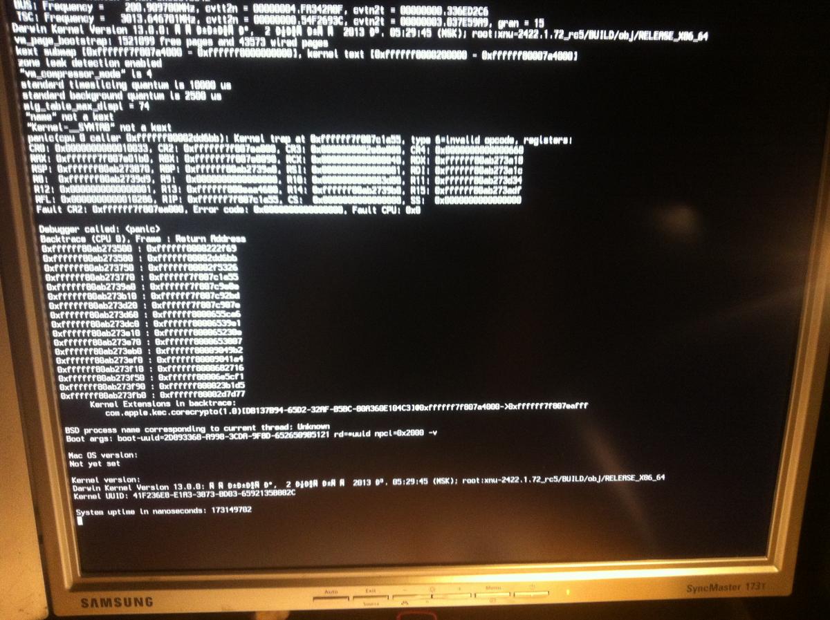

tragediana150 Posted November 2, 2013 Share Posted November 2, 2013 Updated . I delete amdtlbfix and fixed cpuid.c . Try ! mach_RC5_with_SECURE_test.zip I've got KP like this This is booting to the installed system. Tried npci=0x2000 -v -x USBLegacyOff fsb=200 combination. Always the same. Link to comment https://www.insanelymac.com/forum/topic/281450-mavericks-kernel-testing-on-amd-formerly-mountain-lion-kernel-testing-on-amd/page/147/#findComment-1962565 Share on other sites More sharing options...
Bronya Posted November 2, 2013 Share Posted November 2, 2013 I've got KP like this This is booting to the installed system. Tried npci=0x2000 -v -x USBLegacyOff fsb=200 combination. Always the same. You need replace kext to anv corecrypto.kext . Link to comment https://www.insanelymac.com/forum/topic/281450-mavericks-kernel-testing-on-amd-formerly-mountain-lion-kernel-testing-on-amd/page/147/#findComment-1962568 Share on other sites More sharing options...
tragediana150 Posted November 2, 2013 Share Posted November 2, 2013 You need replace kext to anv corecrypto.kext . OOOH I forgot about it I am sorry. And thank you Link to comment https://www.insanelymac.com/forum/topic/281450-mavericks-kernel-testing-on-amd-formerly-mountain-lion-kernel-testing-on-amd/page/147/#findComment-1962569 Share on other sites More sharing options...
