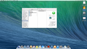

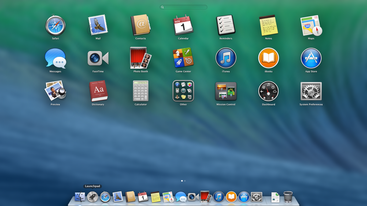

AkimoA Posted November 1, 2013 Share Posted November 1, 2013 latest one seems pretty good 1st time i could use chrome to browse at all http://cl.ly/image/3J2o3f013U2e/o no Artifacts at 1st login on GUI either iphoto loads up fine shows all pics nice 1 Link to comment https://www.insanelymac.com/forum/topic/281450-mavericks-kernel-testing-on-amd-formerly-mountain-lion-kernel-testing-on-amd/page/143/#findComment-1962096 Share on other sites More sharing options...

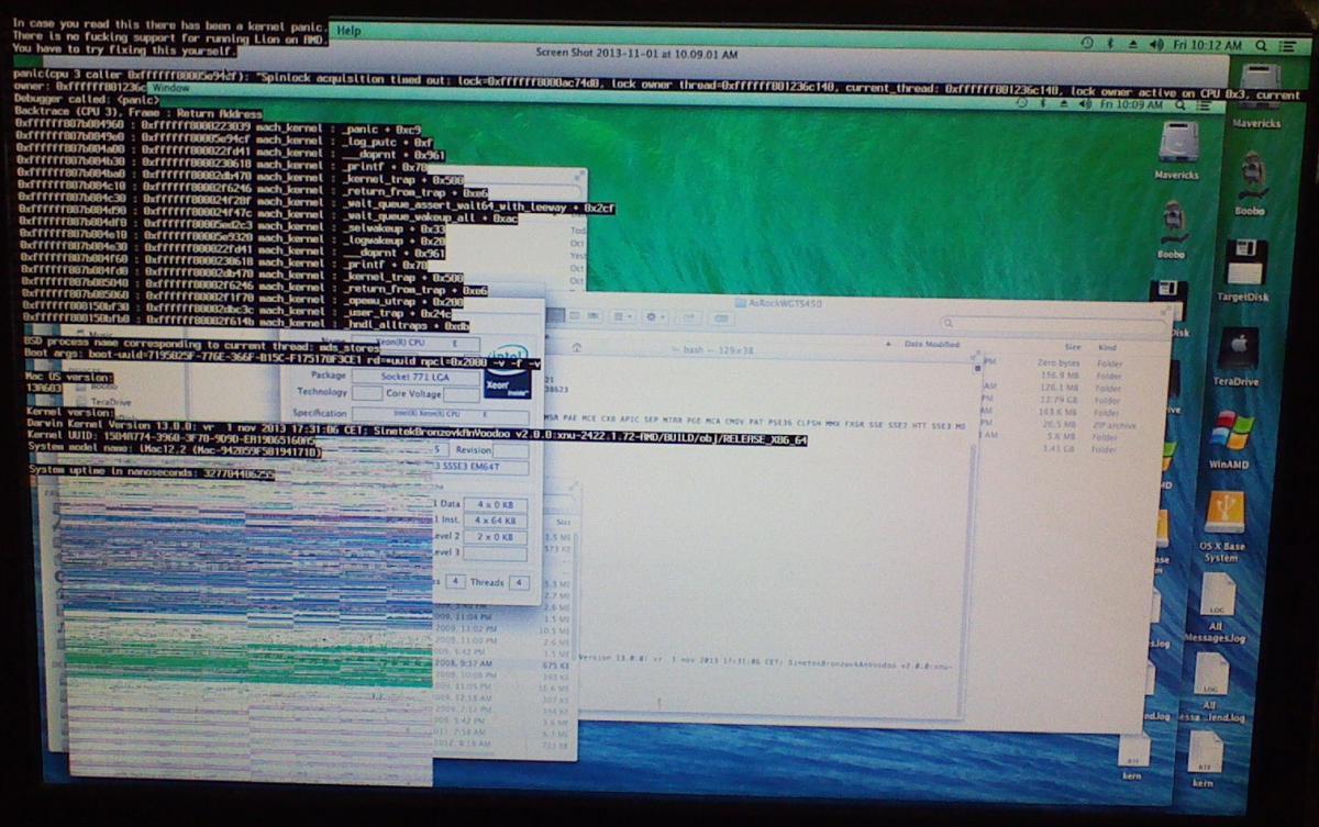

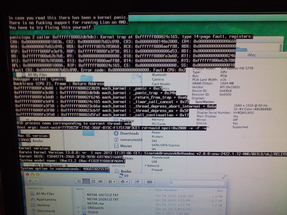

aplIIc Posted November 1, 2013 Share Posted November 1, 2013 Got this when opening a screenshot in Preview. -phenom II x4 b50- I believe everything is configed correctly w/ latest kernel chimera 2.2 boot: only other kext that ive got is suerviaata... hope it helps 1 Link to comment https://www.insanelymac.com/forum/topic/281450-mavericks-kernel-testing-on-amd-formerly-mountain-lion-kernel-testing-on-amd/page/143/#findComment-1962106 Share on other sites More sharing options...

Andy Vandijck Posted November 1, 2013 Share Posted November 1, 2013 Got this when opening a screenshot in Preview. -phenom II x4 b50- I believe everything is configed correctly w/ latest kernel chimera 2.2 boot: knprpnc.png only other kext that ive got is suerviaata... hope it helps It might... I'm compiling a new kernel now... Try this one... I modded the routines in the wait queues mach_kernel.zip SinetekBronzovkAnVoodoo_RC4.diff.zip 1 Link to comment https://www.insanelymac.com/forum/topic/281450-mavericks-kernel-testing-on-amd-formerly-mountain-lion-kernel-testing-on-amd/page/143/#findComment-1962116 Share on other sites More sharing options...

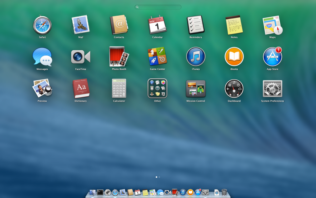

Mohamed Khairy Posted November 1, 2013 Share Posted November 1, 2013 your kernel nearly ignores cache auto ? icons on launchpad now with bronya kernel becomes green 3 Link to comment https://www.insanelymac.com/forum/topic/281450-mavericks-kernel-testing-on-amd-formerly-mountain-lion-kernel-testing-on-amd/page/143/#findComment-1962126 Share on other sites More sharing options...

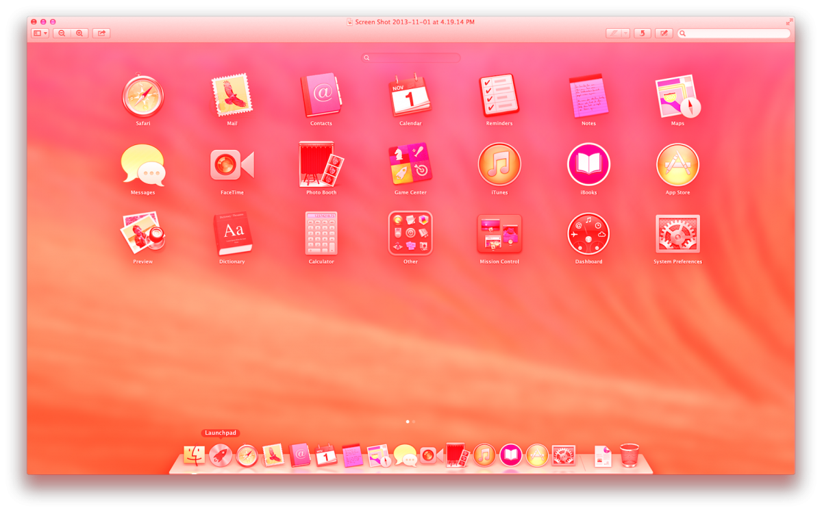

theconnactic Posted November 1, 2013 Author Share Posted November 1, 2013 Here it works with Andy's first successful kernel. The most relevant issue to report: no artifacts at all. Not a single one. This seems to confirm the HD5450 Silent model (dev. ID 68F91002) as the most reliable choice for 64-bit OSX with AMD CPUs to date. I will post pictures as soon as i install network drivers on the machine. Stay tuned. All the best! P.S.: and it shuts down like lightning. Starting up, though... 1 Link to comment https://www.insanelymac.com/forum/topic/281450-mavericks-kernel-testing-on-amd-formerly-mountain-lion-kernel-testing-on-amd/page/143/#findComment-1962134 Share on other sites More sharing options...

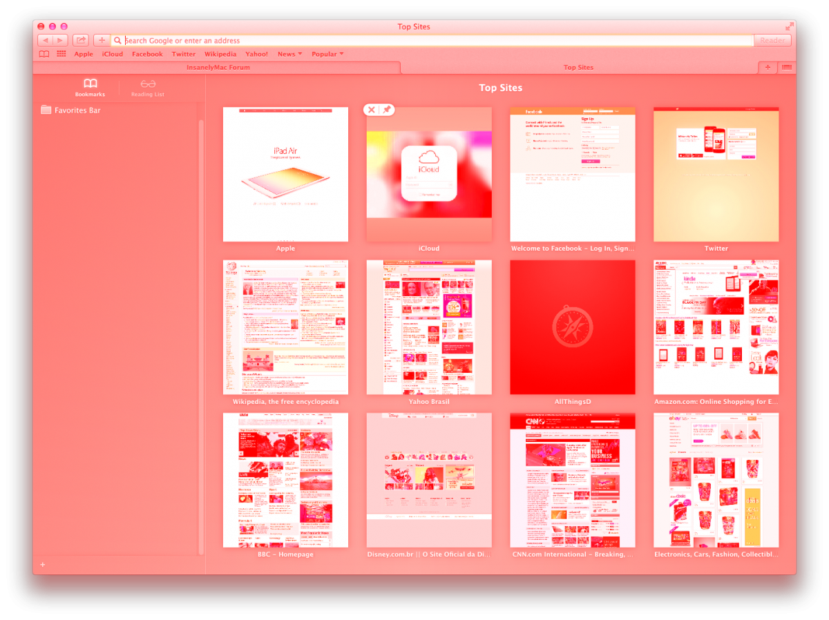

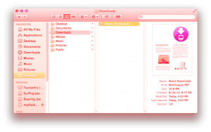

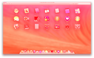

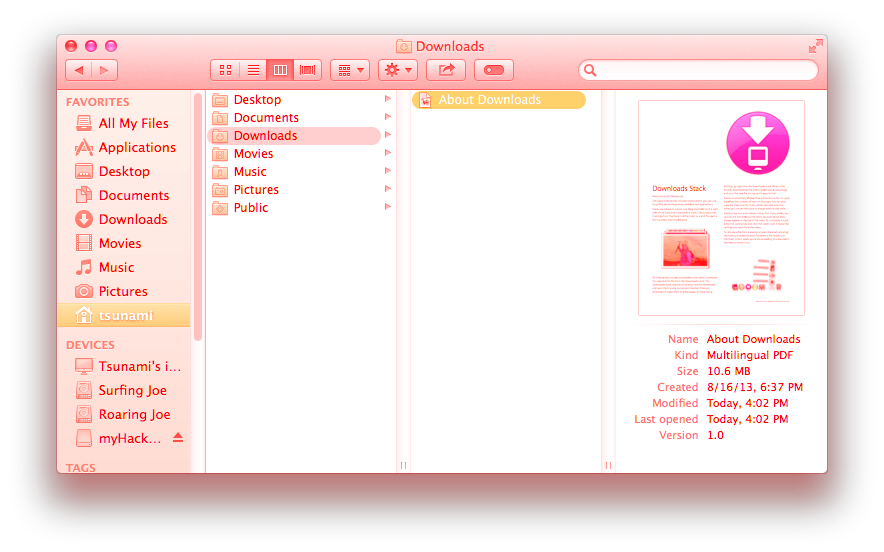

theconnactic Posted November 1, 2013 Author Share Posted November 1, 2013 P.P.S.: first glitches detected: quick time movies simply refuse to open (VLC and MPlayerX do well). I took a screenshot of the notification center - which works fine without a single artifact - and the resulting image was pink - even the thumbnail. In fact, other thumbnails and screenshots seems to suffer from the issue, despite the resulting pic not to be representative of the real image displayed in Preview.app or coverflow/quick look. Safari has the soup of letters bug, but some sites are quite usable, such as Insanelymac. Uploading screenshots: ---> the original screen is perfectly rendered, why isn't the screenshot accurate? ---> this pic is accurate, in fact the Launchpad is simply gorgeous here; --> another accurate pic. Notice file preview works as should; --> inaccurate: Safari's start screen is properly displayed, but appears pink in the screenshot. To enable debug in Safari's menu bar, run the terminal commands defaults write com.apple.Safari IncludeInternalDebugMenu -bool TRUE (credits to Duran Keeley); --> screenshot of an accurate screenshot being opened by Preview.app. This pic is inaccurate: the real image is displayed properly by Preview. I'll keep on reporting! And the latest?I am curious to compare... I'll try this kernel extensively first, for the sake of an unbiased comparison. 1 Link to comment https://www.insanelymac.com/forum/topic/281450-mavericks-kernel-testing-on-amd-formerly-mountain-lion-kernel-testing-on-amd/page/143/#findComment-1962145 Share on other sites More sharing options...

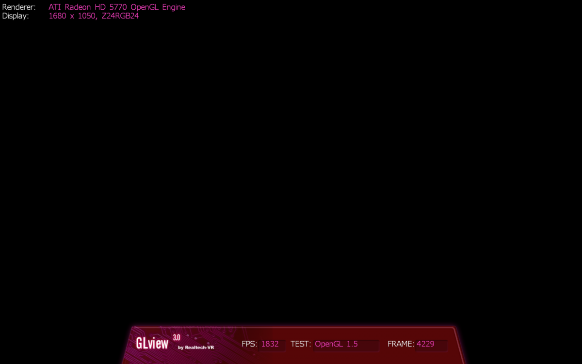

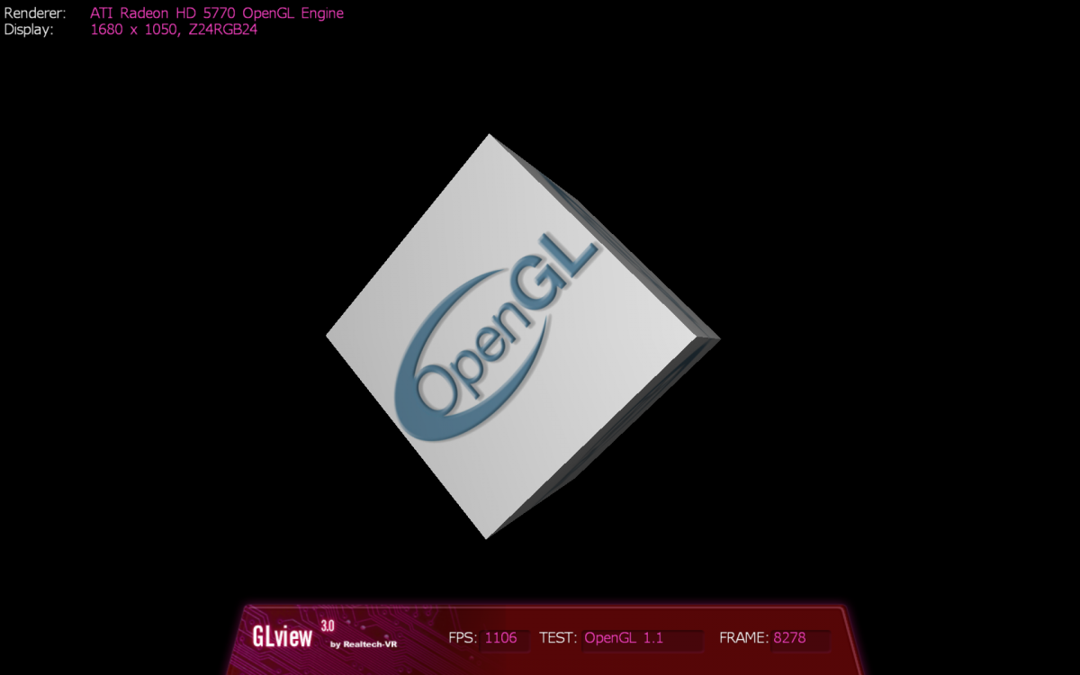

aplIIc Posted November 1, 2013 Share Posted November 1, 2013 With latest (and previous ones as well) on my 5770 I have not gotten any differing color issues; screenshots or otherwise... almost all issues are that they are either non-rendered or garbled. Launchpad ok Screenshot all proper rendering OK until GL 1.4 beyond GL 1.5 non-rendered here i get a panic but I cannot photograph... Link to comment https://www.insanelymac.com/forum/topic/281450-mavericks-kernel-testing-on-amd-formerly-mountain-lion-kernel-testing-on-amd/page/143/#findComment-1962159 Share on other sites More sharing options...
Bronya Posted November 1, 2013 Share Posted November 1, 2013 With latest (and previous ones as well) on my 5770 I have not gotten any differing color issues; screenshots or otherwise... almost all issues are that they are either non-rendered or garbled. here i get a panic but I cannot photograph... It is with what kernel ?? Andy or Bronya rc4? Link to comment https://www.insanelymac.com/forum/topic/281450-mavericks-kernel-testing-on-amd-formerly-mountain-lion-kernel-testing-on-amd/page/143/#findComment-1962163 Share on other sites More sharing options...

aplIIc Posted November 1, 2013 Share Posted November 1, 2013 I was wrong this is Andys's kernel rc4... and sound has been working all the time but probably because I've got a USB dongle for sound Yeah... I get the very same issues in ML..... no openGL rendering above GL 1.4 but I do get somewhat garbled images or non rendered but not color issues on 10.9. Link to comment https://www.insanelymac.com/forum/topic/281450-mavericks-kernel-testing-on-amd-formerly-mountain-lion-kernel-testing-on-amd/page/143/#findComment-1962178 Share on other sites More sharing options...
