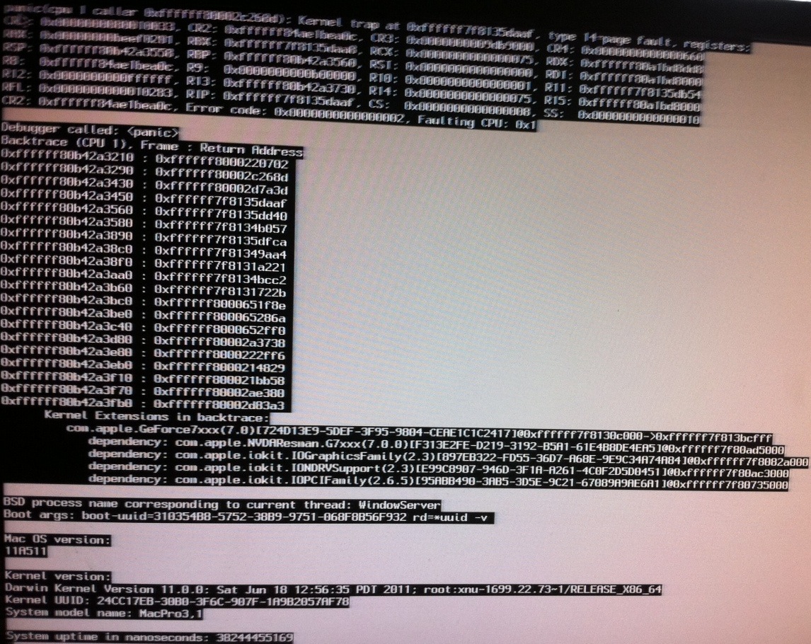

xxxrootxxx Posted July 28, 2011 Share Posted July 28, 2011 Hi, tried to install Lion on my system ( step by step ... great manual ... thumps up). After installing and finalizing, booting stops with the errors on the screenshot... System: Mainboard: Gigabyte P35-DS4 F14 CPU: Intel Core 2 Duo 2,66 GHz Grafic: XFX Geforce 7600GT Fatal1ty Silent RAM: 6 GB Is it possible that the grafic card is not working with 64 bit? thx for your help... greetz Link to comment https://www.insanelymac.com/forum/topic/259068-guide-a-fast-and-easy-way-to-install-lion/page/13/#findComment-1724764 Share on other sites More sharing options...

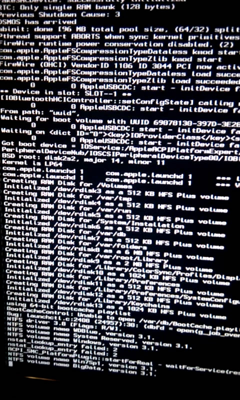

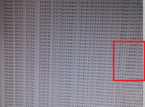

mcbyte_it Posted July 29, 2011 Share Posted July 29, 2011 I followed this guide, and I got a bootable usb drive, when I boot from it, it starts, loads a lot of kexts, then the kernel starts with its stuff, till this screen below, then the screen goes black and freezes there. I have the system as in my signature, SandyBrige Asus P8P67, i5 2500k, HD 4670, 2 SATA drives in AHCI mode. I saw posts about starting with -v or -x parameters, were do i put these commands? what else can I do? I was able to install SnowLeopard in a virtual machine, and it is working, from it I executed the mkinstall to create the usb drive. Link to comment https://www.insanelymac.com/forum/topic/259068-guide-a-fast-and-easy-way-to-install-lion/page/13/#findComment-1725322 Share on other sites More sharing options...
tseug Posted July 29, 2011 Author Share Posted July 29, 2011 I followed this guide, and I got a bootable usb drive, when I boot from it, it starts, loads a lot of kexts, then the kernel starts with its stuff, till this screen below, then the screen goes black and freezes there. I have the system as in my signature, SandyBrige Asus P8P67, i5 2500k, HD 4670, 2 SATA drives in AHCI mode. I saw posts about starting with -v or -x parameters, were do i put these commands? what else can I do? I was able to install SnowLeopard in a virtual machine, and it is working, from it I executed the mkinstall to create the usb drive. Please take a look at the error reporting section of the guide. Specifically: "Report whether the graphics card is reported as working in the thread mentioned above.". Anyway, your graphics card is the most likely candidate for your issues. Link to comment https://www.insanelymac.com/forum/topic/259068-guide-a-fast-and-easy-way-to-install-lion/page/13/#findComment-1725337 Share on other sites More sharing options...
mcbyte_it Posted July 29, 2011 Share Posted July 29, 2011 Please take a look at the error reporting section of the guide. Specifically: "Report whether the graphics card is reported as working in the thread mentioned above.". Anyway, your graphics card is the most likely candidate for your issues. My graphic card is not in the list, but it is from the HD 4000/4600 series, and during the initial grey screen when the installer is loading kexts, i see: "Read HFS+ File: [hd(0,2)/System/Library/Extensions/ATI4600.......kext] in addition to some others like 4800, 5000, 6000. Other than that, i did not change anything on the usb drive, just a clean mkinstall. System spec are as in the signature, i5 2500k on Asus P8P67 Pro, no overclocking, all C states enabled, Turbo mode set to Auto, the video is Sapphire HD 4670 Ultimate 512MB (1002:9490) anyway, is this the symptom for an incompatible graphic card? I am willing to change the video card to something newer (not older), i was checking the ATI 6670 or 6770, are these compatible with Lion out-of-the-box? UPDATE: reading around about my video card and OSX, i found that the card itself is supported, but the DVI output is not supported (or need patches), so i connected a d-sub vga cable and after the kernel messages i got the install menus, and with the mbr patch applied to the usb drive, i was able to install on an MBR partition. now i need only to put the right drivers, as i have no audio, no lan, and who knows what else. Thanks for the mkinstall script. Link to comment https://www.insanelymac.com/forum/topic/259068-guide-a-fast-and-easy-way-to-install-lion/page/13/#findComment-1725346 Share on other sites More sharing options...
nathandw Posted July 29, 2011 Share Posted July 29, 2011 @xxxrootxxx: It IS your GFX. Try booting with argument arch=i386 That will fix it anyhow, but sleep won't work. A real solution would be buying a GeForce 8xxx or any later model. I was stuck on a 6600GT, same error. I got myself a new NV520GT for 40 bucks, which made my system work again. @everyone: In case of problems try the arch=i386 boot argument! Simply type the command when you see the Chameleon boot screen, when you select your partition/drive. Greetz! Link to comment https://www.insanelymac.com/forum/topic/259068-guide-a-fast-and-easy-way-to-install-lion/page/13/#findComment-1725351 Share on other sites More sharing options...
