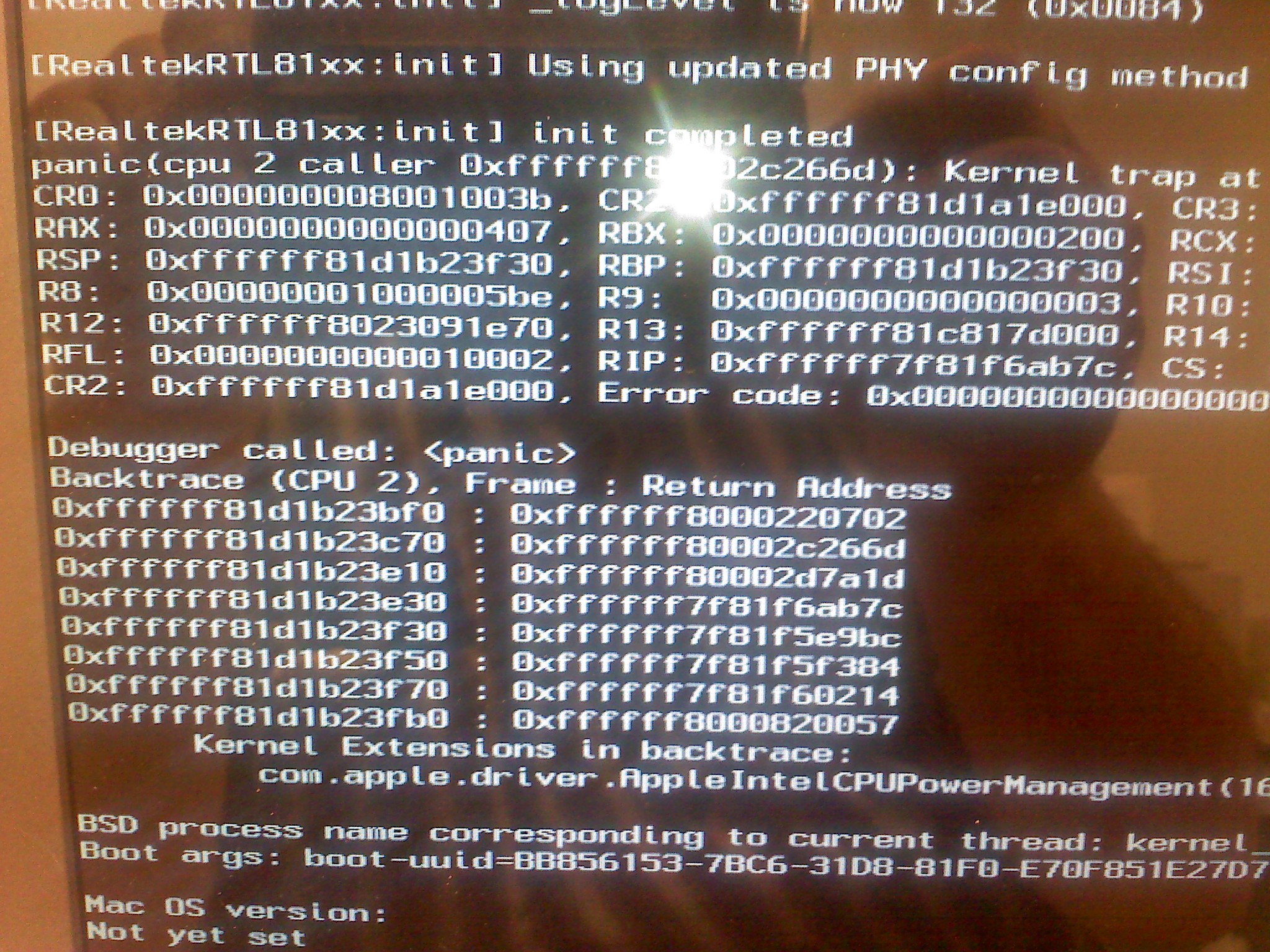

oSxFr33k Posted October 27, 2011 Share Posted October 27, 2011 @flAked, QUOTE: "If C-State configuration is locked in UEFI, then AICPUPM panics on boot and shows 0x2E in ECX in the verbose panic description." From this Asus G74SX the Kernel Trap is not ECX but rather RCX? Same 0xE2 though. Is this the reason why I cannot find the Bios String everyone else has posted in this thread? Pics: The string right after RCX is 0x0000000000000e2 Link to comment https://www.insanelymac.com/forum/topic/258611-speedstepper-now-supports-mountain-lion-1083/page/10/#findComment-1765400 Share on other sites More sharing options...
