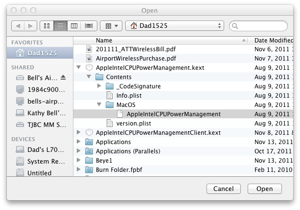

skyw00lker Posted November 3, 2011 Share Posted November 3, 2011 Where do I get the AppleCPUPowerManagement.kext I got the 166.0.0 on the installer usb but the 167.0.0 can't be found or anyone else on my computer. Link to comment https://www.insanelymac.com/forum/topic/258611-speedstepper-now-supports-mountain-lion-1083/page/11/#findComment-1767195 Share on other sites More sharing options...

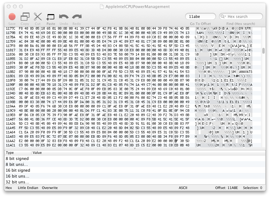

SteveRings Posted November 16, 2011 Share Posted November 16, 2011 anybody please update the patcher for 10.7.3 new beta, thanks I hesitate to post a patcher as it is not mine. The addresses which appear to be equivalent in the AICPUPM 167.2.0 are: 9D1A 9DE2 9E60 9EA9 A764 <--<< I pulled this out (changed back to 0F30) as it does not appear to be a wrmsr ... A816 A8F4 AF40 1130A 113E8 This whole process won't take more than 10 minutes if you follow my instructions: http://www.suavetech.com/0xed/0xed.html 1) Download the 0xED.app editor from link above. 2) Place a copy of the entire AICPUPM.kext on your desktop. 3) Open the 0xED (you can do this from you Downloads folder if you wish) editor and using the File menu, open the binary inside the kext (the Open will drill down into the kext just like it was a normal folder) (Picture 1, below). 4) Go to the Edit menu, Write Mode and set to Overwrite 5) Type each address into the Go To Offset box 6) Verify that the two bytes are 0f30 (this means your address was correct) and type 9090 (just type, the cursor will advance for you) (Picture 2, below). 7) Repeat steps 5 & 6 nine times (I find that AF64 is not a necessary address but it works either way) 8) Press the big red save button - the binary will be replaced in the kext. 9) Exit 0xED.app 10) Install the kext with Kext Helper b7.app or whatever you use. Finished! Picture 1: Picture 2: As flAked is the author, if you have issues, it is probably best to wait for him to respond. You use these at your risk as I have limited knowledge on the subject. Link to comment https://www.insanelymac.com/forum/topic/258611-speedstepper-now-supports-mountain-lion-1083/page/11/#findComment-1771283 Share on other sites More sharing options...

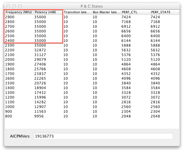

kishunv Posted November 26, 2011 Share Posted November 26, 2011 Does anyone know how we would enable turbo boost? Use you own p-states in dsdt For example section for mine i5-2410M Scope (_PR) { Processor (CPU0, 0x01, 0x00004010, 0x06) { Name (_CST, Package (0x03) { 0x02, Package (0x04) { ResourceTemplate () { Register (FFixedHW, 0x01, // Bit Width 0x02, // Bit Offset 0x0100000000000000, // Address ,) }, One, One, 0x03E8 }, Package (0x04) { ResourceTemplate () { Register (FFixedHW, 0x01, // Bit Width 0x02, // Bit Offset 0x0300000000000020, // Address ,) }, 0x03, 0x60, 0x015E } }) Name (_PSS, Package (0x16) { Package (0x06) { 0x0B54, 0x88B8, 0x0A, 0x0A, 0x1D00, 0x1D00 }, Package (0x06) { 0x0AF0, 0x88B8, 0x0A, 0x0A, 0x1C00, 0x1C00 }, Package (0x06) { 0x0A8C, 0x88B8, 0x0A, 0x0A, 0x1B00, 0x1B00 }, Package (0x06) { 0x0A28, 0x88B8, 0x0A, 0x0A, 0x1A00, 0x1A00 }, Package (0x06) { 0x09C4, 0x88B8, 0x0A, 0x0A, 0x1900, 0x1900 }, Package (0x06) { 0x0960, 0x88B8, 0x0A, 0x0A, 0x1800, 0x1800 }, Package (0x06) { 0x08FC, 0x88B8, 0x0A, 0x0A, 0x1700, 0x1700 }, Package (0x06) { 0x0898, 0x8068, 0x0A, 0x0A, 0x1600, 0x1600 }, Package (0x06) { 0x0834, 0x7997, 0x0A, 0x0A, 0x1500, 0x1500 }, Package (0x06) { 0x07D0, 0x7197, 0x0A, 0x0A, 0x1400, 0x1400 }, Package (0x06) { 0x076C, 0x6B0E, 0x0A, 0x0A, 0x1300, 0x1300 }, Package (0x06) { 0x0708, 0x64A6, 0x0A, 0x0A, 0x1200, 0x1200 }, Package (0x06) { 0x06A4, 0x5D1D, 0x0A, 0x0A, 0x1100, 0x1100 }, Package (0x06) { 0x0640, 0x56F9, 0x0A, 0x0A, 0x1000, 0x1000 }, Package (0x06) { 0x05DC, 0x50F6, 0x0A, 0x0A, 0x0F00, 0x0F00 }, Package (0x06) { 0x0578, 0x49D8, 0x0A, 0x0A, 0x0E00, 0x0E00 }, Package (0x06) { 0x0514, 0x4418, 0x0A, 0x0A, 0x0D00, 0x0D00 }, Package (0x06) { 0x04B0, 0x3E7C, 0x0A, 0x0A, 0x0C00, 0x0C00 }, Package (0x06) { 0x044C, 0x37CA, 0x0A, 0x0A, 0x0B00, 0x0B00 }, Package (0x06) { 0x03E8, 0x326B, 0x0A, 0x0A, 0x0A00, 0x0A00 }, Package (0x06) { 0x0384, 0x2D2B, 0x0A, 0x0A, 0x0900, 0x0900 }, Package (0x06) { 0x0320, 0x26E4, 0x0A, 0x0A, 0x0800, 0x0800 } }) Method (_PPC, 0, NotSerialized) { Return (Zero) } } Processor (CPU1, 0x02, 0x00000410, 0x06) { Alias (^CPU0._CST, _CST) Alias (^CPU0._PSS, _PSS) Alias (^CPU0._PPC, _PPC) } Processor (CPU2, 0x03, 0x00000410, 0x06) { Alias (^CPU0._CST, _CST) Alias (^CPU0._PSS, _PSS) Alias (^CPU0._PPC, _PPC) } Processor (CPU3, 0x04, 0x00000410, 0x06) { Alias (^CPU0._CST, _CST) Alias (^CPU0._PSS, _PSS) Alias (^CPU0._PPC, _PPC) } Processor (CPU4, 0x05, 0x00000410, 0x06) { } Processor (CPU5, 0x06, 0x00000410, 0x06) { } Processor (CPU6, 0x07, 0x00000410, 0x06) { } Processor (CPU7, 0x08, 0x00000410, 0x06) { } } Upper step 0x0B54, 0x88B8, 0x0A, 0x0A, 0x1D00, 0x1D00 Link to comment https://www.insanelymac.com/forum/topic/258611-speedstepper-now-supports-mountain-lion-1083/page/11/#findComment-1773639 Share on other sites More sharing options...

jazzyguy Posted November 27, 2011 Share Posted November 27, 2011 Use you own p-states in dsdt For example section for mine i5-2410M Scope (_PR) { Processor (CPU0, 0x01, 0x00004010, 0x06) { Name (_CST, Package (0x03) { 0x02, Package (0x04) { ResourceTemplate () { Register (FFixedHW, 0x01, // Bit Width 0x02, // Bit Offset 0x0100000000000000, // Address ,) }, One, One, 0x03E8 }, Package (0x04) { ResourceTemplate () { Register (FFixedHW, 0x01, // Bit Width 0x02, // Bit Offset 0x0300000000000020, // Address ,) }, 0x03, 0x60, 0x015E } }) Name (_PSS, Package (0x16) { Package (0x06) { 0x0B54, 0x88B8, 0x0A, 0x0A, 0x1D00, 0x1D00 }, Package (0x06) { 0x0AF0, 0x88B8, 0x0A, 0x0A, 0x1C00, 0x1C00 }, Package (0x06) { 0x0A8C, 0x88B8, 0x0A, 0x0A, 0x1B00, 0x1B00 }, Package (0x06) { 0x0A28, 0x88B8, 0x0A, 0x0A, 0x1A00, 0x1A00 }, Package (0x06) { 0x09C4, 0x88B8, 0x0A, 0x0A, 0x1900, 0x1900 }, Package (0x06) { 0x0960, 0x88B8, 0x0A, 0x0A, 0x1800, 0x1800 }, Package (0x06) { 0x08FC, 0x88B8, 0x0A, 0x0A, 0x1700, 0x1700 }, Package (0x06) { 0x0898, 0x8068, 0x0A, 0x0A, 0x1600, 0x1600 }, Package (0x06) { 0x0834, 0x7997, 0x0A, 0x0A, 0x1500, 0x1500 }, Package (0x06) { 0x07D0, 0x7197, 0x0A, 0x0A, 0x1400, 0x1400 }, Package (0x06) { 0x076C, 0x6B0E, 0x0A, 0x0A, 0x1300, 0x1300 }, Package (0x06) { 0x0708, 0x64A6, 0x0A, 0x0A, 0x1200, 0x1200 }, Package (0x06) { 0x06A4, 0x5D1D, 0x0A, 0x0A, 0x1100, 0x1100 }, Package (0x06) { 0x0640, 0x56F9, 0x0A, 0x0A, 0x1000, 0x1000 }, Package (0x06) { 0x05DC, 0x50F6, 0x0A, 0x0A, 0x0F00, 0x0F00 }, Package (0x06) { 0x0578, 0x49D8, 0x0A, 0x0A, 0x0E00, 0x0E00 }, Package (0x06) { 0x0514, 0x4418, 0x0A, 0x0A, 0x0D00, 0x0D00 }, Package (0x06) { 0x04B0, 0x3E7C, 0x0A, 0x0A, 0x0C00, 0x0C00 }, Package (0x06) { 0x044C, 0x37CA, 0x0A, 0x0A, 0x0B00, 0x0B00 }, Package (0x06) { 0x03E8, 0x326B, 0x0A, 0x0A, 0x0A00, 0x0A00 }, Package (0x06) { 0x0384, 0x2D2B, 0x0A, 0x0A, 0x0900, 0x0900 }, Package (0x06) { 0x0320, 0x26E4, 0x0A, 0x0A, 0x0800, 0x0800 } }) Method (_PPC, 0, NotSerialized) { Return (Zero) } } Processor (CPU1, 0x02, 0x00000410, 0x06) { Alias (^CPU0._CST, _CST) Alias (^CPU0._PSS, _PSS) Alias (^CPU0._PPC, _PPC) } Processor (CPU2, 0x03, 0x00000410, 0x06) { Alias (^CPU0._CST, _CST) Alias (^CPU0._PSS, _PSS) Alias (^CPU0._PPC, _PPC) } Processor (CPU3, 0x04, 0x00000410, 0x06) { Alias (^CPU0._CST, _CST) Alias (^CPU0._PSS, _PSS) Alias (^CPU0._PPC, _PPC) } Processor (CPU4, 0x05, 0x00000410, 0x06) { } Processor (CPU5, 0x06, 0x00000410, 0x06) { } Processor (CPU6, 0x07, 0x00000410, 0x06) { } Processor (CPU7, 0x08, 0x00000410, 0x06) { } } Upper step 0x0B54, 0x88B8, 0x0A, 0x0A, 0x1D00, 0x1D00 I don't see what to put where? And where did you get that program from? Link to comment https://www.insanelymac.com/forum/topic/258611-speedstepper-now-supports-mountain-lion-1083/page/11/#findComment-1773805 Share on other sites More sharing options...
kishunv Posted November 27, 2011 Share Posted November 27, 2011 jazzyguy I don't see what to put where? - It's not easy way, you should find your own SSDT table with p-states(AIDA in Windows) and put p-states data in your dsdt.aml And where did you get that program from? - SMC Monitor, it show which p-states and c-state available. Link to comment https://www.insanelymac.com/forum/topic/258611-speedstepper-now-supports-mountain-lion-1083/page/11/#findComment-1773842 Share on other sites More sharing options...
