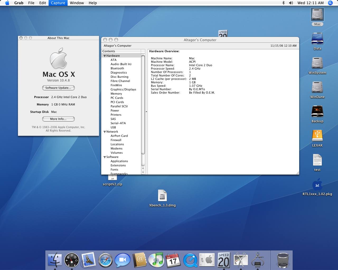

altagor Posted November 14, 2006 Share Posted November 14, 2006 Thanks for help. Now everything work perfectly! For other with problems: I instal from JAS 10.4.8, i check Combo, SSE3 with semthex kernel and G950 (dont check USB fix) after install i copy azalia kext to extensions install RTL1xxx (both as attachments) change rights for azalia: chown -R root:wheel appleazaliaaudio.kext chmod -R 755 appleazaliaaudio.kext remove cache: rm /system/library/extensions.mkext rm /system/library/extensions.kextcache and repair permision in bios audio must be set to ENABLE (no auto) For USB20 speed i instal IOUSBFamily (ftp://ftp.apple.com/developer/Development_Kits/Mac_OS_USB/IOUSBFamily-261.4.2(Intel)-log.dmg) Solve problems: 1.Crash in About this mac Applesmbios.kext from www.filefactory.com/file/3d1838 (in attachments) 2.low xbech results in com.Apple.boot.plist add fsb=xxx (in my case 300) 3.core 2 duo as core 2 single in bios MAXCPUID must be DISABLED I have E6400, my bios setings is For CPU: Overclock Mode CPU,PCIE Async CPU 300 PCIE 115 Boot Failure Guard Enable Spread spectrum Auto Enhanced Halt State Disable MAX CPUID Disable Intel Virtualization Enable CPU Thermal Enable No Execut Mem Protection Disable Intel Speed Strem Auto Memory i set to 333 Now my xbench is 136 IOUSBFamily.kext 2.6.1 is too large to post here (4MB). Link included in post install.rar test.txt Link to comment https://www.insanelymac.com/forum/topic/24637-asrock-conroe945g-dvi/page/20/#findComment-234428 Share on other sites More sharing options...
