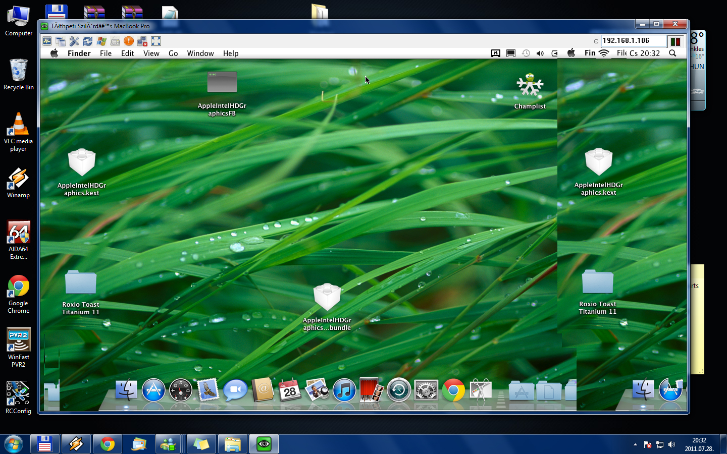

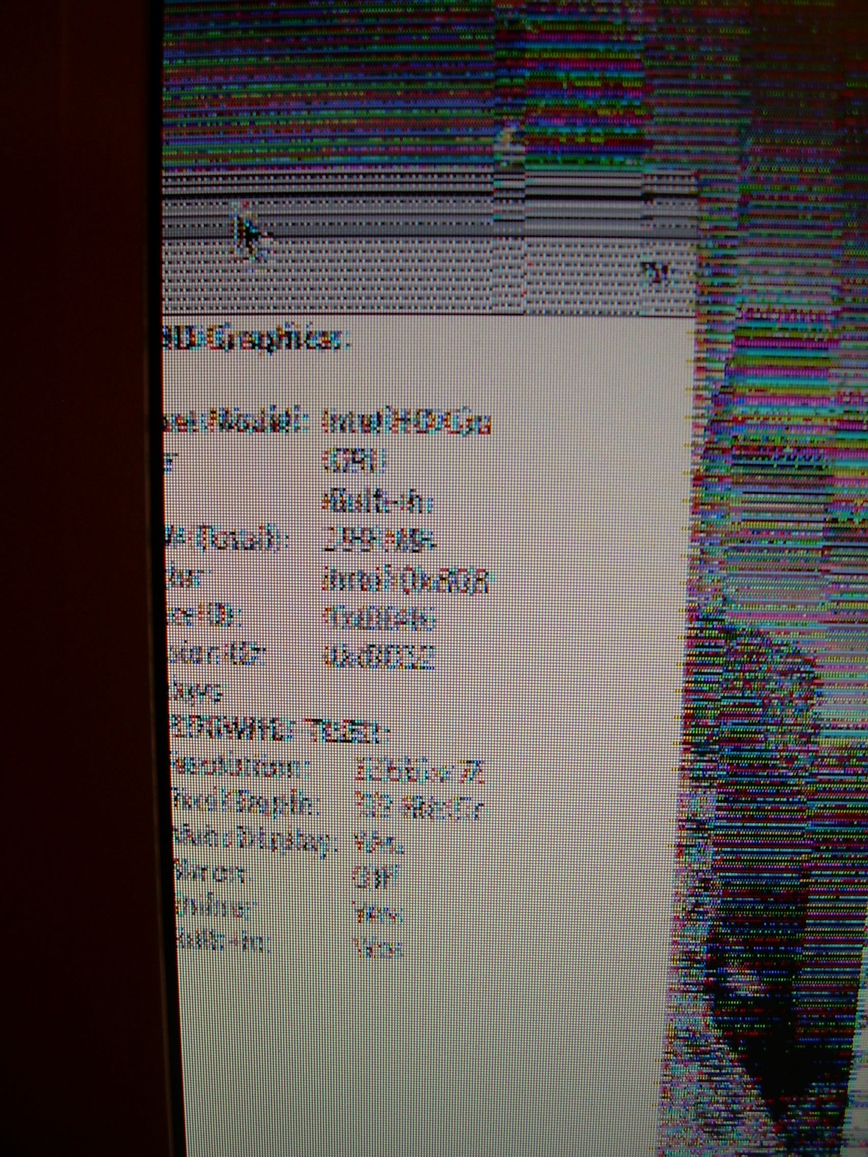

Today i did this
clean install of Lion (final)
then i took the file AppleIntelSNBGraphicsFB out of AppleIntelSNBGraphicsFB.kext/Contents/MacOS
renamed it to AppleIntelHDGraphicsFB
and put it into AppleIntelHDGraphicsFB.kext/Contents/MacOS
and now i have this = see attechment
and all extensions are loaded
before this i had a black screen too
@fmac
Nice try there.. Can u enable screen sharing and see if QE/CI is enabled? thanks..
QE/CI is not enabled
sorry

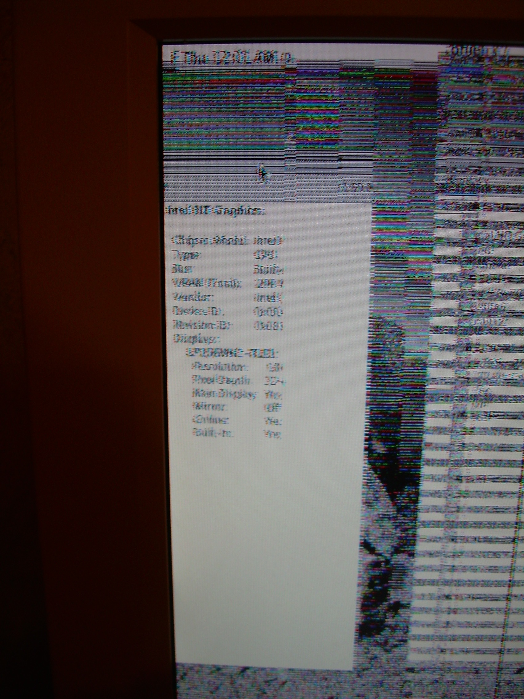

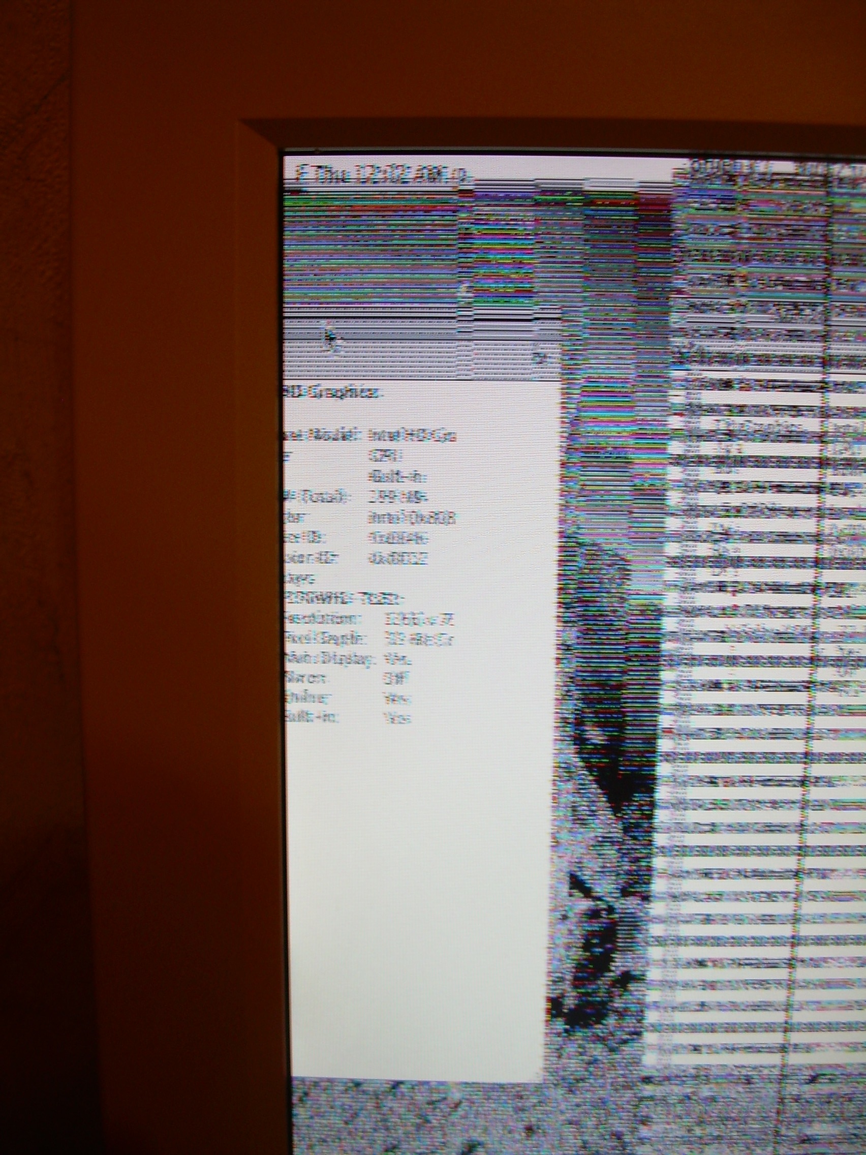

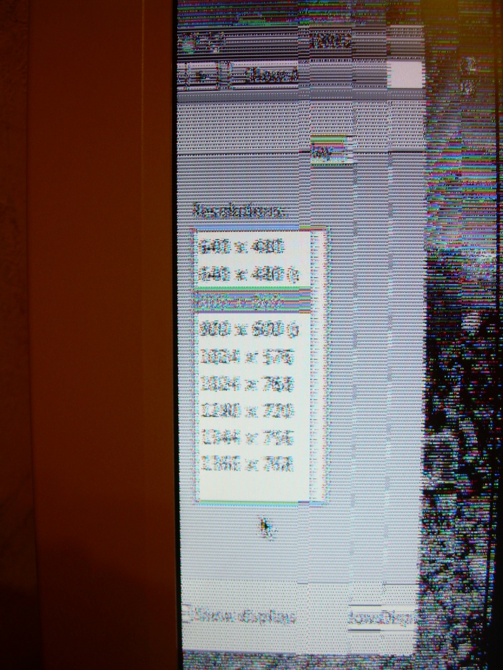

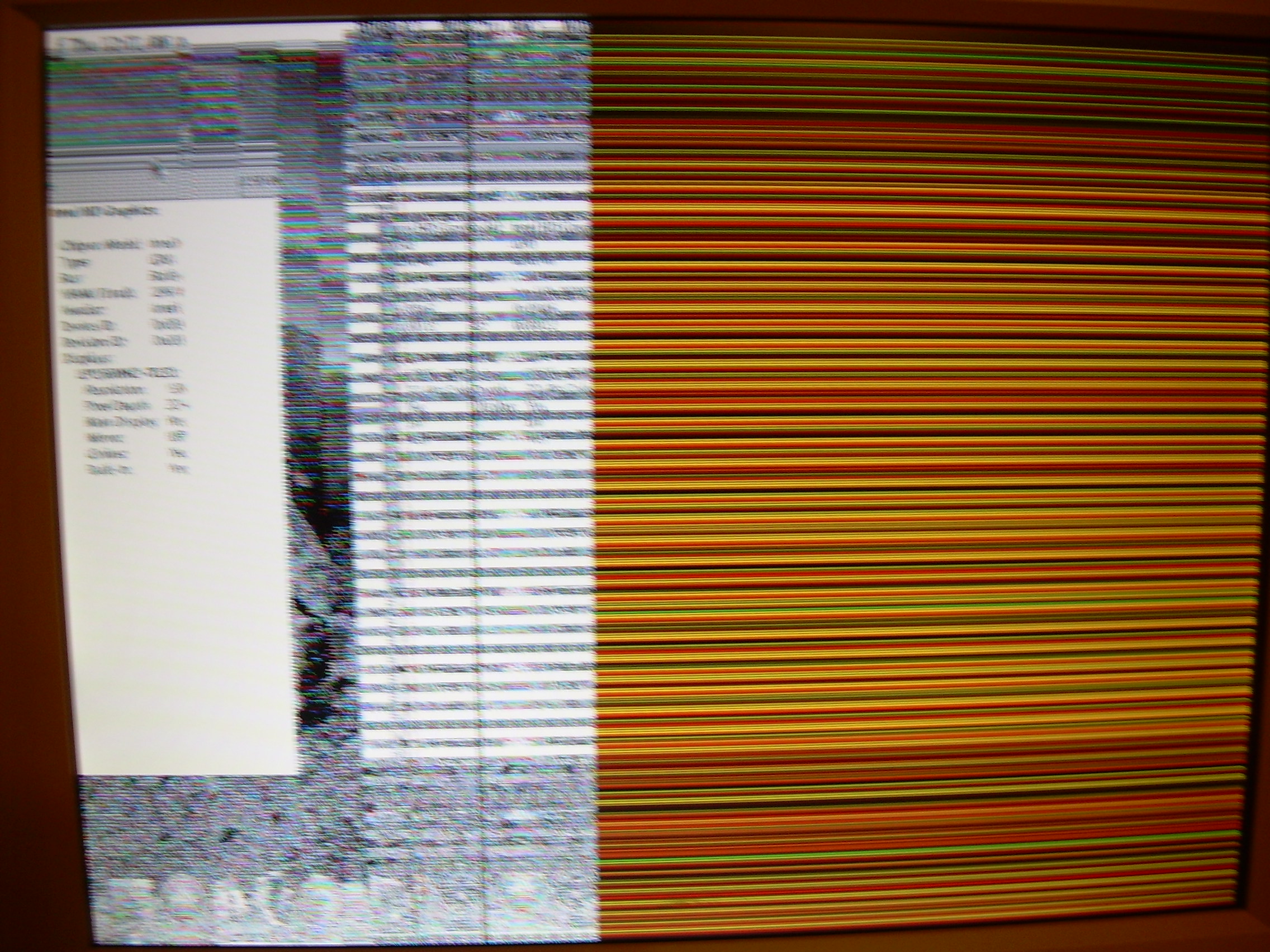

Hi!
I successfully got black screen on my laptop but only in safe mode = VNC not working
I connected an external monitor at boot (laptop screen is turned off) and when OS X booted up the internal monitor is turned to black, the external monitor gived me (a not too good) screen.
Custom resolution is worked and the internal LVDP is recognized!
I think we need to change connectorinfo, but I can't do it.
I made some pictures:
Hi!
change your monitor cable.
The cable is good, same result with another monitor and another cable... The external monitor is not recognized, only the internal, but the screen on the external.
I have VGA and HDMI connectors. The external monitor is on the VGA. I'll try with the HDMI...
I am using Snow Leopard 10.6.7 with the QE/CI kexts.
Edit: HDMI connector not working at all :/ I copied VGA info from System Information:
Xenon,
It's not cable or monitor problem - it's a timing issue. It would be good to extract current timing used hreq, vfreq and other but I am not sure if there is such utility available in OSX.
BTW, do you get native resolution in chameleon? Which chipset your laptop has?
Oki.
I got native res. only on external monitor in Chameleon. My laptop has got Intel HM55 chipset.
I think the problem is in the connectorinfo...Timing is wrong too, but the screen should to be on the internal monitor.
Edit: When I put only the Framebuffer to S/L/E , I can boot up system without "-x" -> ScreenSharing is working
