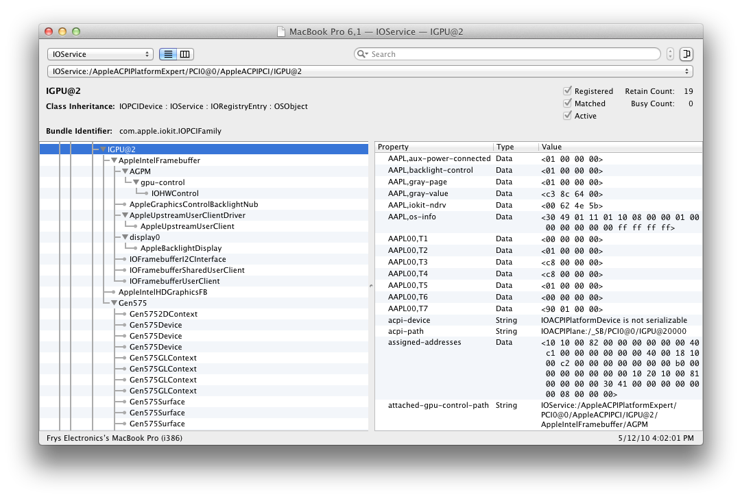

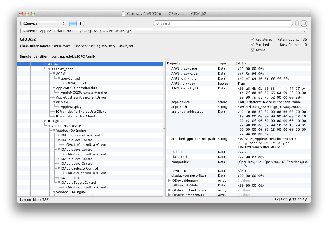

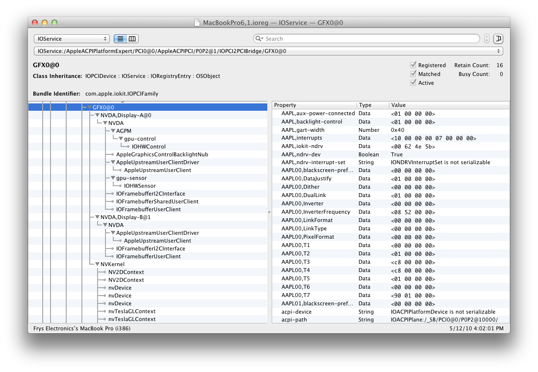

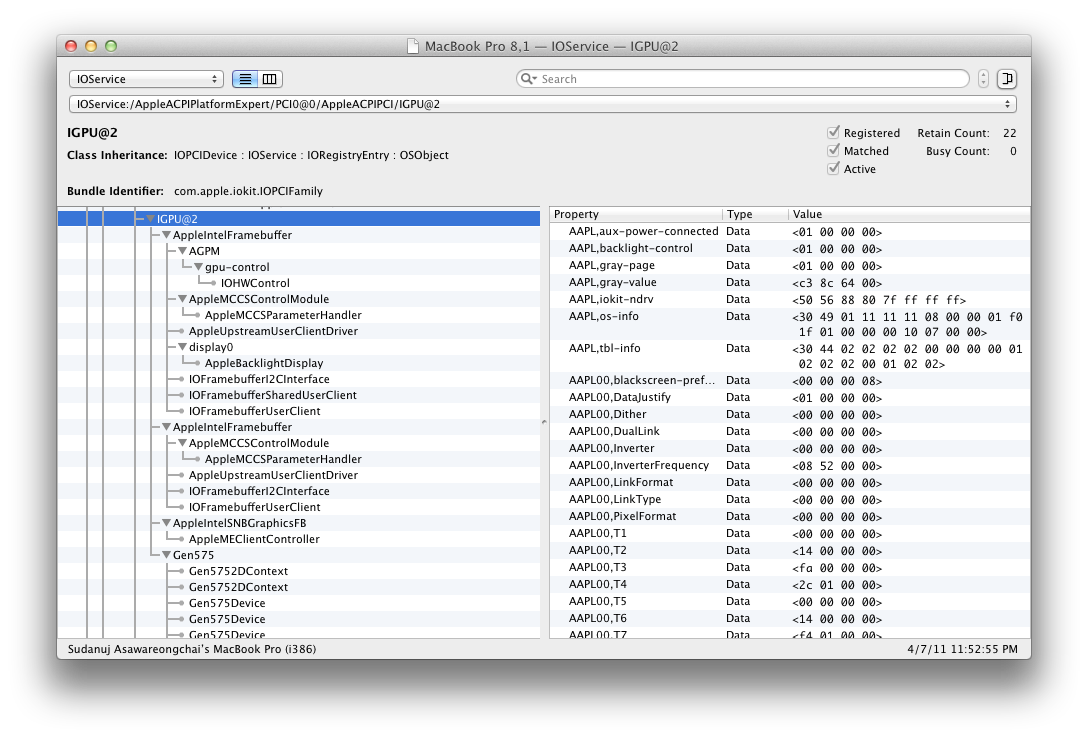

GhostRaider Posted August 18, 2011 Share Posted August 18, 2011 Hey guys, can I ask something? Well anyways I was looking at the IORegistry dumps from the official MacBook Pro 6,1 and MacBook Pro 8,1. I've noticed that both of these MacBook Pros refer Intel HD Graphics as "IGPU@2". See the screenshots below: On the MacBook Pro 6,1 there is a reference called GFX0@0 which is where the NVidia graphics card is located. However it seems that Intel HD Graphics can work by itself. On our hackintoshes, I'll use mine as an example, refers Intel HD Graphics as "GFX0@2". Can someone explain why is it referred to as GFX0@2? Anyways can this be changed in the DSDT? Maybe this is why Intel HD Graphics has difficulty detecting our display? Link to comment https://www.insanelymac.com/forum/topic/223754-intel-hd-graphics-gma-5700/page/47/#findComment-1736413 Share on other sites More sharing options...
XmodD Posted August 18, 2011 Share Posted August 18, 2011 was thinking about it too, but do not believe, that that makes a difference. Yes it can be changed by DSDT. Can u send me your DSDT part from IGPU / GFX ? Link to comment https://www.insanelymac.com/forum/topic/223754-intel-hd-graphics-gma-5700/page/47/#findComment-1736567 Share on other sites More sharing options...

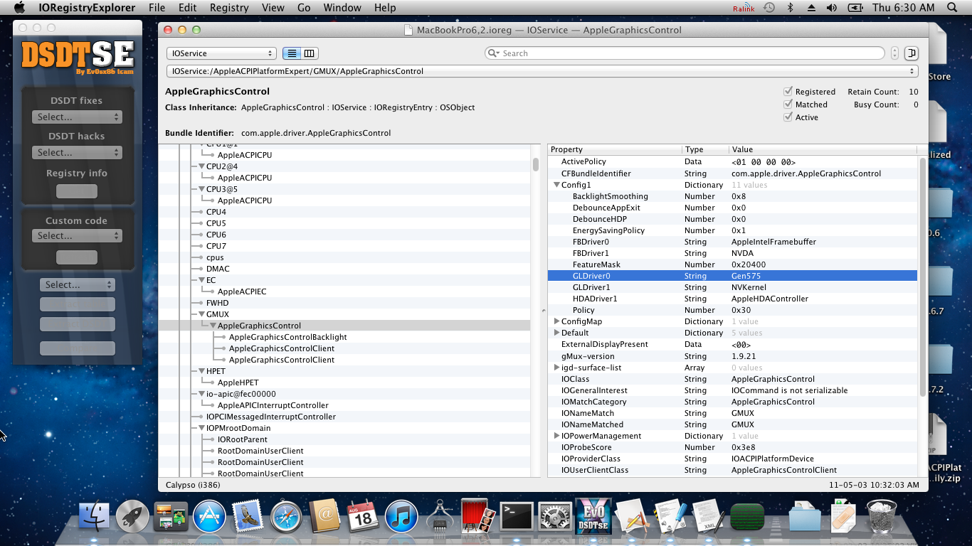

Luminadevapps Posted August 18, 2011 Share Posted August 18, 2011 Hi guys I thing this is v.impotant about GMUX We have to add DSDT I find MacBookPro 6.2 ioreg How can Any guide/Any idia? apple support https://discussions.apple.com/thread/242019...45&tstart=0 Link to comment https://www.insanelymac.com/forum/topic/223754-intel-hd-graphics-gma-5700/page/47/#findComment-1736625 Share on other sites More sharing options...
Luminadevapps Posted August 18, 2011 Share Posted August 18, 2011 Hi guys I thing this is v.impotant about GMUX We have to add DSDT I find MacBookPro 6.2 ioreg How can Any guide/Any idia? apple support https://discussions.apple.com/thread/242019...45&tstart=0 sample Intel HD Graphics: Chipset Model: Intel HD Graphics Type: GPU Bus: Built-In VRAM (Total): 288 MB Vendor: Intel (0x8086) Device ID: 0x0046 Revision ID: 0x0012 gMux Version: 1.9.21 Displays: Color LCD: Resolution: 1440 x 900 Pixel Depth: 32-Bit Color (ARGB8888) Main Display: Yes Mirror: Off Online: Yes Built-In: Yes Link to comment https://www.insanelymac.com/forum/topic/223754-intel-hd-graphics-gma-5700/page/47/#findComment-1736655 Share on other sites More sharing options...
GhostRaider Posted August 18, 2011 Share Posted August 18, 2011 Is GMUX really necessary even if we don't have a dedicated graphics card? Well anyways I think now is the time to install and test out GFXCardStatus. If you guys don't know GFXCardStatus is a little menubar utility that allows you to switch between NVidia dedicated graphics and Intel HD Graphics. GFXCardStatus Homepage As for this GMUX thing, well here is the code that you can add to your DSDT. This is from the original MacBook Pro 6,1 and MacBook Pro 6,2. Don't know if it will do anything. Device (GMUX) { Name (_HID, EisaId ("APP000B")) Name (_CID, "gmux") Name (_STA, 0x0B) Name (_CRS, ResourceTemplate () { IO (Decode16, 0x0700, // Range Minimum 0x07FF, // Range Maximum 0x01, // Alignment 0xFF, // Length ) }) Name (_PRW, Package (0x02) { 0x16, 0x03 }) Scope (\_GPE) { Method (_L16, 0, NotSerialized) { Notify (\_SB.PCI0.LPCB.GMUX, 0x80) } } Name (GMGP, 0x16) Method (GMSP, 1, NotSerialized) { If (LLessEqual (Arg0, 0x01)) { Or (GP06, Arg0, GP06) } } Method (GMLV, 0, NotSerialized) { Return (GP06) } } } Link to comment https://www.insanelymac.com/forum/topic/223754-intel-hd-graphics-gma-5700/page/47/#findComment-1736678 Share on other sites More sharing options...
sockerkid Posted August 18, 2011 Author Share Posted August 18, 2011 GFXCardstatus is about GMUX card switching. So if we wanted to use GFXCardStatus, we had to have GMUX loadded then only it will work.. Try looking in the source code of gfxcardstatus and u will find out GMUX handling, GMUX card switching.. If we put the GMUX code in our DSDT, its loaded in ioreg, u can refer post before this as people already tried to insert gmux in.. Refer : http://www.insanelymac.com/forum/lofiversi...223754-550.html Is GMUX really necessary even if we don't have a dedicated graphics card? Well anyways I think now is the time to install and test out GFXCardStatus. If you guys don't know GFXCardStatus is a little menubar utility that allows you to switch between NVidia dedicated graphics and Intel HD Graphics. GFXCardStatus Homepage As for this GMUX thing, well here is the code that you can add to your DSDT. This is from the original MacBook Pro 6,1 and MacBook Pro 6,2. Don't know if it will do anything. Device (GMUX) { Name (_HID, EisaId ("APP000B")) Name (_CID, "gmux") Name (_STA, 0x0B) Name (_CRS, ResourceTemplate () { IO (Decode16, 0x0700, // Range Minimum 0x07FF, // Range Maximum 0x01, // Alignment 0xFF, // Length ) }) Name (_PRW, Package (0x02) { 0x16, 0x03 }) Scope (\_GPE) { Method (_L16, 0, NotSerialized) { Notify (\_SB.PCI0.LPCB.GMUX, 0x80) } } Name (GMGP, 0x16) Method (GMSP, 1, NotSerialized) { If (LLessEqual (Arg0, 0x01)) { Or (GP06, Arg0, GP06) } } Method (GMLV, 0, NotSerialized) { Return (GP06) } } } Link to comment https://www.insanelymac.com/forum/topic/223754-intel-hd-graphics-gma-5700/page/47/#findComment-1736681 Share on other sites More sharing options...
Luminadevapps Posted August 18, 2011 Share Posted August 18, 2011 GFXCardstatus is about GMUX card switching. So if we wanted to use GFXCardStatus, we had to have GMUX loadded then only it will work.. Try looking in the source code of gfxcardstatus and u will find out GMUX handling, GMUX card switching.. If we put the GMUX code in our DSDT, its loaded in ioreg, u can refer post before this as people already tried to insert gmux in.. Refer : http://www.insanelymac.com/forum/lofiversi...223754-550.html when I add dsdt many errors can you add for me I upload my if you can. dsdt.rar Link to comment https://www.insanelymac.com/forum/topic/223754-intel-hd-graphics-gma-5700/page/47/#findComment-1736698 Share on other sites More sharing options...
