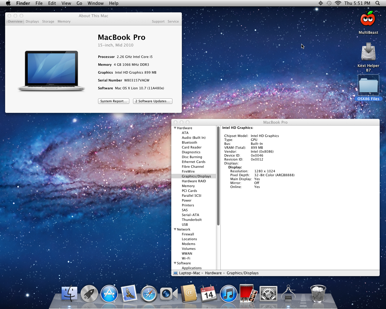

GhostRaider Posted July 15, 2011 Share Posted July 15, 2011 I'm wrong, or who has Revision ID: 0x0002 has correct resolution?Is there anyone with Revision ID: 0x0012 and the correct resolution? A few pages behind I showed you guys that my hackintosh displays custom resolution using an external monitor in OS X Snow Leopard. It still works in OS X Lion. As you can see, the Revision ID is 0x0012. So why is it that the external monitor can have custom resolutions? Is it because the EDID is read correctly, or is it hardware related? Link to comment https://www.insanelymac.com/forum/topic/223754-intel-hd-graphics-gma-5700/page/41/#findComment-1714838 Share on other sites More sharing options...

sjuut Posted July 15, 2011 Share Posted July 15, 2011 I have rev id 12 intelHD and GeForce 330m (optimus). I did NOT modify any kexts, just added manors' EFI string. I now have a video memory of 786mb, and _no_ message telling me that there is no kext loaded! My native resolution on Windows is 1600x900x32, but my OSX Lion only gives me 1280x800x32. If I specify in com.apple.Boot.plist a resolution of 1024x768, that will work, but anything other than those will distort the screen. My chameleon bootloader even shows that 1440x900 is supported, but unfortunately that screen is very messed up. So I stick to 1280x800. I have both HDMI and DisplayPort adapters in my laptop, but when testing the hdmi output, I do not get any other resolution modes available. Im gonna get myself a displayport-hdmi or displayport-vga adapter, and test that. Today I will try modifying my EDID, I found a tool on Windows that will extract it (ELDIM EDIDviewer) Link to comment https://www.insanelymac.com/forum/topic/223754-intel-hd-graphics-gma-5700/page/41/#findComment-1714957 Share on other sites More sharing options...

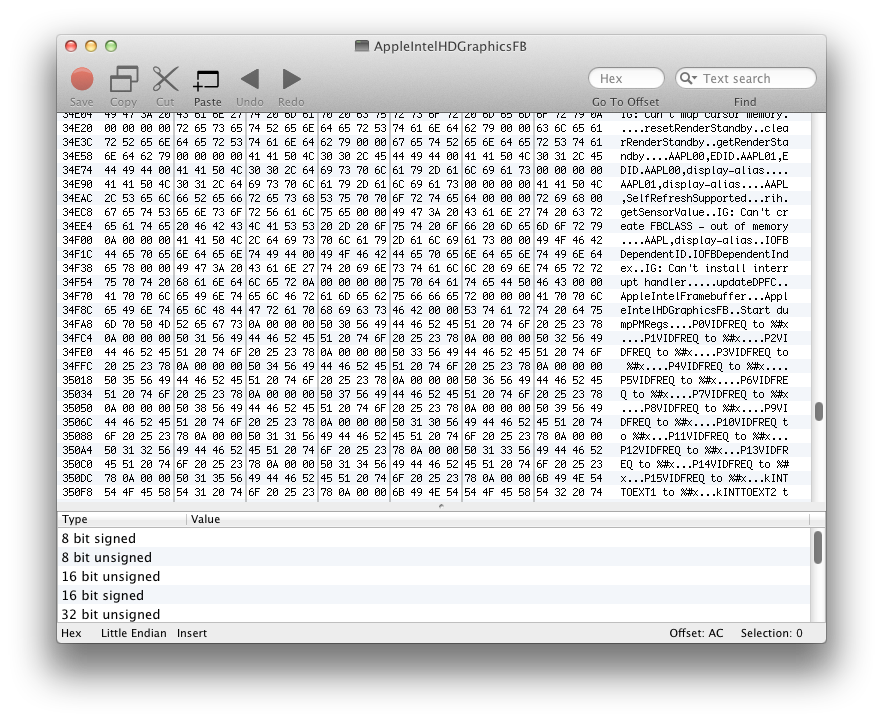

GhostRaider Posted July 15, 2011 Share Posted July 15, 2011 Anyone here has any experience on how to edit kexts? I don't mean the info.plist but the actual binary file which controls the kext? AppleIntelHDGraphicsFB Kext Yes I know it looks scary but I do see interesting info. How does Apple make these? Link to comment https://www.insanelymac.com/forum/topic/223754-intel-hd-graphics-gma-5700/page/41/#findComment-1715257 Share on other sites More sharing options...

morkb Posted July 17, 2011 Share Posted July 17, 2011 Anyone here has any experience on how to edit kexts? I don't mean the info.plist but the actual binary file which controls the kext? AppleIntelHDGraphicsFB Kext Yes I know it looks scary but I do see interesting info. How does Apple make these? you have to try with IDA pro dissasembler in windows..it can dissasembler the macosx binary then you will get a partial assembler list with all conditions and instructions displayed also in a graphic view I've tried to change some jump if equal zero in jump if not zero end viceversa...then when you get the hex sequences you open an hex editor and change the values from that...and try to load the changed kext...so far I get...nothing..no luck...but it's a huge work.....I gave up... Link to comment https://www.insanelymac.com/forum/topic/223754-intel-hd-graphics-gma-5700/page/41/#findComment-1716169 Share on other sites More sharing options...

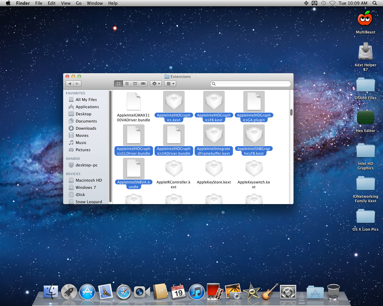

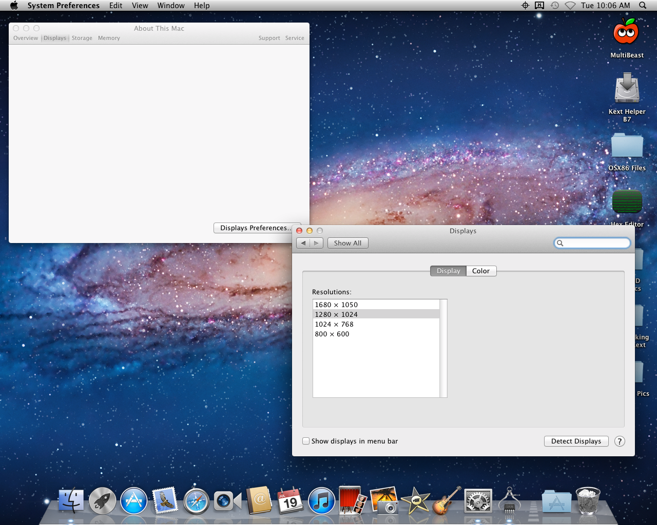

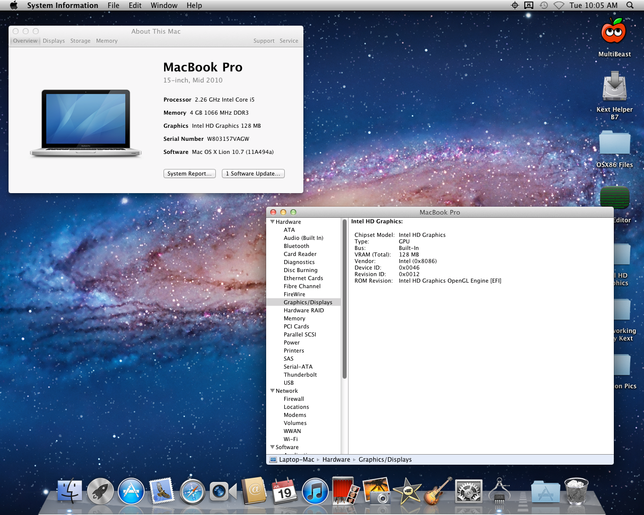

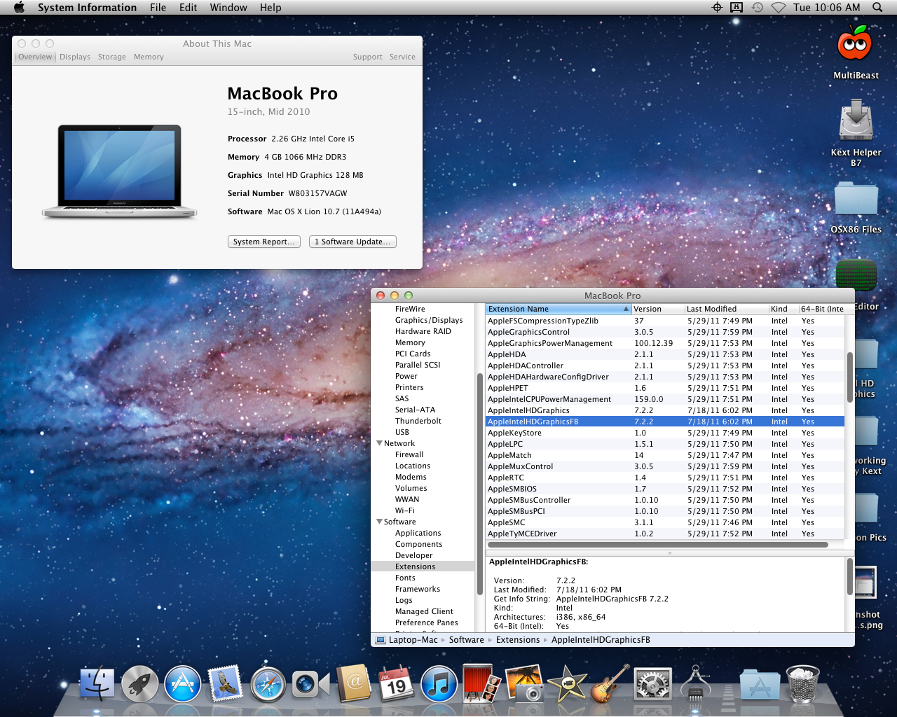

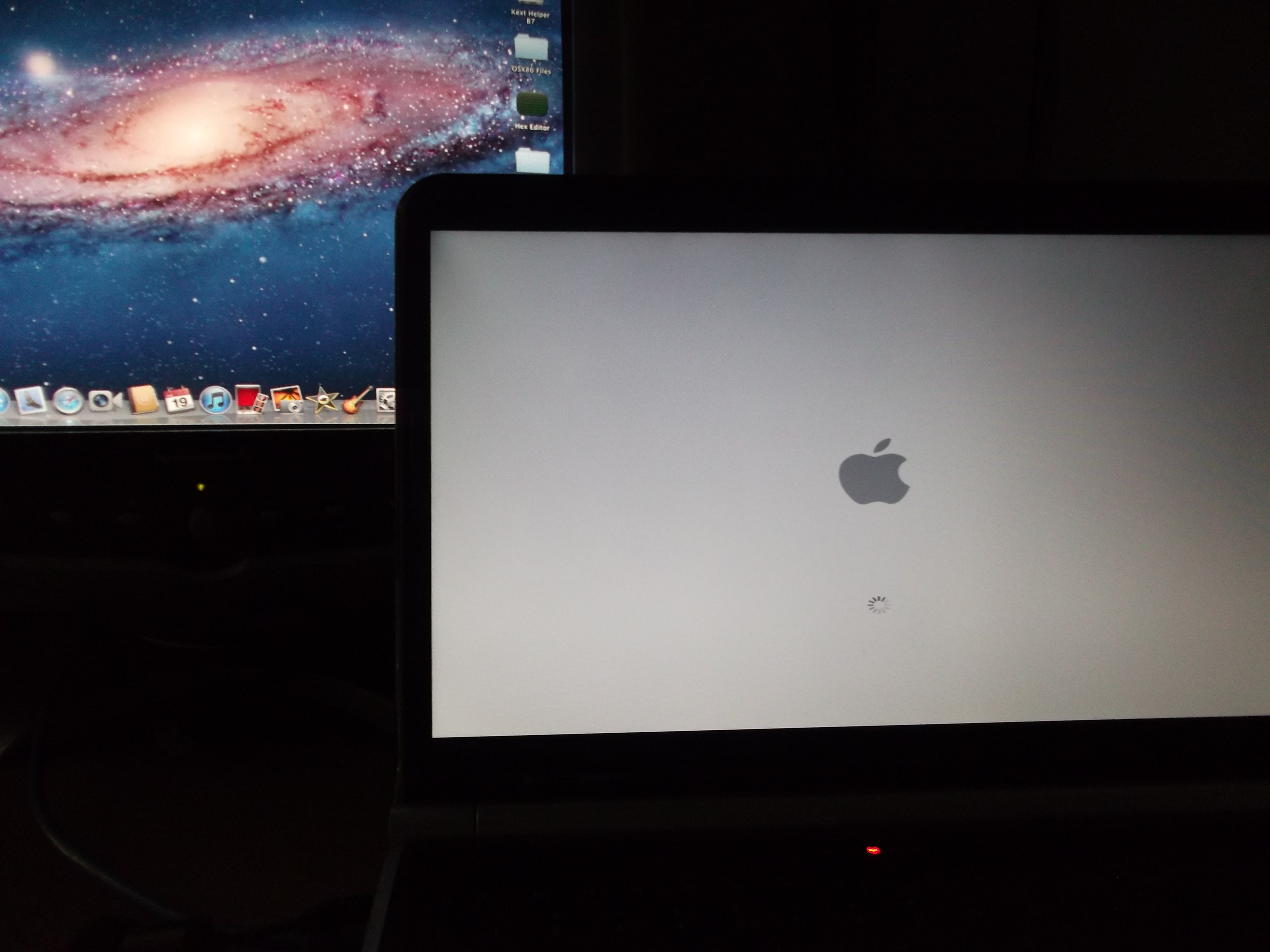

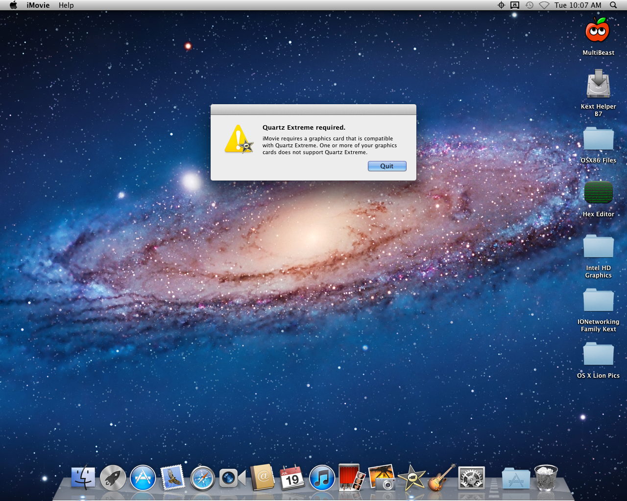

GhostRaider Posted July 19, 2011 Share Posted July 19, 2011 Okay guys well here are some screenshots for those who can't do this. I'm running OS X Lion DP4 on my hackintosh. These screenshots are from Screensharing, since its the only way to see the desktop when having the AppleIntelHDGraphicsFB Kext loaded for now. To start off, the left display is actually my desktop computer. I'm seeing my hackintosh using screensharing and using a VNC client on my desktop. The right display is my laptop. As you can see, I don't get a "black screen" but instead I see the Apple Boot Screen with the wheel spinning forever. These next screenshots are from Screensharing. You can see theres a binoculars icon in the menubar. This means screensharing is active. This is the About This Mac and the System Profiler windows. Nothing special to see. This is the Extensions option in System Profiler. As you can see, AppleIntelHDGraphics Kext and AppleIntelHDGraphicsFB Kext are both loaded. This is the S/L/E folder. All of the Intel HD Graphics kexts are installed. This is where the problems start. There are resolutions available but it seems that OS X Lion DP4 can't detect a display when AppleIntelHDGraphicsFB Kext is loaded. However the only way to load AppleIntelHDGraphicsFB Kext was by using a GFX string. Interesting. This may be a disappointment, but it seems that even with all the Intel HD Graphics kexts installed and loaded, QE cannot be achieved in OS X Lion DP4. It works on Snow Leopard but not in Lion for some odd reason. Please note that this can change in the final version of OS X Lion when it comes out but as of now it doesn't work. ============================================================= Anyways do you guys think that creating our own GFX string specifically designed for Intel HD Graphics (Arrandale) will work? Having a GFX string somehow makes the Intel HD Graphics Frame Buffer load correctly. Also when looking at the NVidia GFX strings, they all have keys that directs which display to use. Link to comment https://www.insanelymac.com/forum/topic/223754-intel-hd-graphics-gma-5700/page/41/#findComment-1717121 Share on other sites More sharing options...

oki270 Posted July 19, 2011 Share Posted July 19, 2011 This may be a disappointment, but it seems that even with all the Intel HD Graphics kexts installed and loaded, QE cannot be achieved in OS X Lion DP4. It works on Snow Leopard but not in Lion for some odd reason. Please note that this can change in the final version of OS X Lion when it comes out but as of now it doesn't work. Hi Ghost, I just want to be sure that I understand correctly what you're saying: -> you tested the same setting in Snow Leopard with GFX string, loaded AppleIntelHD* kexts and you get QE/CI and custom resolution when connected via VNC -> you tested the same setting in Lion with GFX string, loaded AppleIntelHD* kexts and you don't get QE when connected via VNC Is this right? I also noticed few posts back that you mentioned External monitor - in which setting that worked? With or without GFX string and kexts loaded? Lion or Snow Leopard? VGA/HDMI/DVI? I am just trying to sum your current results so I wouldn't reinvent the wheel.... :-) BR, Oki P.S. Can you post your GFX string? P.S.S. Which chipset you have on your laptop? Link to comment https://www.insanelymac.com/forum/topic/223754-intel-hd-graphics-gma-5700/page/41/#findComment-1717182 Share on other sites More sharing options...
