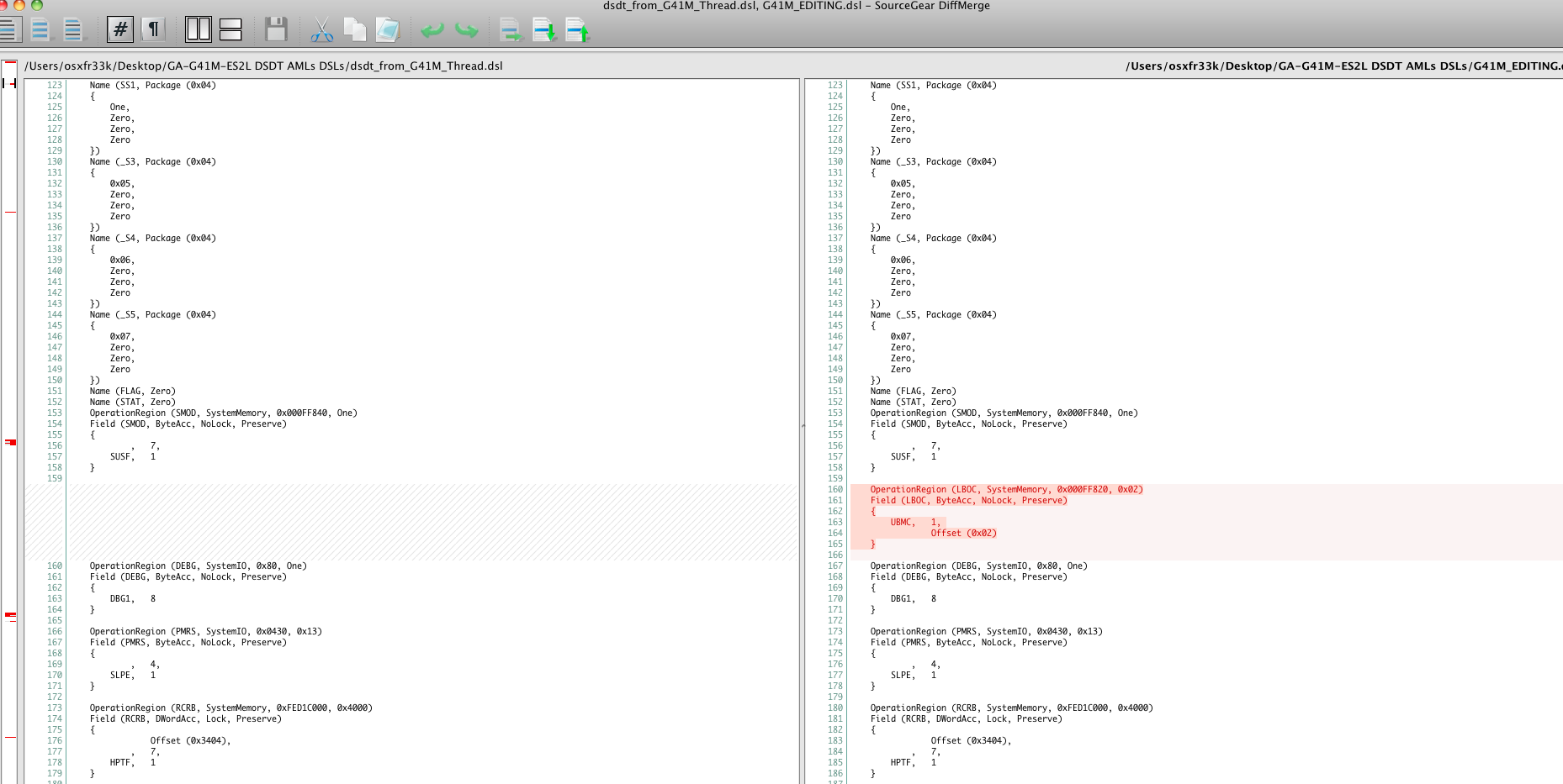

A little help with some script differences for Mobo Gigabyte GA-G41M-ES2L. I have two DSDTs but they are suppose to be from the same motherboard. There is some slight chance that his has a difference Bios in in that regard it could change things?
The main difference is 3 sections, one is the OperationRegion just after the Header and processor section, the HPET and EHC1 sections.
Operation Region Difference:
My DSDT:
    Name (FLAG, Zero)
   Name (STAT, Zero)
   OperationRegion (SMOD, SystemMemory, 0x000FF840, One)
   Field (SMOD, ByteAcc, NoLock, Preserve)
           ,   7,
       SUSF,   1
   OperationRegion (LBOC, SystemMemory, 0x000FF820, 0x02)
   Field (LBOC, ByteAcc, NoLock, Preserve)
       UBMC,   1,
               Offset (0x02)
   OperationRegion (DEBG, SystemIO, 0x80, One)
   Field (DEBG, ByteAcc, NoLock, Preserve)
       DBG1,   8
   OperationRegion (PMRS, SystemIO, 0x0430, 0x13)
   Field (PMRS, ByteAcc, NoLock, Preserve)
           ,   4,
       SLPE,   1
   OperationRegion (RCRB, SystemMemory, 0xFED1C000, 0x4000)
   Field (RCRB, DWordAcc, Lock, Preserve)
               Offset (0x3404),
           ,   7,
       HPTF,   1

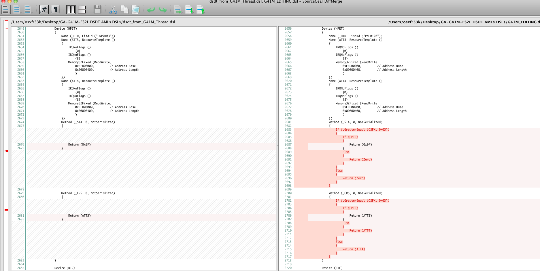

My DSDT HPET Script:
                Device (HPET)
                   Name (_HID, EisaId ("PNP0103"))
                   Name (ATT3, ResourceTemplate ()
                       IRQNoFlags ()
                           {0}
                       IRQNoFlags ()
                           {8}
                       Memory32Fixed (ReadWrite,
                           0xFED00000,         // Address Base
                           0x00000400,         // Address Length
                   Name (ATT4, ResourceTemplate ()
                       IRQNoFlags ()
                           {0}
                       IRQNoFlags ()
                           {8}
                   Method (_STA, 0, NotSerialized)
                       If (LGreaterEqual (OSFX, 0x03))
                           If (HPTF)
                               Return (0x0F)
                           Else
                               Return (Zero)
                       Else
                           Return (Zero)
                   Method (_CRS, 0, NotSerialized)
                           If (HPTF)
                               Return (ATT3)
                           Else
                               Return (ATT4)
                       Else
                           Return (ATT4)
His HPET Script:
                Device (HPET)
                       IRQNoFlags ()
                           {0}
                       IRQNoFlags ()
                           {8}
                       IRQNoFlags ()
                           {0}
                       IRQNoFlags ()
                           {8}
                       Return (0x0F)
                       Return (ATT3)
Notice the IRQ's are scripted twice for HPET?

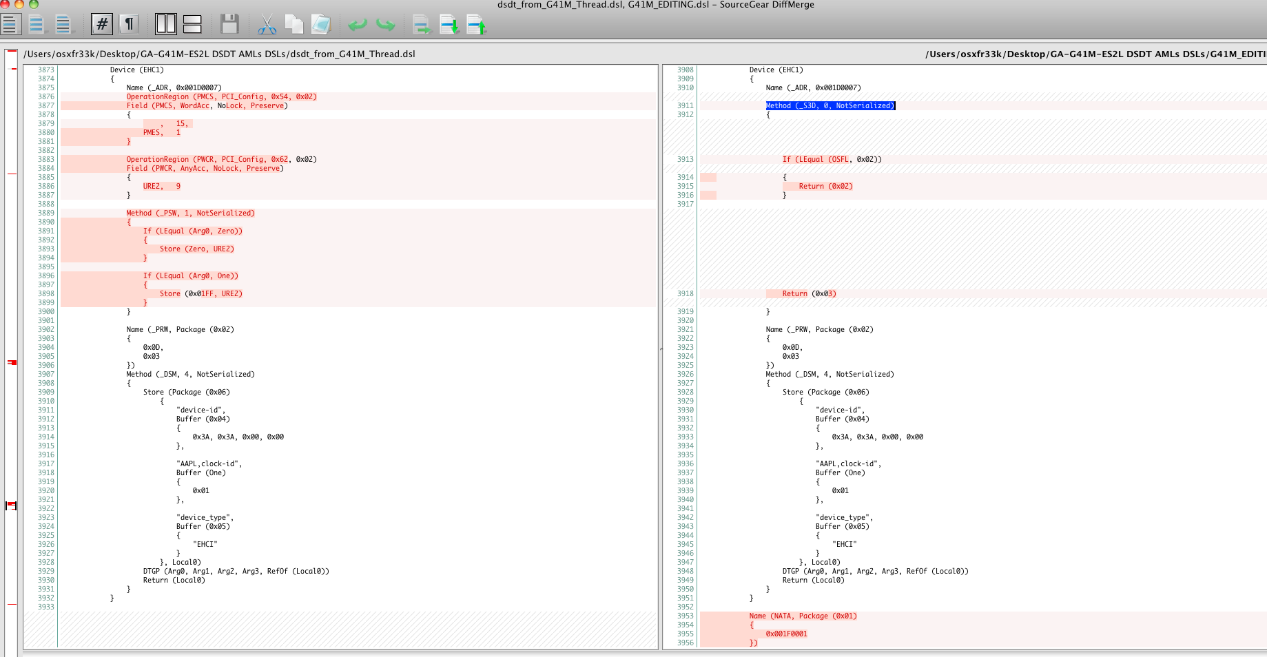

His EHC1:
            Device (EHC1)
               Name (_ADR, 0x001D0007)
               OperationRegion (PMCS, PCI_Config, 0x54, 0x02)
               Field (PMCS, WordAcc, NoLock, Preserve)
                       ,   15,
                   PMES,   1
               OperationRegion (PWCR, PCI_Config, 0x62, 0x02)
               Field (PWCR, AnyAcc, NoLock, Preserve)
                   URE2,   9
               Method (_PSW, 1, NotSerialized)
                   If (LEqual (Arg0, Zero))
                       Store (Zero, URE2)
                   If (LEqual (Arg0, One))
                       Store (0x01FF, URE2)
               Name (_PRW, Package (0x02)
                   0x0D,
                   0x03
                   Store (Package (0x06)
                           "device-id",
                           Buffer (0x04)
                               0x3A, 0x3A, 0x00, 0x00
                           "AAPL,clock-id",
                           Buffer (One)
                               0x01
                           "device_type",
                           Buffer (0x05)
                               "EHCI"
                       }, Local0)
                   Return (Local0)
My EHC1:
            Device (EHC1)
               Method (_S3D, 0, NotSerialized)
                   If (LEqual (OSFL, 0x02))
                       Return (0x02)
                   Return (0x03)
                   0x0D,
                   0x03
                           "device-id",
                           Buffer (0x04)
                           "AAPL,clock-id",
                           Buffer (One)
                               0x01
                           "device_type",
                           Buffer (0x05)
                               "EHCI"
                       }, Local0)
                   Return (Local0)
           Name (NATA, Package (0x01)
               0x001F0001
As you can also see below this part is missing from his:
               0x001F0001
Mine is missing the operatingRegion sections and method _PSW. His is missing Method (_S3D, 0, NotSerialized)
Here is a better way of viewing it with this neat program I have. A GUI diff.
I don't understand your question.
You are comparing two modified DSDTs, they are probably not originals. For example, in HPET, there's no need to have ATT3 and ATT4 if they are identical (usually one has IRQs and other doesn't) or if one is never used.
@oSxFr33k,
If both DSDT come from similar motherboard, check whether both motherboard have same BIOS version or not. It is not possible if both motherboard have same BIOS version but have different DSDT. I bet both motherboard have different BIOS version.
@oldnapalm and @kizwan,
I am waiting for the user to get back to me.
I had to use his HPET script. The extra script in my HPET, the ATT3 and ATT4 caused a kernel panic. It said that CPU2 had no HPET assigned to it. The ATT3 and ATT4 was not added. That is a clean DSDT extract using Ubuntu Live CD.
I just added the 2nd IRQ section to make it look like his HPET script is all. The kernel panic is gone now that I removed the extra script.
So basically what I am asking is leave my original operating region alone, from the above examples and don't remove the extra section I have in my original DSDT extract from Ubuntu Live CD? Same question with EHC1, just add the method section and leave everything else alone?
