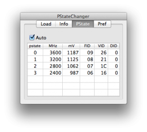

abouyas Posted July 6, 2014 Share Posted July 6, 2014 Please can any one help me to add this value to my dsdt. I have tried many times without success. I found this value for my CPU Q6600 with PStateChanger. Scope (_PR) { Processor (CPU1, 0x01, 0x00000410, 0x06) { Name (_CST, Package (0x04) { 0x02, Package (0x04) { ResourceTemplate () { Register (FFixedHW, 0x00, // Bit Width 0x00, // Bit Offset 0x0000000000000000, // Address ,) }, One, 0x14, 0x03E8 }, Package (0x04) { ResourceTemplate () { Register (SystemIO, 0x08, // Bit Width 0x00, // Bit Offset 0x0000000000000414, // Address ,) }, 0x02, 0x28, 0x02EE }, Package (0x04) { ResourceTemplate () { Register (SystemIO, 0x08, // Bit Width 0x00, // Bit Offset 0x0000000000000415, // Address ,) }, 0x03, 0x3C, 0x01F4 } }) Name (_PCT, Package (0x02) { ResourceTemplate () { Register (FFixedHW, 0x00, // Bit Width 0x00, // Bit Offset 0x0000000000000000, // Address ,) }, ResourceTemplate () { Register (FFixedHW, 0x00, // Bit Width 0x00, // Bit Offset 0x0000000000000000, // Address ,) } }) Name (_PSS, Package (0x05) { Package (0x06) { 0x0A6B, 0x00015BA8, 0xA0, 0x0A, 0x0A27, 0x0A27 }, Package (0x06) { 0x0960, 0x00013498, 0xA0, 0x0A, 0x0924, 0x0924 }, Package (0x06) { 0x0855, 0x00011558, 0xA0, 0x0A, 0x0821, 0x0821 }, Package (0x06) { 0x074B, 0xF618, 0xA0, 0x0A, 0x071E, 0x071E }, Package (0x06) { 0x0640, 0xD6D8, 0xA0, 0x0A, 0x061B, 0x061B } }) Method (_PPC, 0, NotSerialized) { Return (Zero) } } dsdt.dsl.zip Link to comment https://www.insanelymac.com/forum/topic/223205-dsdt-editor-and-patcher/page/40/#findComment-2037208 Share on other sites More sharing options...
abouyas Posted July 6, 2014 Share Posted July 6, 2014 Try this, Scope (_PR.CPU0) { Method (_PSS, 0, NotSerialized) { Return (Package (0x04) { Package (0x06) { 0x0BB5, Zero, 0x0A, 0x0A, 0x0929, Zero }, Package (0x06) { 0x0A68, Zero, 0x0A, 0x0A, 0x0929, One }, Package (0x06) { 0x091B, Zero, 0x0A, 0x0A, 0x0929, 0x02 }, Package (0x06) { 0x07CE, Zero, 0x0A, 0x0A, 0x0929, 0x03 } }) } Method (_PSD, 0, NotSerialized) { Return (Package (0x05) { 0x05, Zero, Zero, 0xFC, 0x02 }) } Method (_CST, 0, NotSerialized) { Return (Package (0x04) { 0x03, Package (0x04) { ResourceTemplate () { Register (FFixedHW, 0x01, // Bit Width 0x02, // Bit Offset 0x0000000000000000, // Address ,) }, One, One, 0x03E8 }, Package (0x04) { ResourceTemplate () { Register (SystemIO, 0x08, // Bit Width 0x00, // Bit Offset 0x0000000000000414, // Address ,) }, 0x02, One, 0x01F4 }, Package (0x04) { ResourceTemplate () { Register (SystemIO, 0x08, // Bit Width 0x00, // Bit Offset 0x0000000000000415, // Address ,) }, 0x03, One, 0xFA } }) } } Scope (_PR.CPU1) { Alias (^CPU0._PSS, _PSS) Alias (^CPU0._PSD, _PSD) Alias (^CPU0._CST, _CST) } Scope (_PR.CPU2) { Alias (^CPU0._PSS, _PSS) Alias (^CPU0._PSD, _PSD) Alias (^CPU0._CST, _CST) } Scope (_PR.CPU3) { Alias (^CPU0._PSS, _PSS) Alias (^CPU0._PSD, _PSD) Alias (^CPU0._CST, _CST) } Place it under Scope (_PR) { Processor (CPU0, 0x00, 0x00000410, 0x06) {} Processor (CPU1, 0x01, 0x00000410, 0x06) {} Processor (CPU2, 0x00, 0x00000410, 0x06) {} Processor (CPU3, 0x00, 0x00000410, 0x06) {} } Please can you help me to fix my dsdt because i try many time without success. Thanks Link to comment https://www.insanelymac.com/forum/topic/223205-dsdt-editor-and-patcher/page/40/#findComment-2037328 Share on other sites More sharing options...
