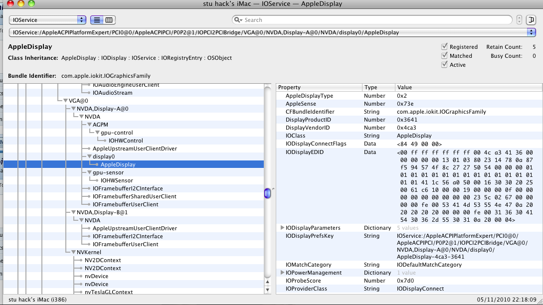

surfstu Posted November 5, 2010 Share Posted November 5, 2010 @kizwan here is what i see in appledisplay..... cheers stuart Link to comment https://www.insanelymac.com/forum/topic/223205-dsdt-editor-and-patcher/page/21/#findComment-1577340 Share on other sites More sharing options...

kizwan Posted November 6, 2010 Share Posted November 6, 2010 @oldnapalm thanks for _DSM method, i applied this as a patch, but when i compiled it i got 15 errors, mostly reserved name, so i fixed errors and had 1 error.... name already exists in scope (_DSM) Try comparing the IODisplayEDID value with EDID value in windows. You can use an application called MonInfo in windows (the Raw Data is the EDID value). However, I recommend you to try the _DSM control method first before trying anything else. It looks like there is already _DSM control method exist in _SB.PCI0.P0P2.VGA. Locate the original _DSM control method & remove it. So that it will only have one _DSM control method (the one oldnapalm gave to you earlier). UPDATE: You need to remove this:- Scope (_SB.PCI0.P0P2.VGA) { Method (_DSM, 4, NotSerialized) { Store ("----- DGPU _DSM --------", Debug) P8XH (Zero, 0x10) If (CMPB (Arg0, Buffer (0x10) { /* 0000 */ 0xF8, 0xD8, 0x86, 0xA4, 0xDA, 0x0B, 0x1B, 0x47, /* 0008 */ 0xA7, 0x2B, 0x60, 0x42, 0xA6, 0xB5, 0xBE, 0xE0 })) { Return (NVOP (Arg0, Arg1, Arg2, Arg3)) } Return (Zero) } } UPDATE 2: Try this modified DSDT - included CMOS Reset Fix, Nvidia injection & other common fix. Search for // start to see the fix I add to your DSDT. Boot without GraphicsEnabler. http://www.mediafire.com/?drc6d7dayzdfi7z Link to comment https://www.insanelymac.com/forum/topic/223205-dsdt-editor-and-patcher/page/21/#findComment-1577495 Share on other sites More sharing options...
